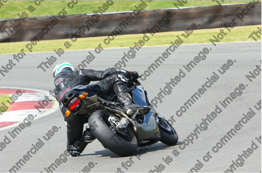

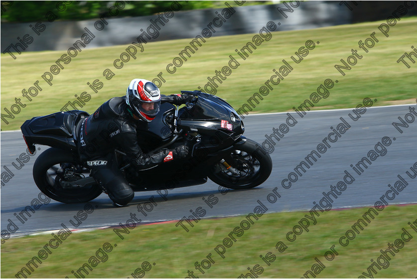

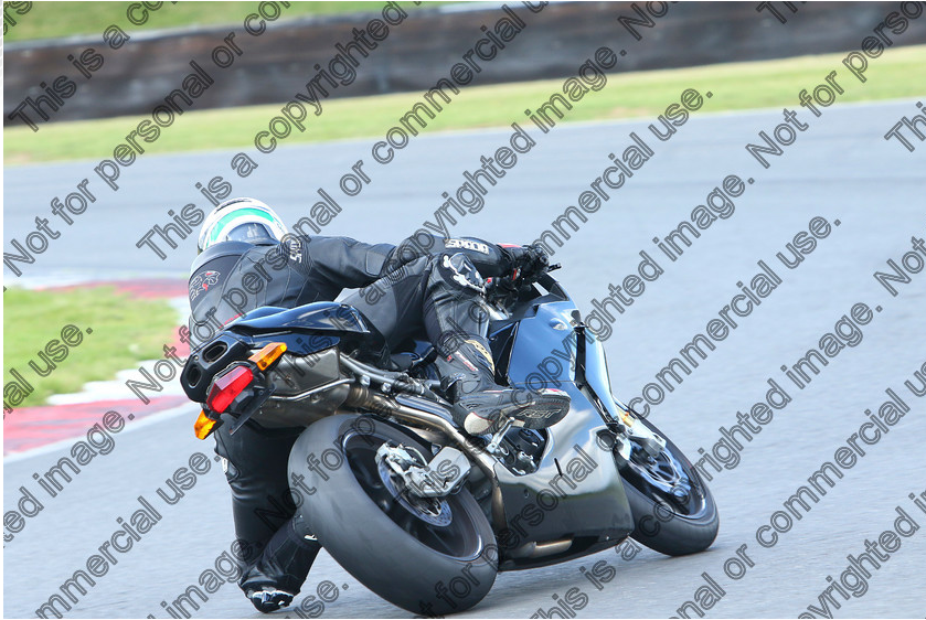

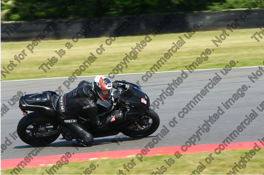

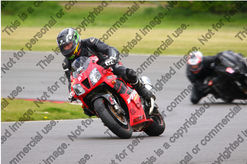

  3. Track day pics from yesterday, 1st is under breaking for Agostini (i think). I'm kinda off to the side but I think i'm sat too high.
    several like this, i could have sworn I was more off......I blame the camera man.......
    Only one where you see me from the front i'm blured in the background. Bloody camera man......... 8.PNG
  4. That cameraman is rubbish, and he's written all over your pictures.

  6. That's some extreme hanging off in the last pic... looks like you're gonna jump off the bike..

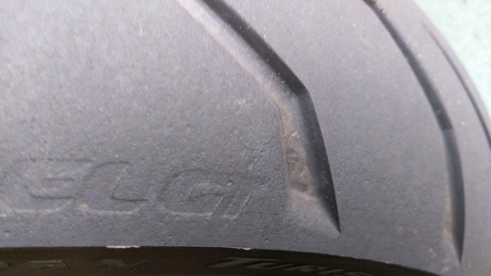

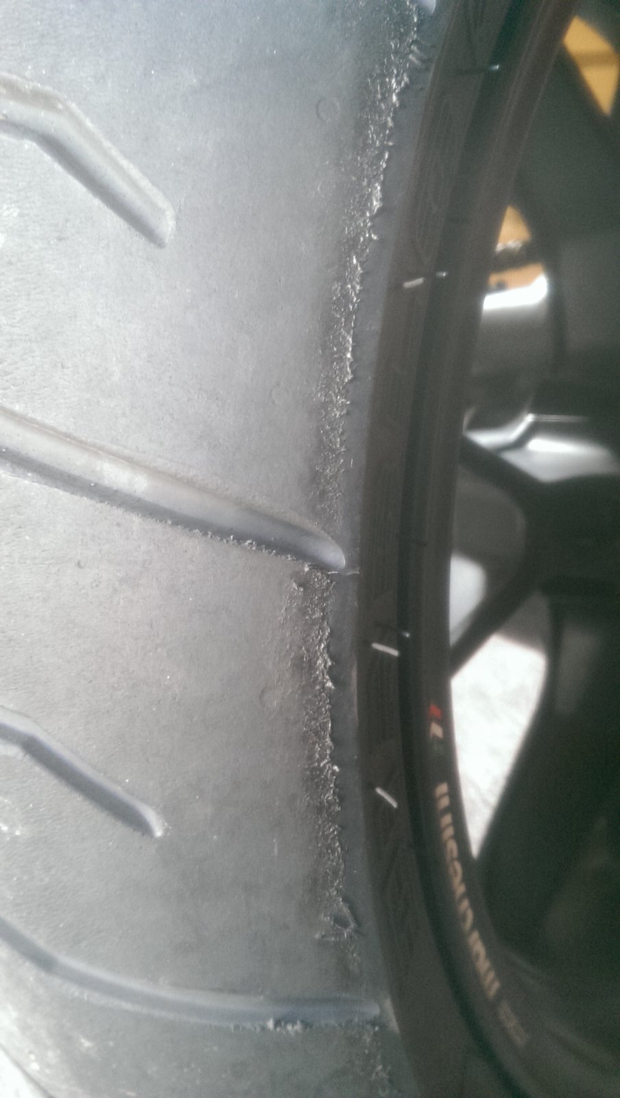

    Been some reference to chicken strips, see picture of my Angel gt. Its not here for bragging rights, its not fried or anything, I just get the feeling that a lot of this is to do with tyre profile. seriously feel like the KTM has a lot further to lean (on the right tyre!). Sure if hanging off more might use less tyre but this is surely down to the profile/shape..
  12. Sports profiles definitely allow greater angles of lean than sports touring profiles.
    The difference between the two is like the difference between the blunt and sharp end of an egg. It stands to reason that if you were to wrap the same width of tread around those two profiles, the sharp end will lean further from the vertical than the blunt end before it reaches the edge of the tread.
    I changed from Roadsmart IIs to M7RRs on my SMT precisely because I was running out of tread under normal riding. The quality of the chassis and the amount of ground clearance available easily outstripped the profile capability of the tyres but being an upright with long travel suspension hanging off to increase cornering speed without increasing lean wasn't so easy for an average Joe like me. Fortunately being based on the supermoto format the SMT runs conventional sports-sized rime. I have the same trouble now with the 1190 Adventure which has replaced the SMT but adventure-bike rim sizes restricts tyre choice. Luckily the 1190's suspension is more sophisticated and the riding position more roomy than the SMT's and its generally a more stable platform so I'm finding I can use body positioning more effectively. And that underlines a crucial point: body positioning isn't the same as knee down. Yes you need correct body position to get your knee down but you absolutely do not have to point your knee at the tarmac to reap the benefits of body positioning. If you can master hanging off, regardless of whether your knee is poking out like the handle on a teapot or remains firmly inboard, you will get a much faster cornering speed and more grip from the same degree of lean than you would if you remained perpendicular in the saddle.
