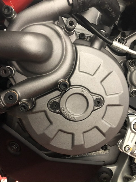

  2. Well due to this thread, just been out to the one month old 1260 and removed the cover, foam/ sponge very damp, what a piss poor design, cover back on after a coat of ACF 50 minus the sponge. Thanks for the heads up.
  3. Yeah it is a bit of a cor blimey init o_O

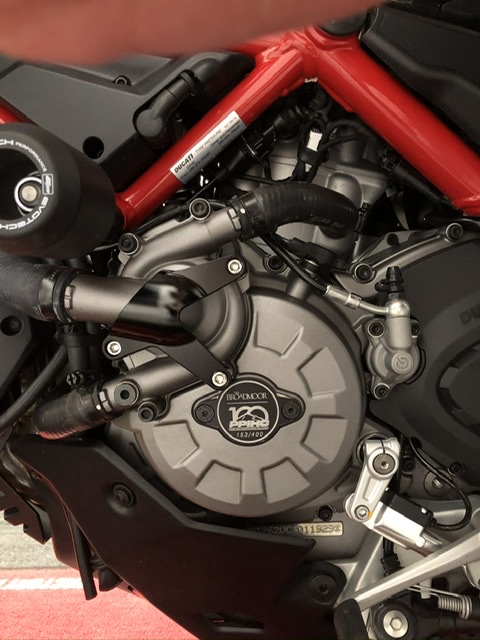

    so this was mine at 3mths old and 12pp miles. No issue from dealer. Swapped immediately. Binned that plastic rubbish that was over the top!
    But I found a better cover

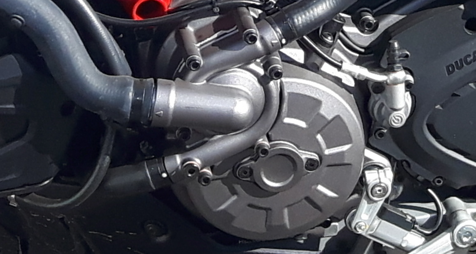

  8. What plastic cover?
    Mine looks like this and it does not feel like plastic:
    Screenshot from 2020-06-29 16:14:25.png

  9. If that's a 1260 it should have one.
  10. It's a 1260 Pikes Peak right off the showroom floor.
    Edit:
    I just saw what you mean in post #15. Mine never had one of those covers.
    In fact, curiosity made me look it up and none of the bikes seen so far in North-America has it.
    That plastic cover must be a European or Regional requirement for additional noise suppression.
    Given the potential damage it causes, I'd trash that thing before the bike leaves the dealer's premises.

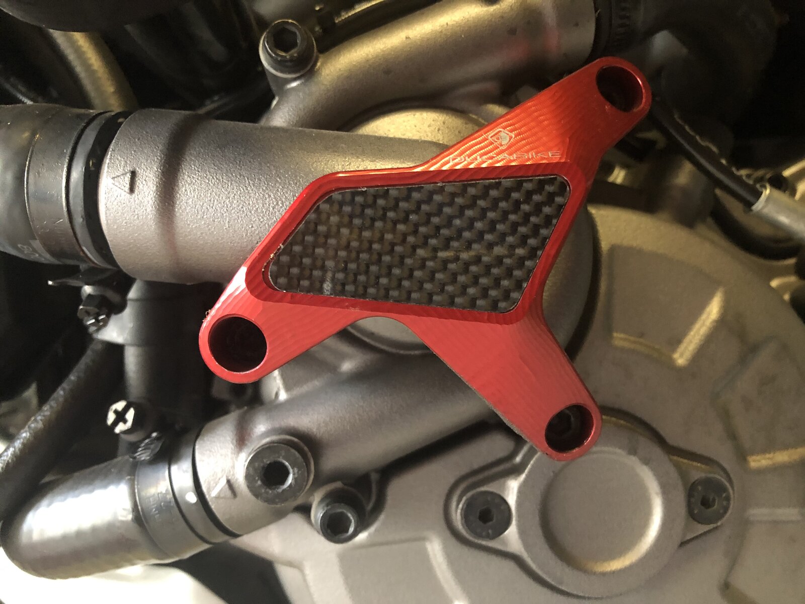

  11. This is the one you need to protect the water pump carbuncle.... Multistrada 1260 Ducabike water pump protector.JPG
  12. What’s it to protect against? Dropping (I don’t think that would hold up)?
  13. The original is just to muffle noise for the noise test...

  14. There's probably a good reason, but why didn't Ducati tuck it out of the way like on the 1260 Diavel?
  15. Limited protection I agree, but whilst it might not do entirely, I have little doubt it would deflect impact and in a slide, it would limit abrasion, potentially (hopefully) stopping a fracture of the water pump cover. And it's certainly more farkley than the horrible thing that was on there!
    Anyway, as I have little or no intention of dropping the bike, it becomes purely academic and aesthetic to boot.......:)

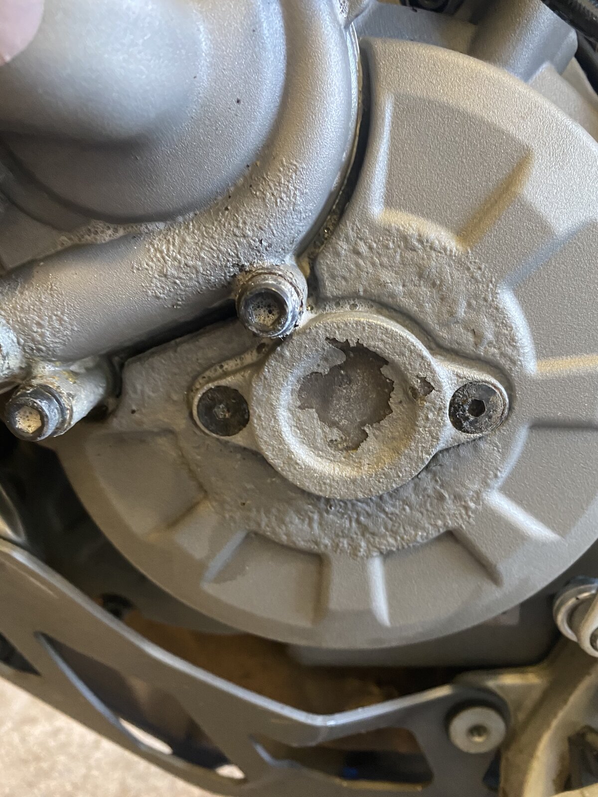

    Is it definitely a warranty job?
    18 months old and 15,000 but not in the winter and it gets cleaned after every ride and Scott protection[/ATTACH]
  17. Yup certainly should be.
