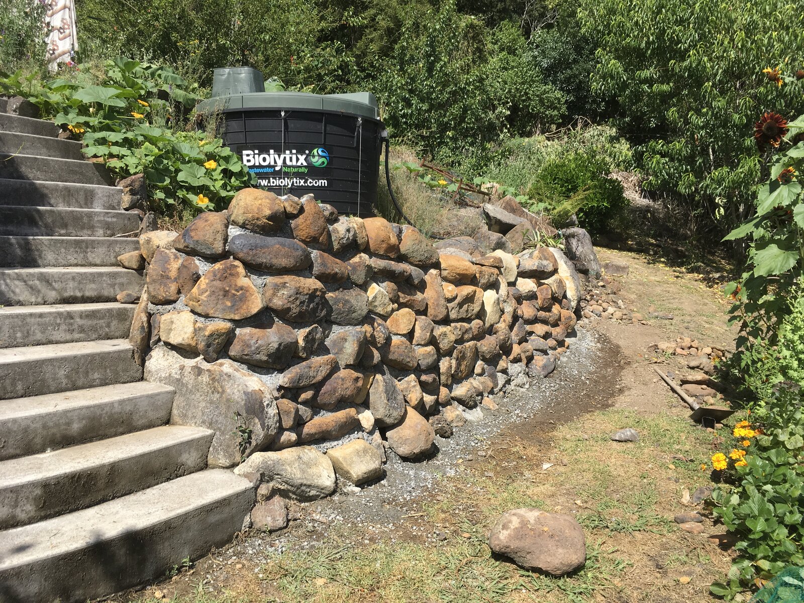

  12. IMG_1146.JPG Here's the wall I am building, not sure what I am trying to keep out but hoping that the wife will chip in costwise! If not I will put the office of conjugal unpleasantness on hiatus!

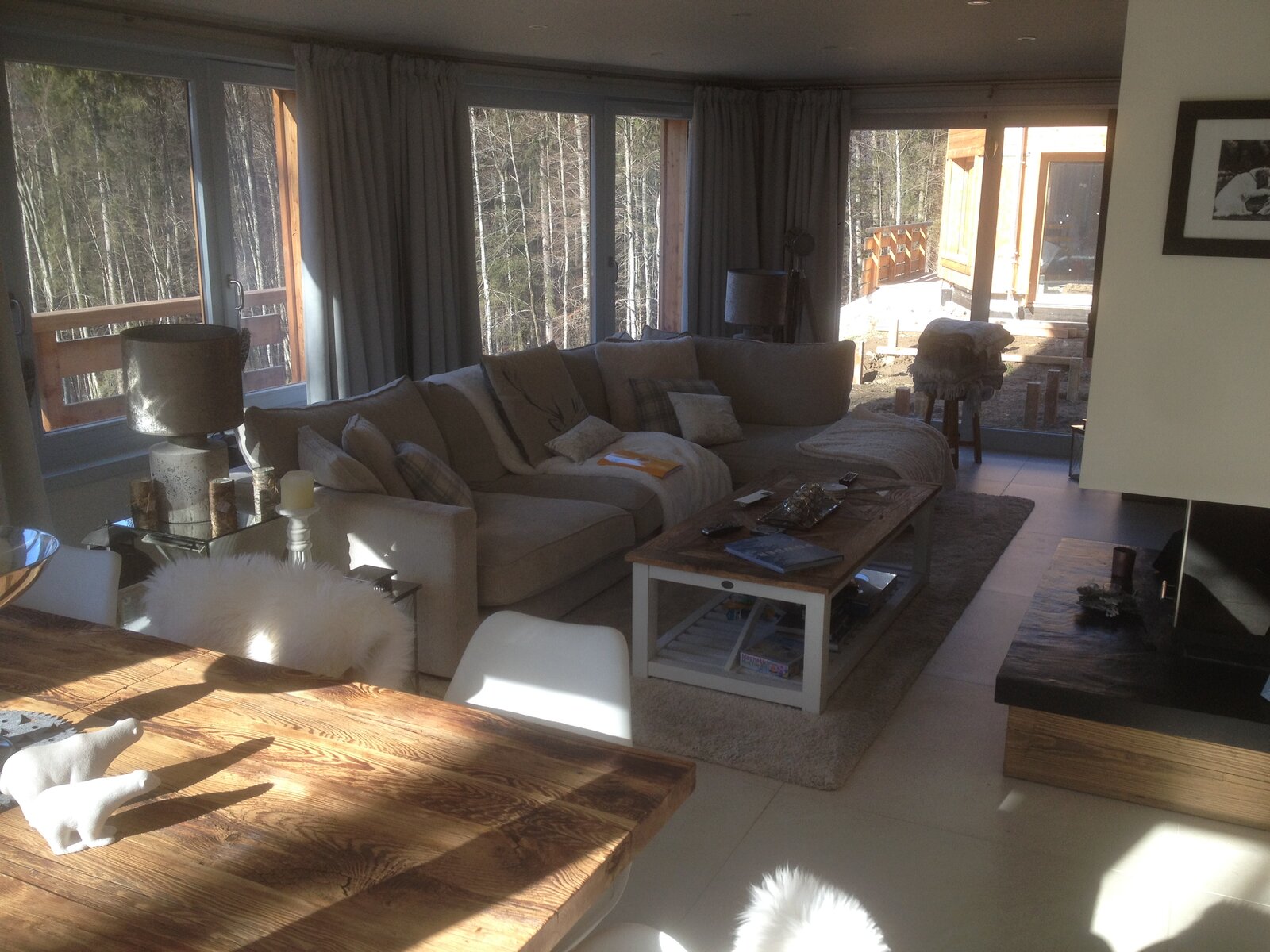

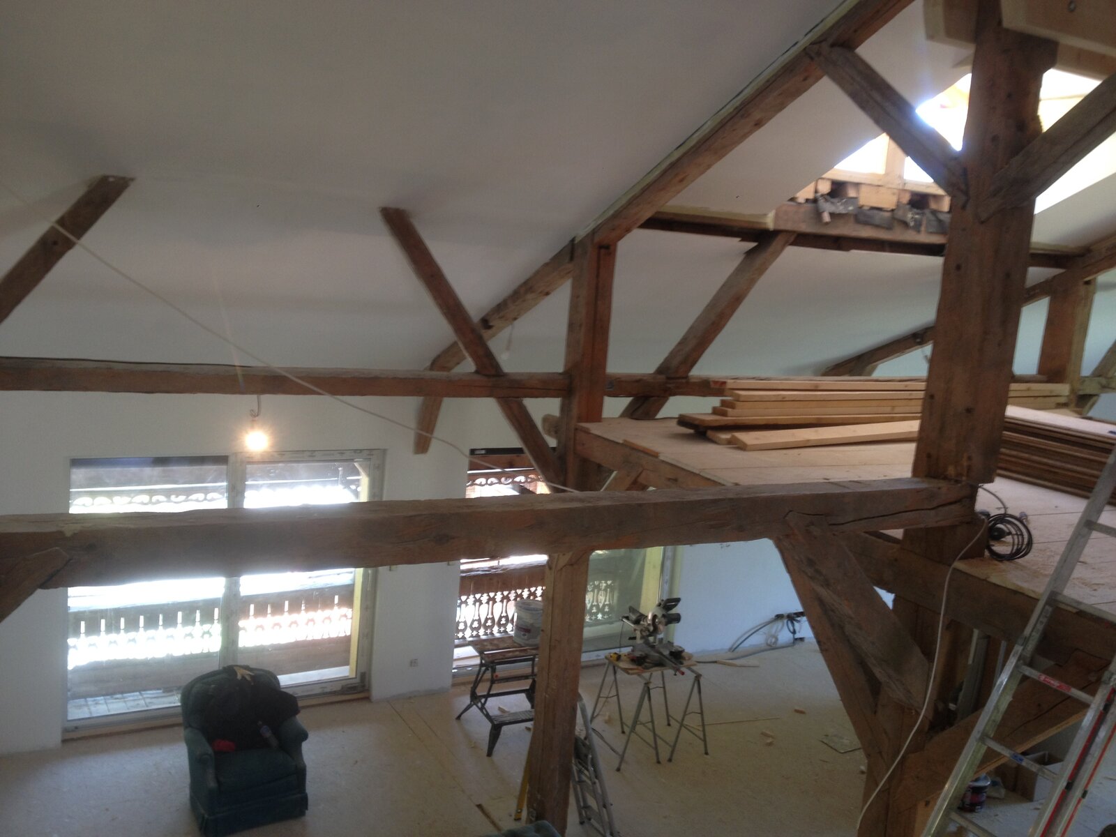

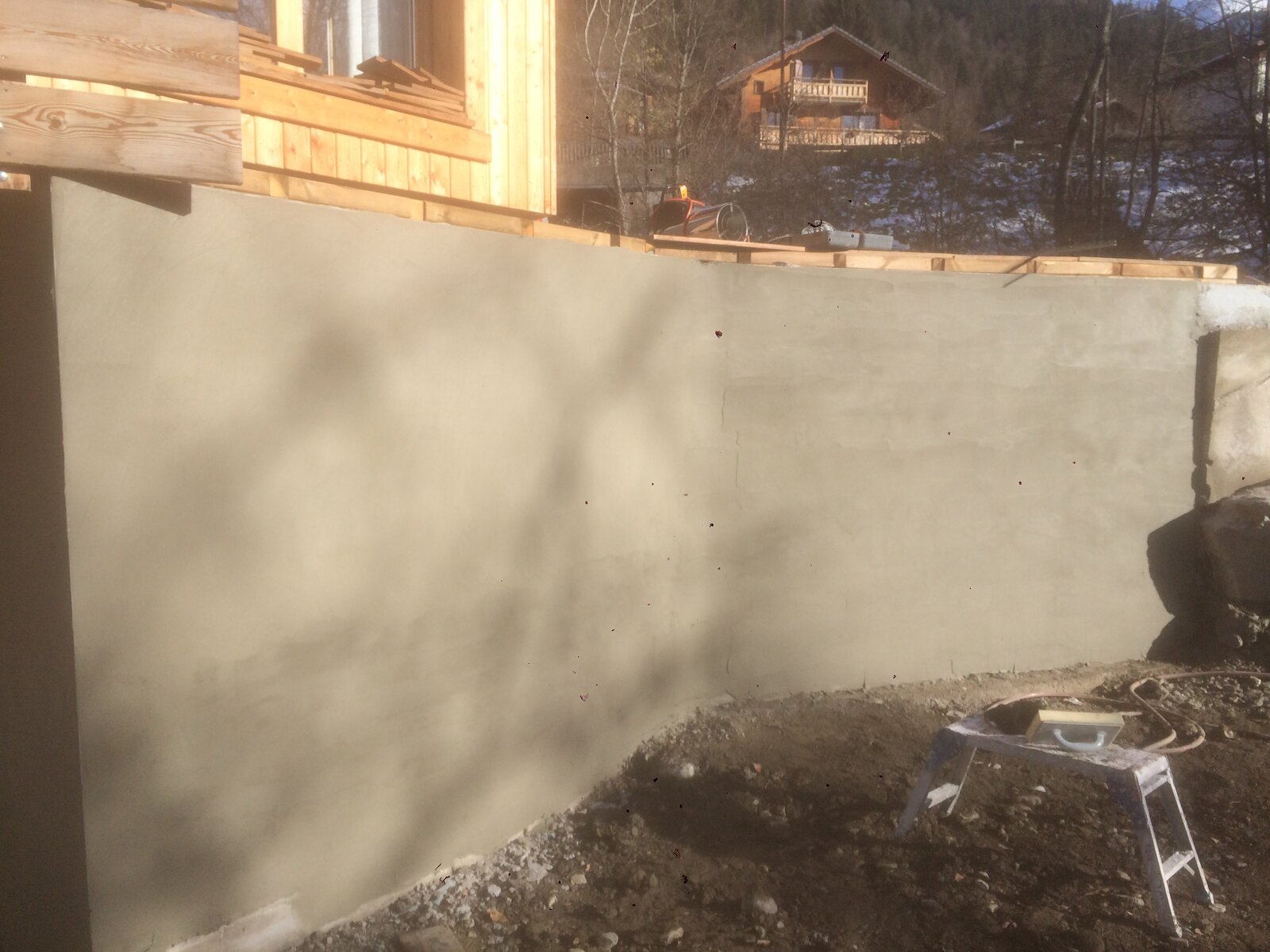

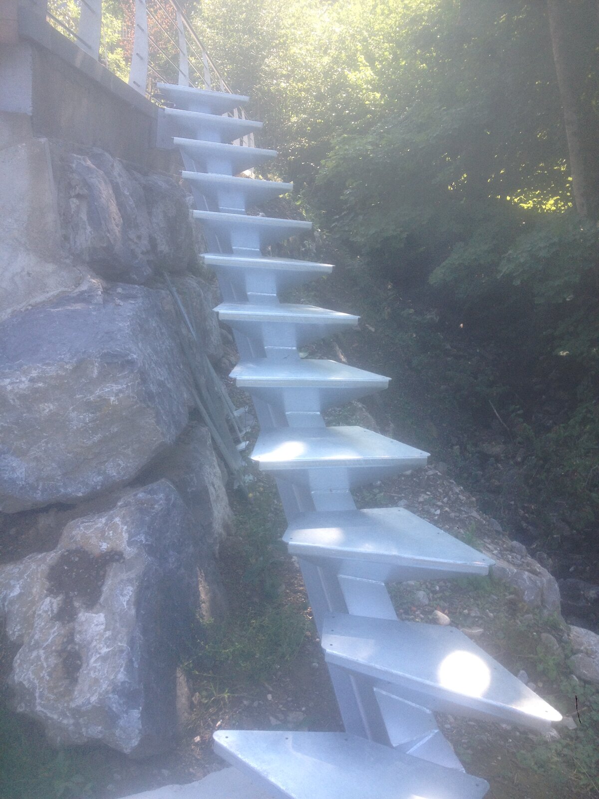

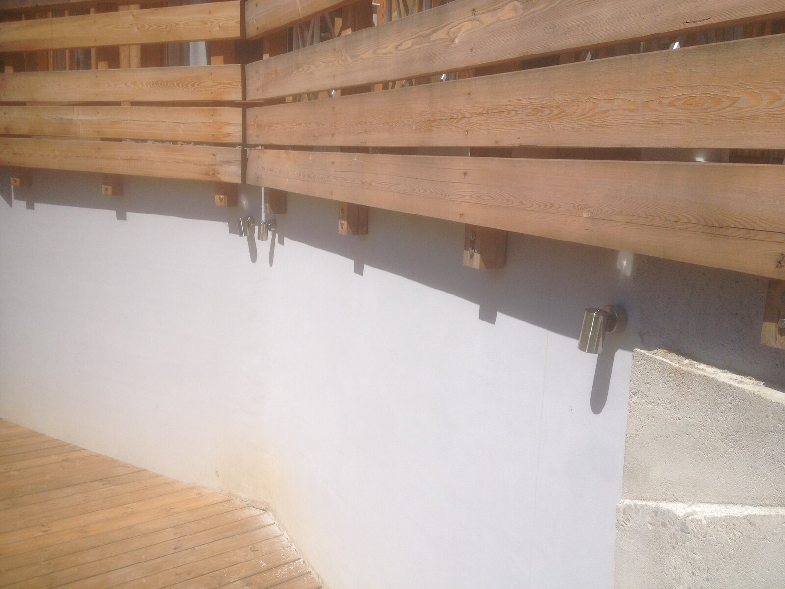

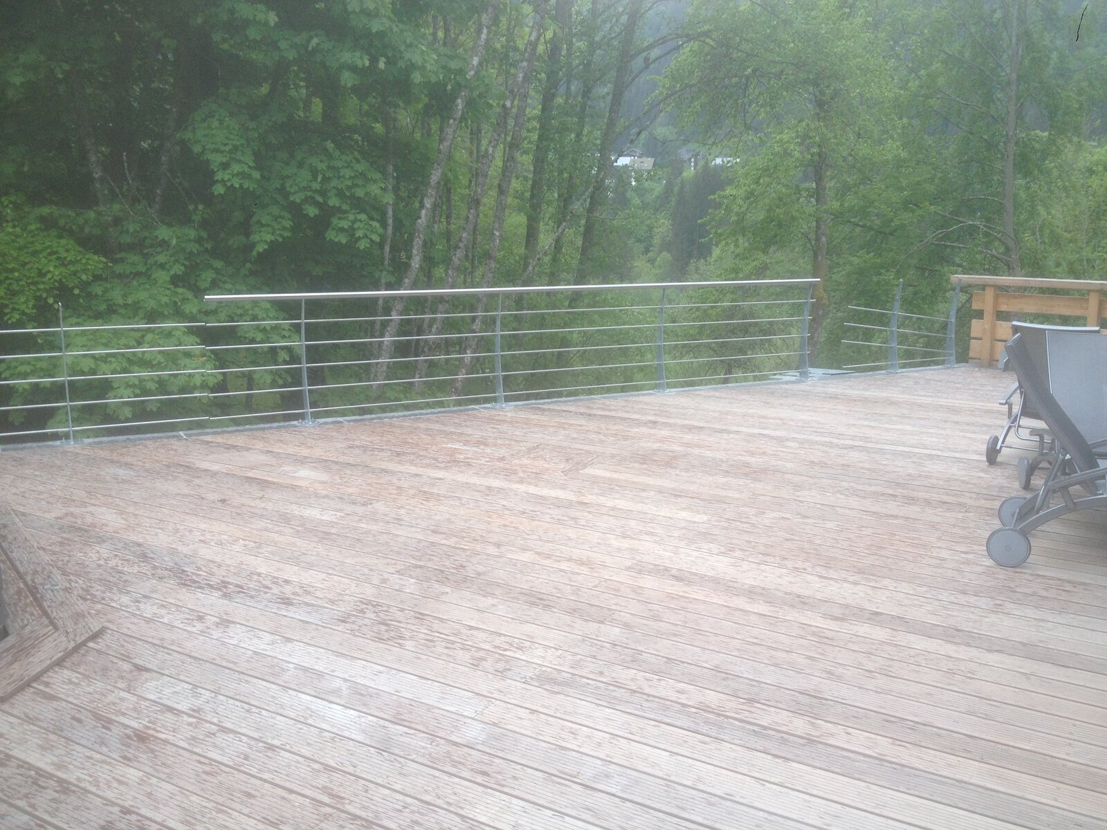

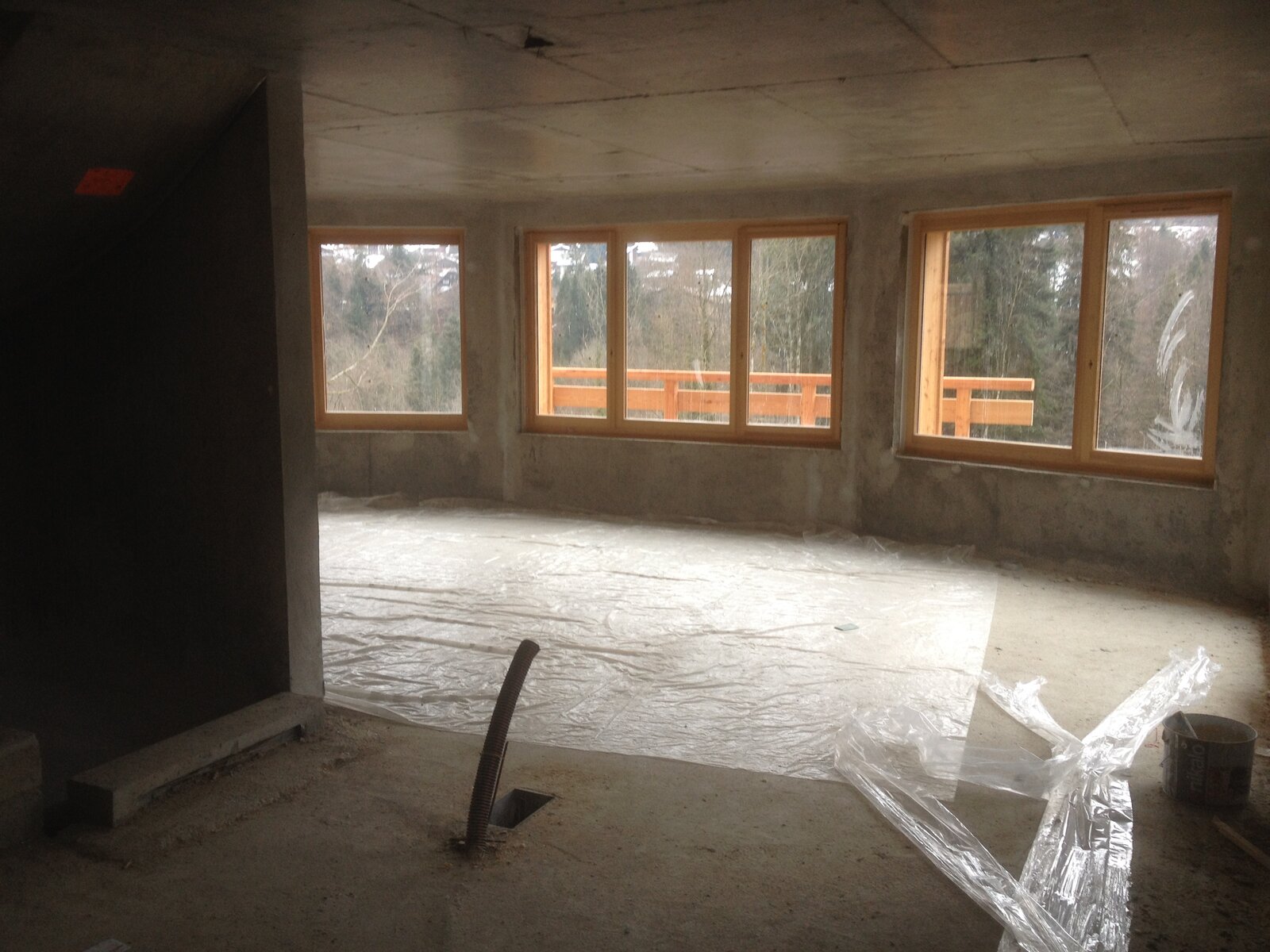

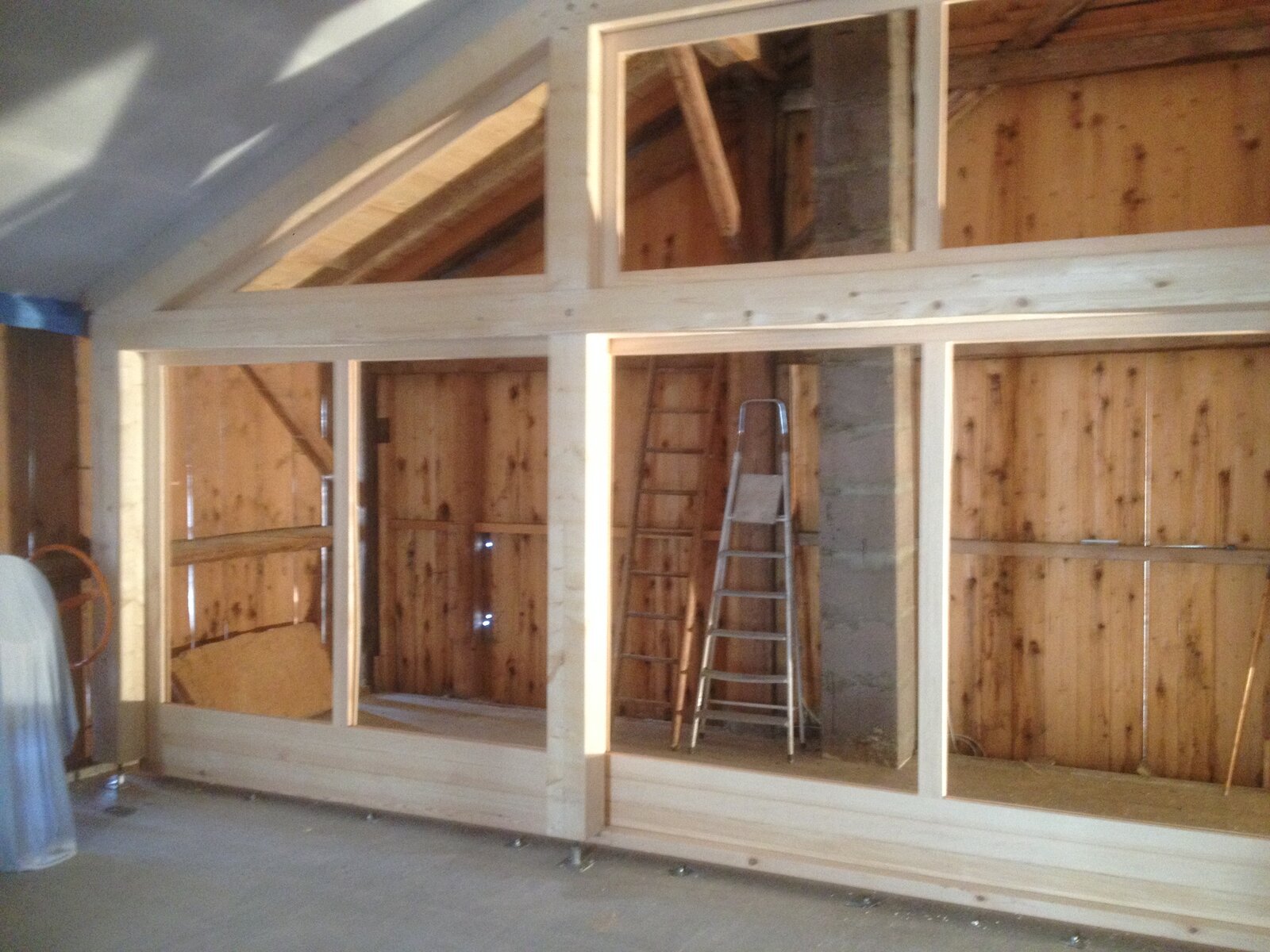

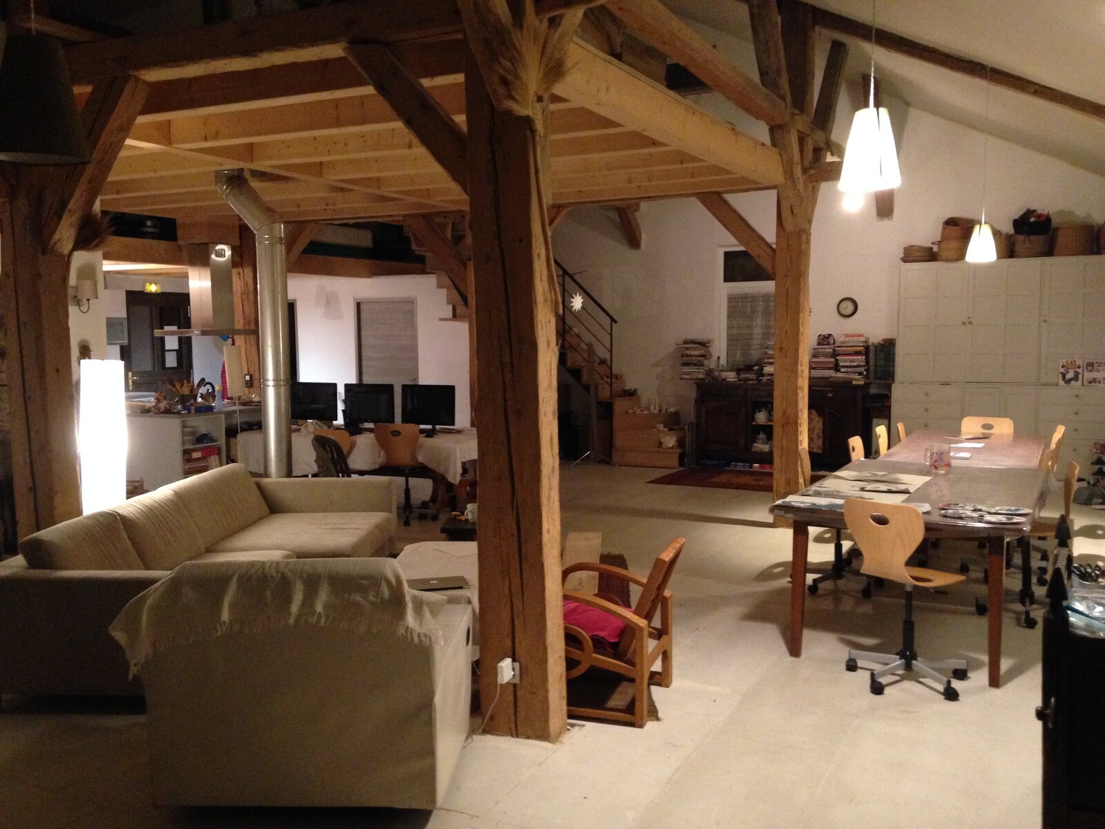

  13. This (what you are asking) is essentially what I do to earn my keep and these are a few before and afters of the last twelve months work, including mine and the gf's place; all aspects of construction in re-inforced concrete, blockwork, steel, timber etc. From design and planning right through to final fix and client handover. Unfortunately I can't help you as my business is based in the French/Swiss alps and my minimum project price is well into six figures. Whatever you do though, make sure you do get a structural engineer involved, even if it is only for the benefit of the paperwork. I have seen too many train wrecks to chance it without adequate insurance. Luckily none of my jobs yet though!
    I would think 20k would cover your wall and I do have a sub contractor based in Sheffield who I bring over three or four times a year if that would be of any use?
