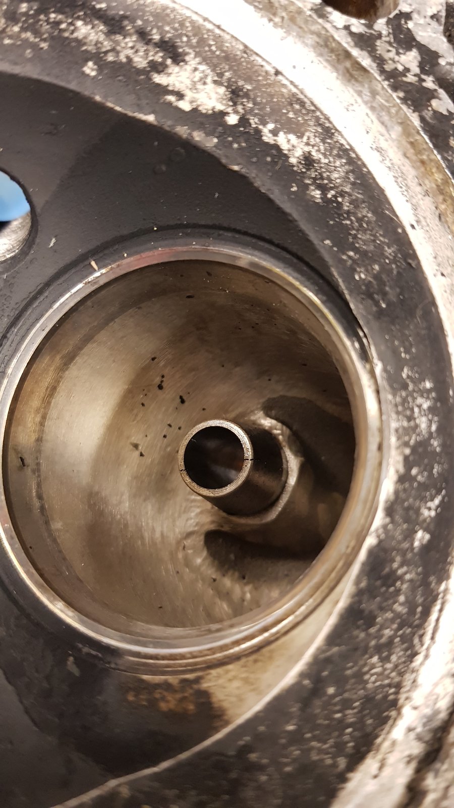

  1. On my current build, Ive just discovered tjis on the head whilst getting ready for blasting. Got a new one coming, gonna probably get it properly fitted, as the seat may need cutting. 20181229_212533.jpg

  4. no, excessive seat and valve wear allowing the valve travel to reach the taper of the valve head to enter the guide and create the split ?

  6. Maybe, the history of the engine is unknown by me. Its carby heads on injection barrels and bottom end, so theres gonna be more wear up top. Bottom end is in good condition
