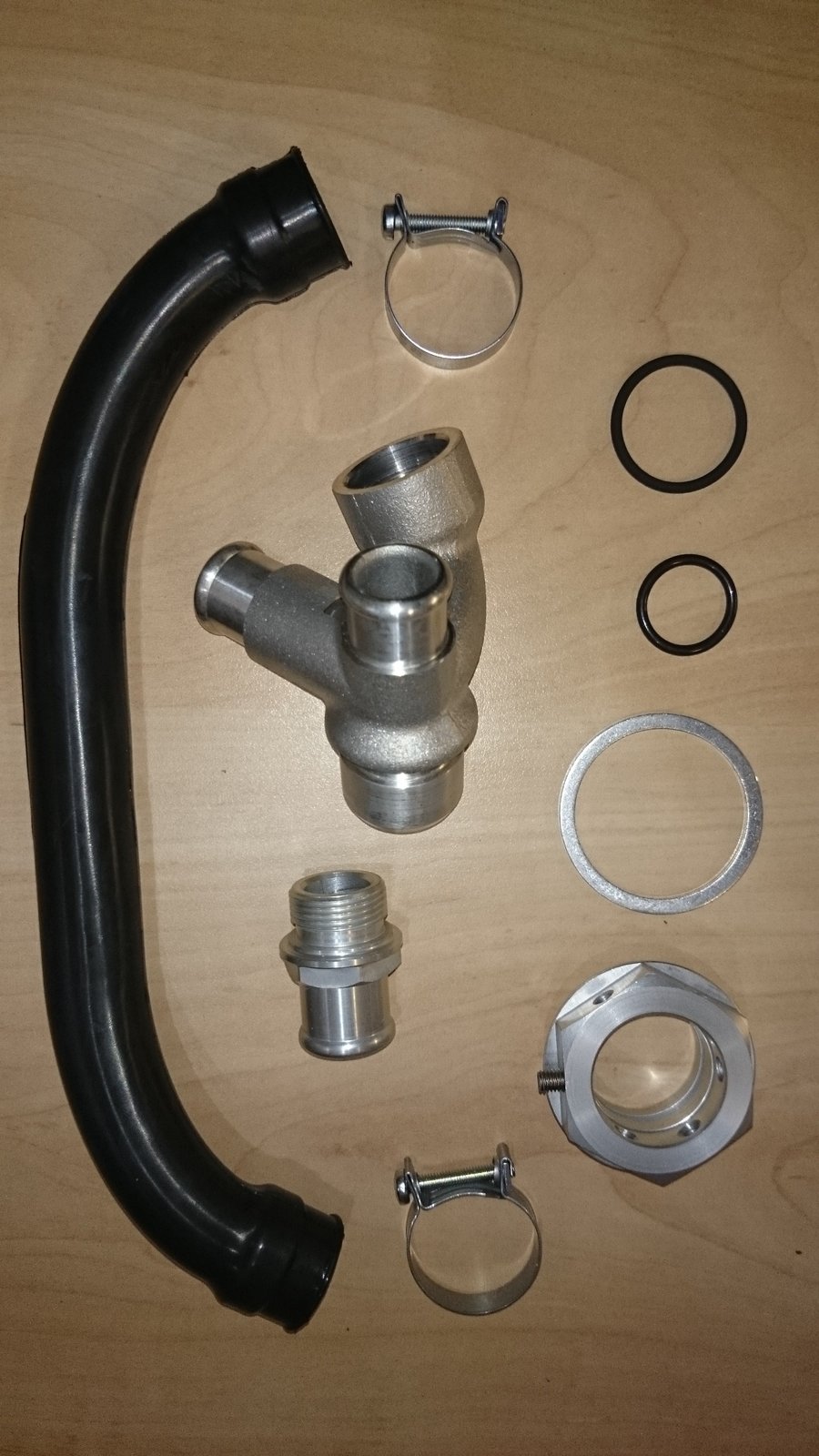

  1. Hi Guys. I'm having problems with oil seeping out of the clutch on my 749 race bike. It's fine when idling but underload it seeps. I'm not 100 % if it's through the push rod or behind the clutch basket so changed all of the seals including the main one on the clutch housing, seal on the primary gear, one on the basket spacer, push rod and thee two embedded seals and the small one it goes through. I've also changed the one behind the main clutch nut top hat. If that doesn't cure it, maybe it's piston ring change time.
    Last chance before I strip the engine? My question is has anyone used the breather system in the photo attached? They're from Moto Rapidio. I've had issues with the stock breather before.

  16. @Spjallen what's the idea of the 3 outlets on that breather/diverter you showed in the first post?
  17. The idea is to reduce crank case pressure.
    The three outlet junction screws into the existing crank case breather. One pipe goes to the normal breather route. One goes to the oil filler cap and the final one becomes the new oil filler.
  18. Interesting. Does this mean even less power loss than the oem system, which is basically retained or not??
