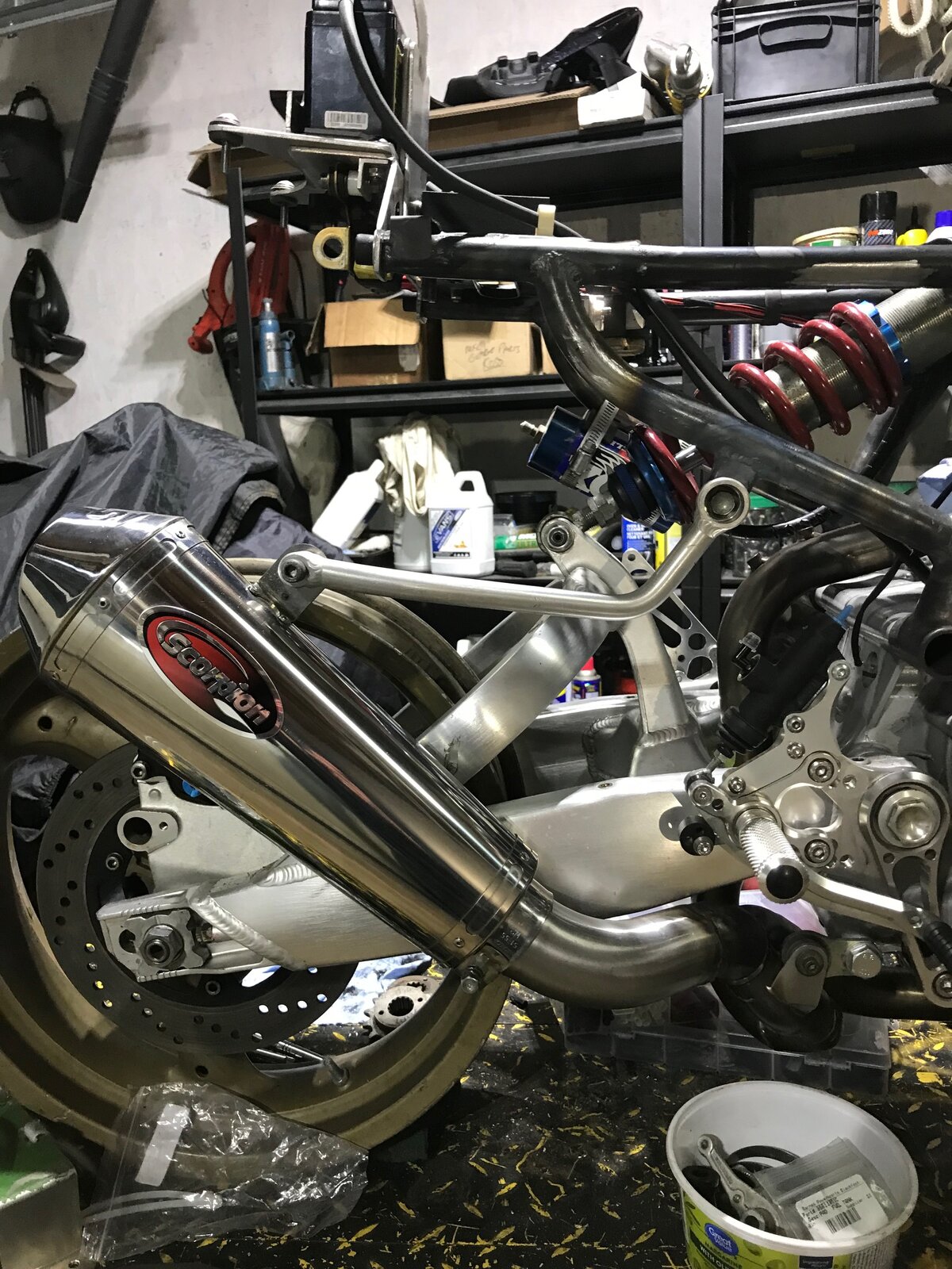

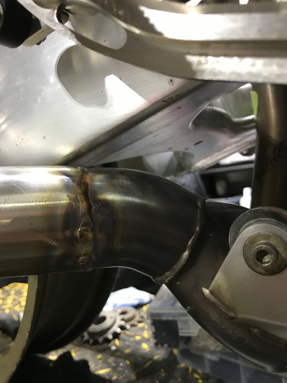

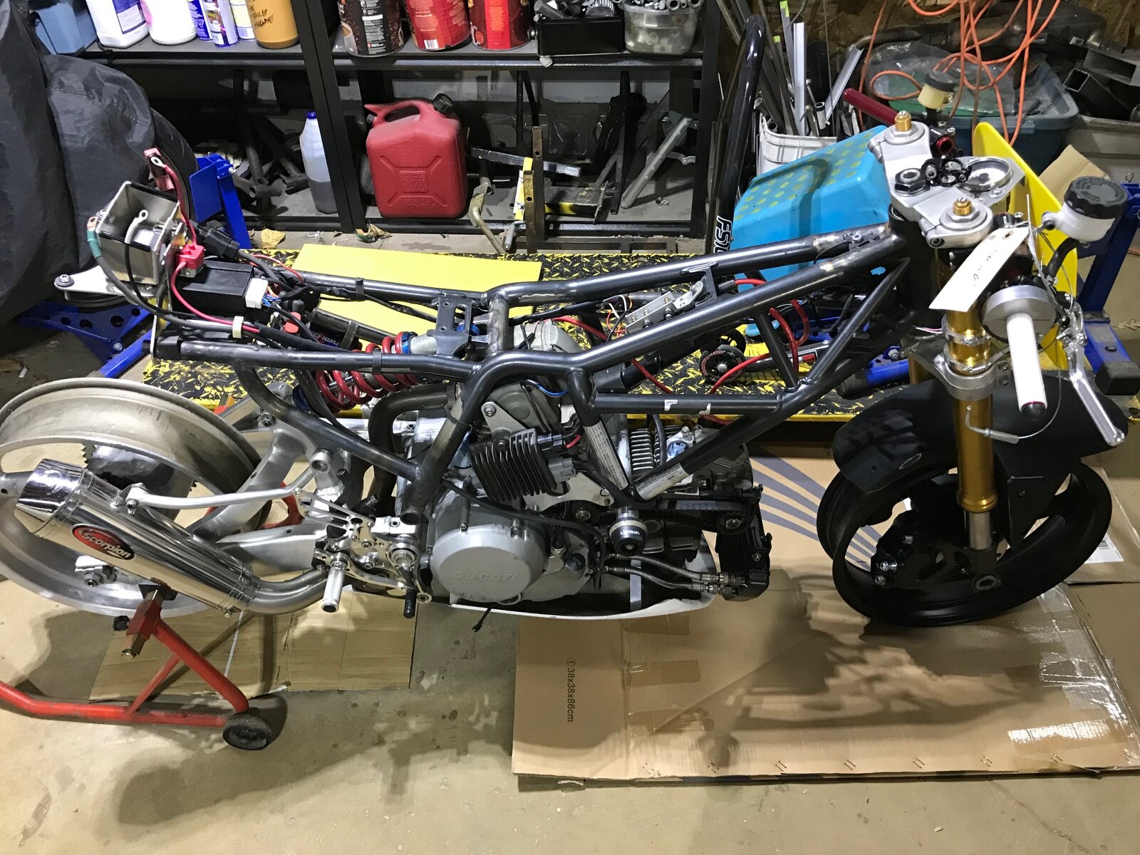

  1. Another successful weekend. The 2-1 collector that needed modification by my tig-welding guru was completed, so I went about completing the exhaust install.

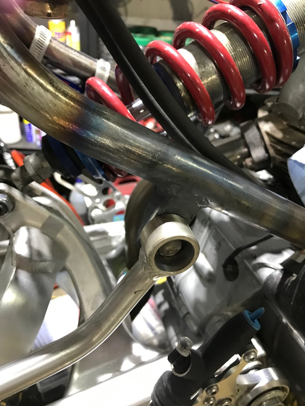

    I utilized an old steel suspension dogbone from some long-forgotten project to fabricate an exhaust bracket which mounted the 2-1 collector and headers to the engine, with a rubber bushing.
    The only type of bolt I could find in the coarse M12x1.75 was a hex nut, but it will do fine for now.
    Exhaust bracket mount fabricated and welded in place.
    The complete exhaust:

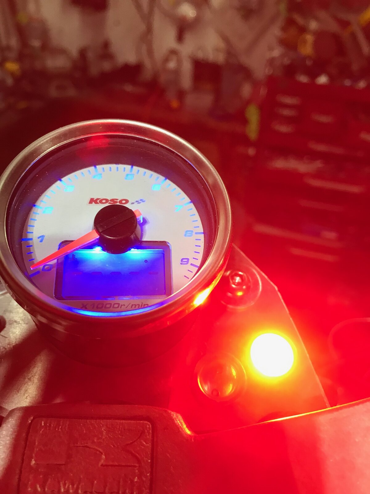

    While it was still on the cold side (wiring sheaths get stiff) I did some work on the harness.

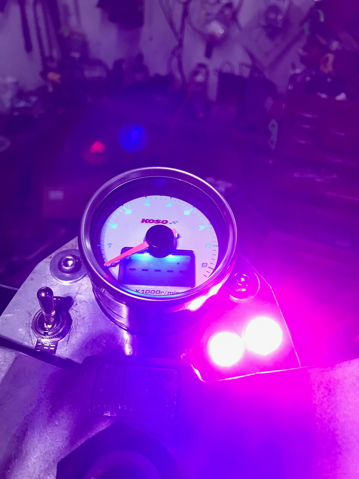

    I wired in the koso dash into the power leads, as well as the two idiot lights -- the oil pressure warning light, and the neutral indicator light. Everything switches on and off with the main 20A rocker switch on the dash.
    Both lights on -- the oil is red, the neutral is blue... both are so bright they overwhelm the filter on my phone camera.
    Neutral light off as transmission is clicked into first.
    The digital readout on the tach is for oil temp, but I did not plug that lead in. Still need to run the wire for the tachometer signal, which plugs into the ignitech.

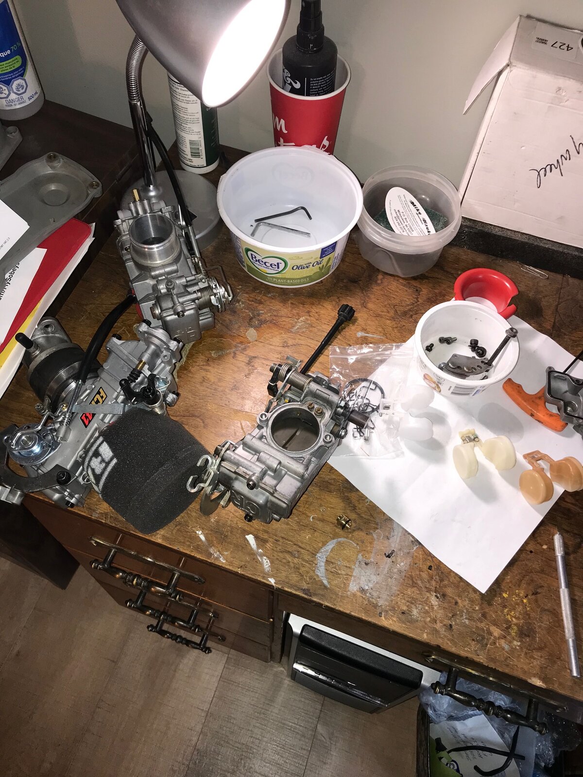

  2. My split FCRs have come in from overseas. I've also ordered a set of adjustable intake manifolds from Ducati Aprilia Kämna. I decided to take the carbs apart (the photos looked like the carbs were really clean) and as advertised, there were some new gaskets installed. I tried to set the float height to the recommended 9mm, but I was miles off. Luckily I decided to check out the float seat (which was new) and realized it was for the wrong FCR. I believe it's for an FCR-MX. Luckily Frank! MXParts out of Europe has the correct pair and those, too have been ordered. I doubt I would have gotten it to run properly as it was! I have the Chinese FCRs on the table for comparison. For what it's worth, the intake snorkel from the pukka FCR was damaged in shipping. The Chinese one fits.

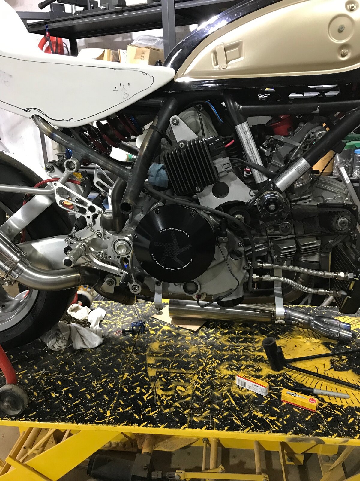

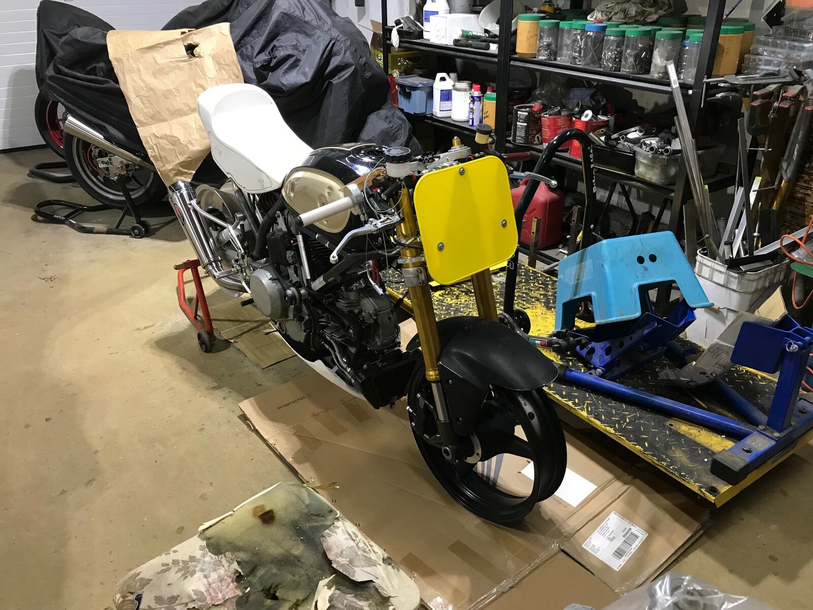

  4. A bit more progress. I had to wheel the bike off the hydraulic lift in order to jack up the front end -- I was planning on installing the spacers and the pair of rotors that I originally got when I started the project. However, the rotors did not fit the 636 front wheel. I confirmed it was the correct model year front wheel, and so realized that my original parts haul that started this project has ultimately left me with just one set of yokes, a left fork leg (right was so buggered I had to find a new one), front axle, and two calipers (both of which needed to be rebuilt). The rotors are a mystery and not suitable. Oh well -- either the guy I bought them off buggered me over, or he didn't realize he'd bought mismatched parts. I'll find a solution!

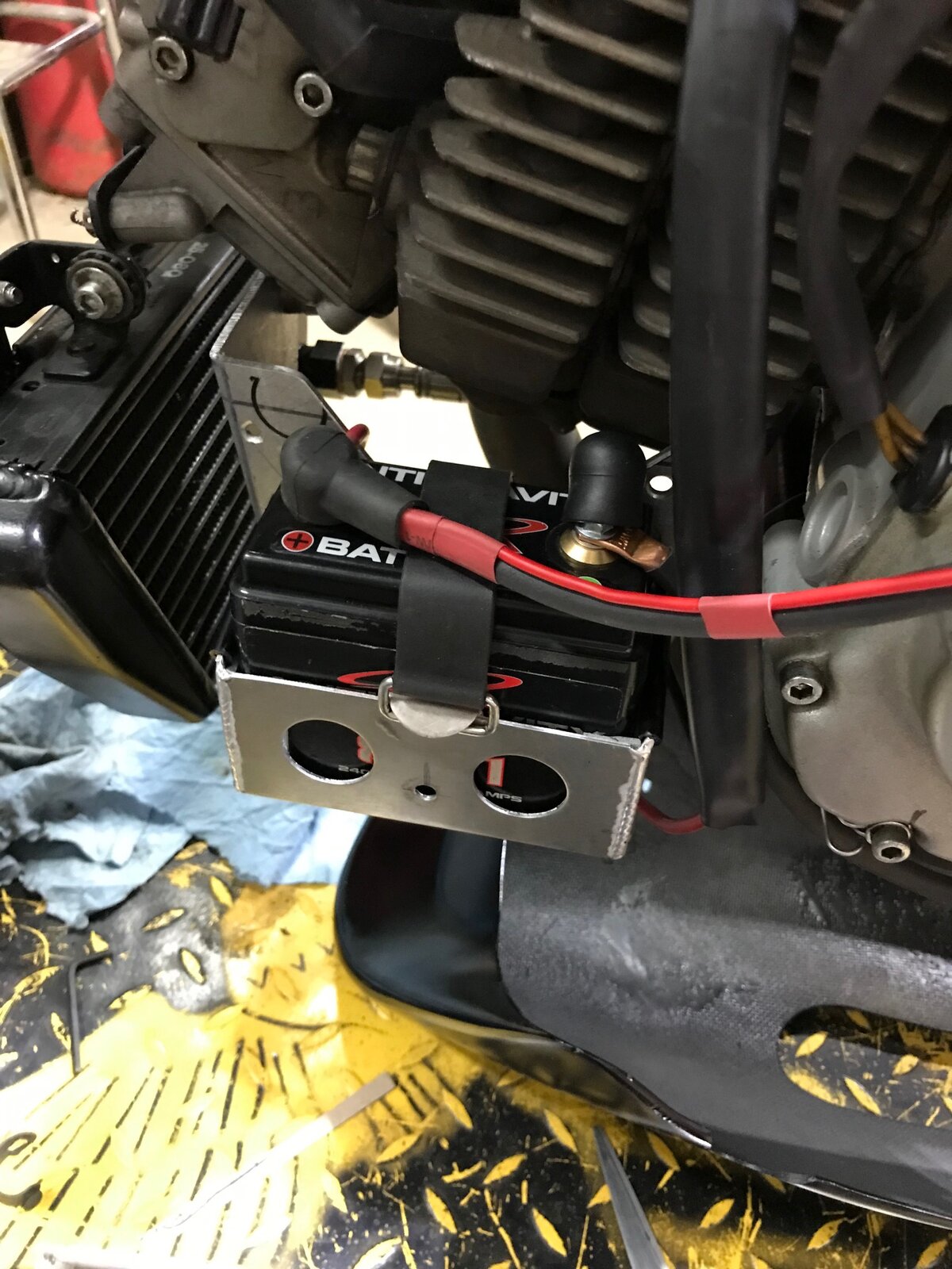

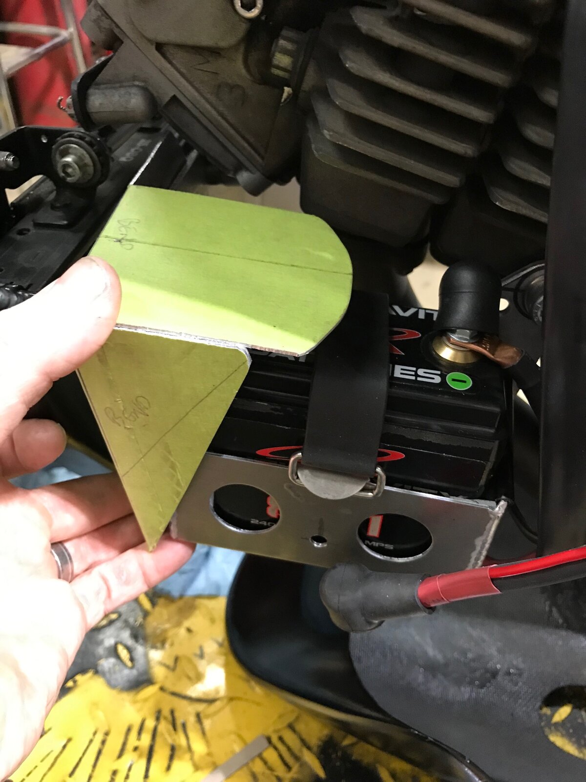

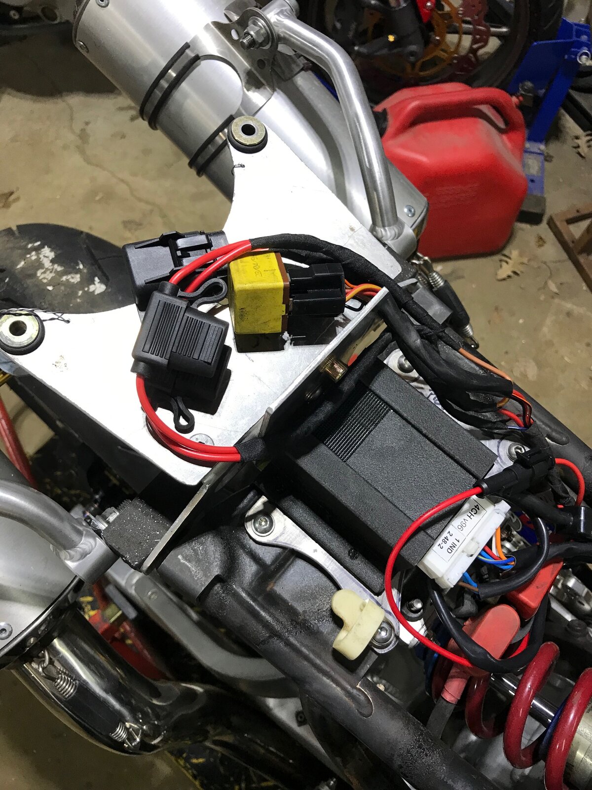

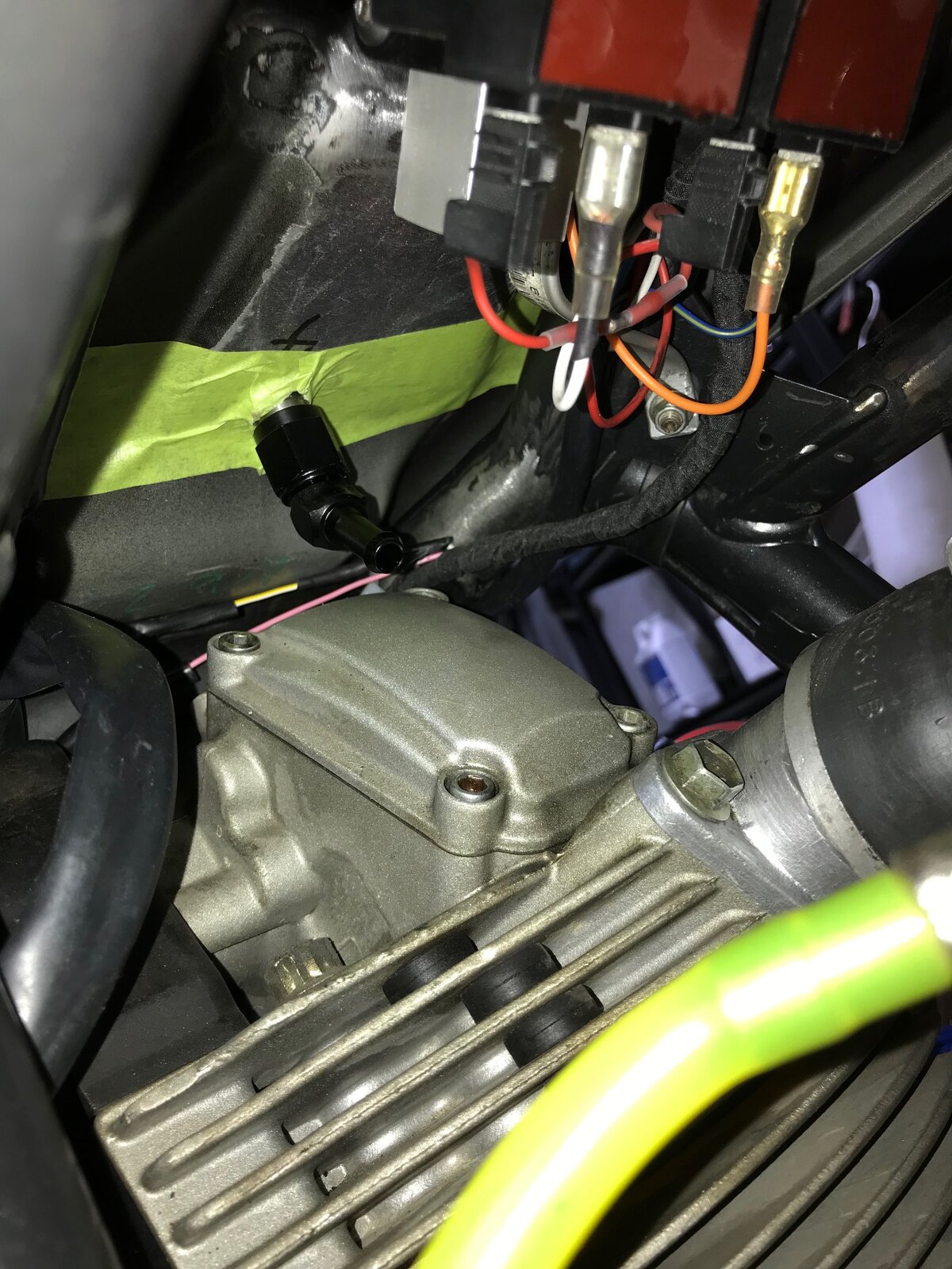

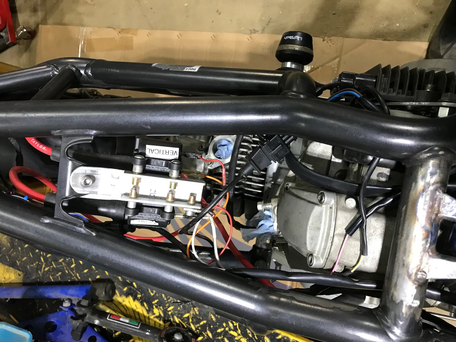

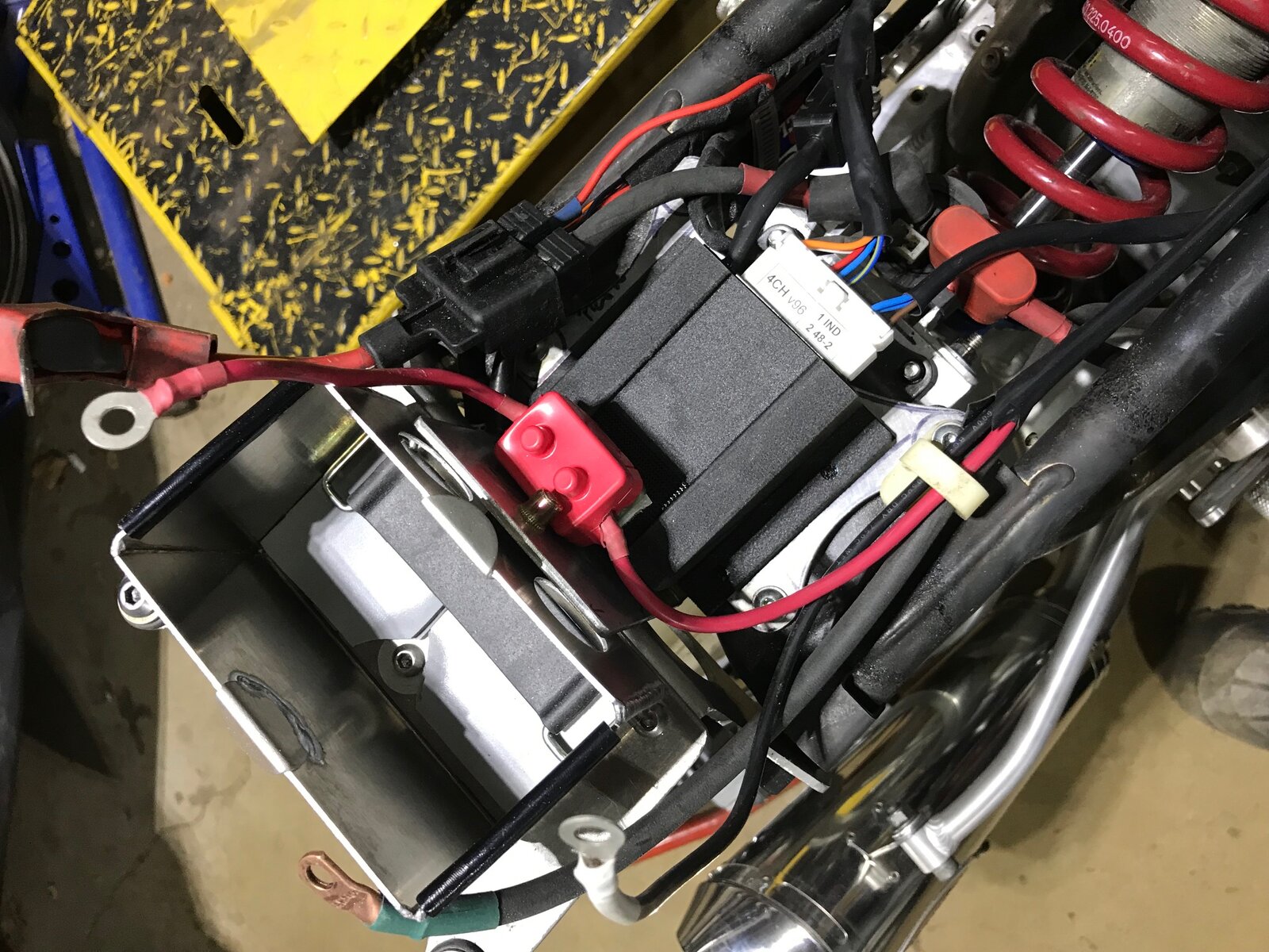

    In more productive news, I was able to wire in more of the harness -- I fabricated a mount for the reg/rec out of aluminum, and then plumbed the wiring back to the battery box. Over top of the belt cover is perhaps an odd solution, but quite common when upgraded reg/recs are added to Ducati superbikes. While I was at it, I also installed the ignitech ignition module.

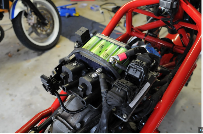

    I also added a wire feed to pin #15 for the tachometer signal. Thanks to Liam at Fastbikegear for sending me some replacement pins. With the help of a welding rod, I was able to feed the wire (the blue/yellow one) through the original shroud up to the front of the bike for the tacho.
    After confirming the schematic with Liam, I cut the wires to length and fitted them to the coils he also provided. As I'm converting an FI bike to carbs, the signal from the alternator is plug and play -- you can see the OEM connector at the 2 O-clock position from the coils.

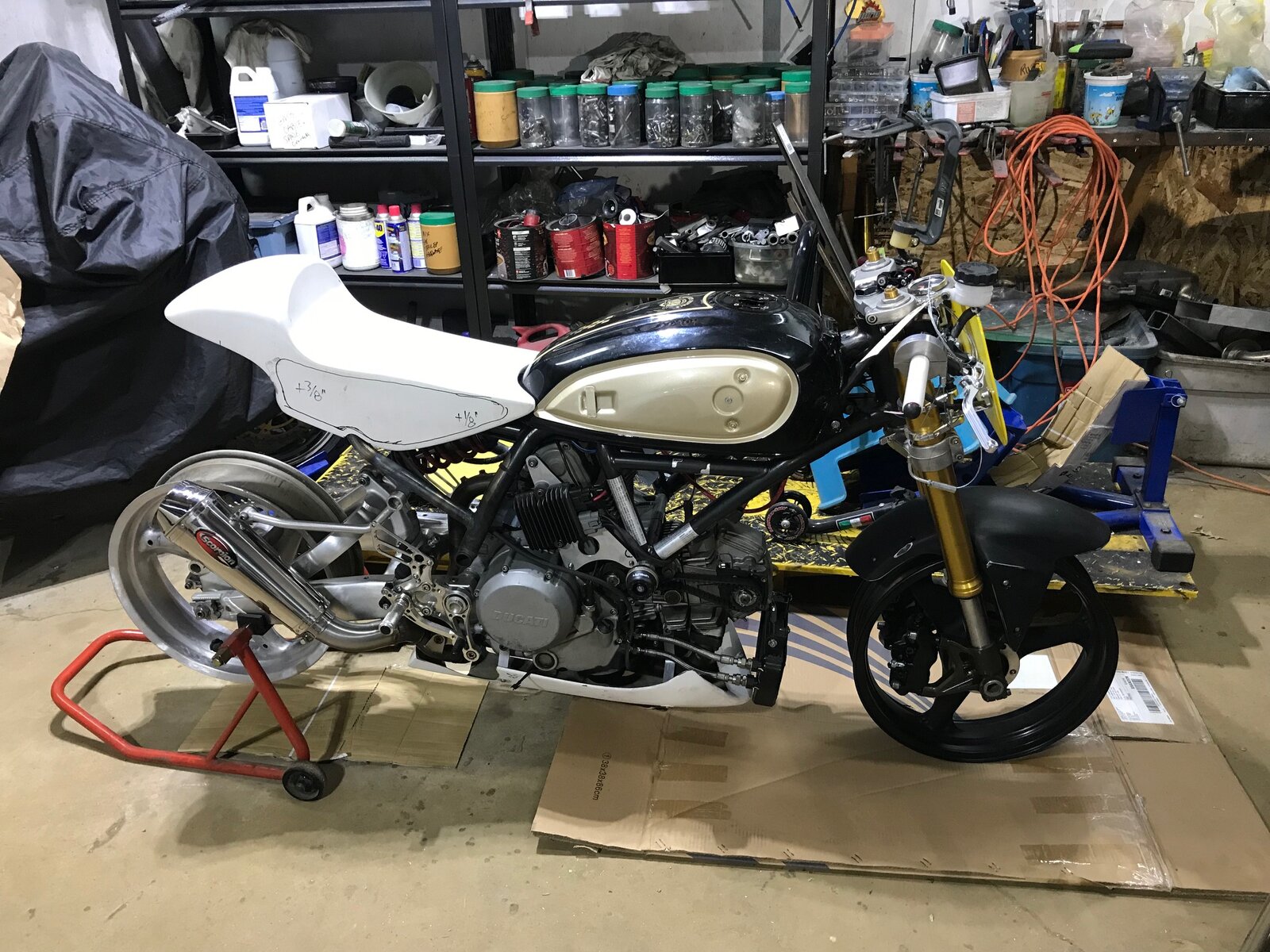

    I also fitted a 900ss/monster belly pan. I did need to modify the underside to clear the pipes.
    I also snagged a Ducabike 30mm clutch cylinder. It should help with the OEM 12mm clutch lever.
    The aforementioned brake calipers -- stripped and rebuilt with new seals, and then painted with caliper paint and baked in the $15 toaster oven for an hour. I wonder how durable it will be??
    Note the leaking fork -- new seals to come for sure!

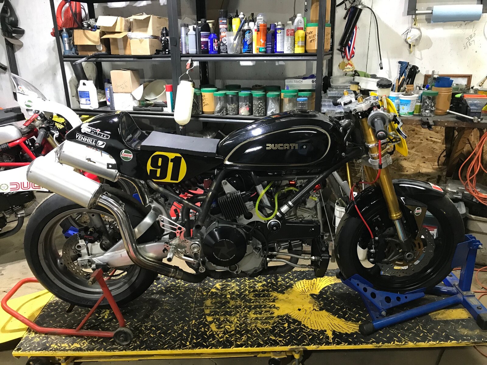

    Bike seems "long and low", but that is likely due to fact that there are no tires mounted! Wheelbase is 55", +/- rear wheel adjustment.
    Looking a bit racey...

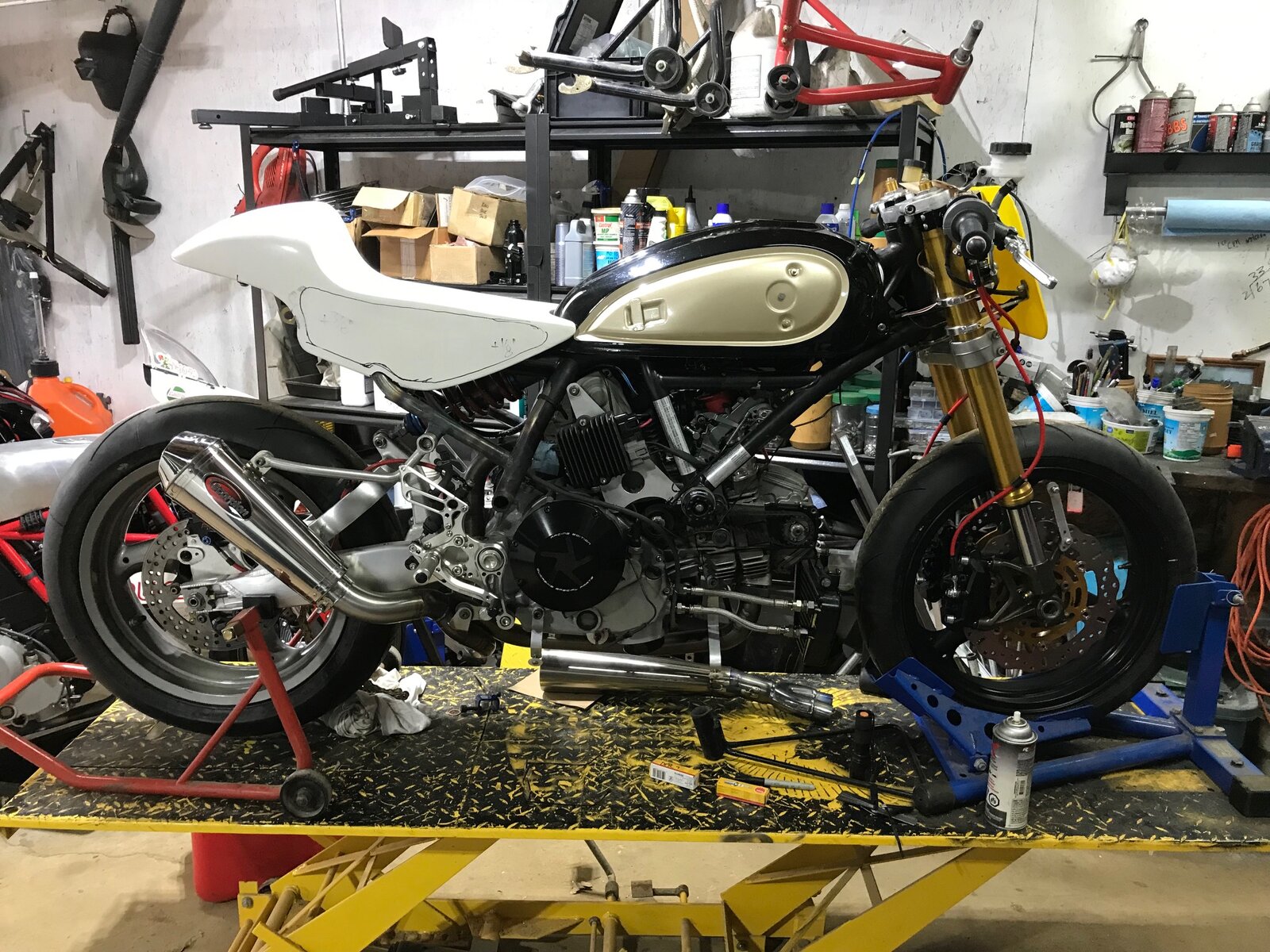

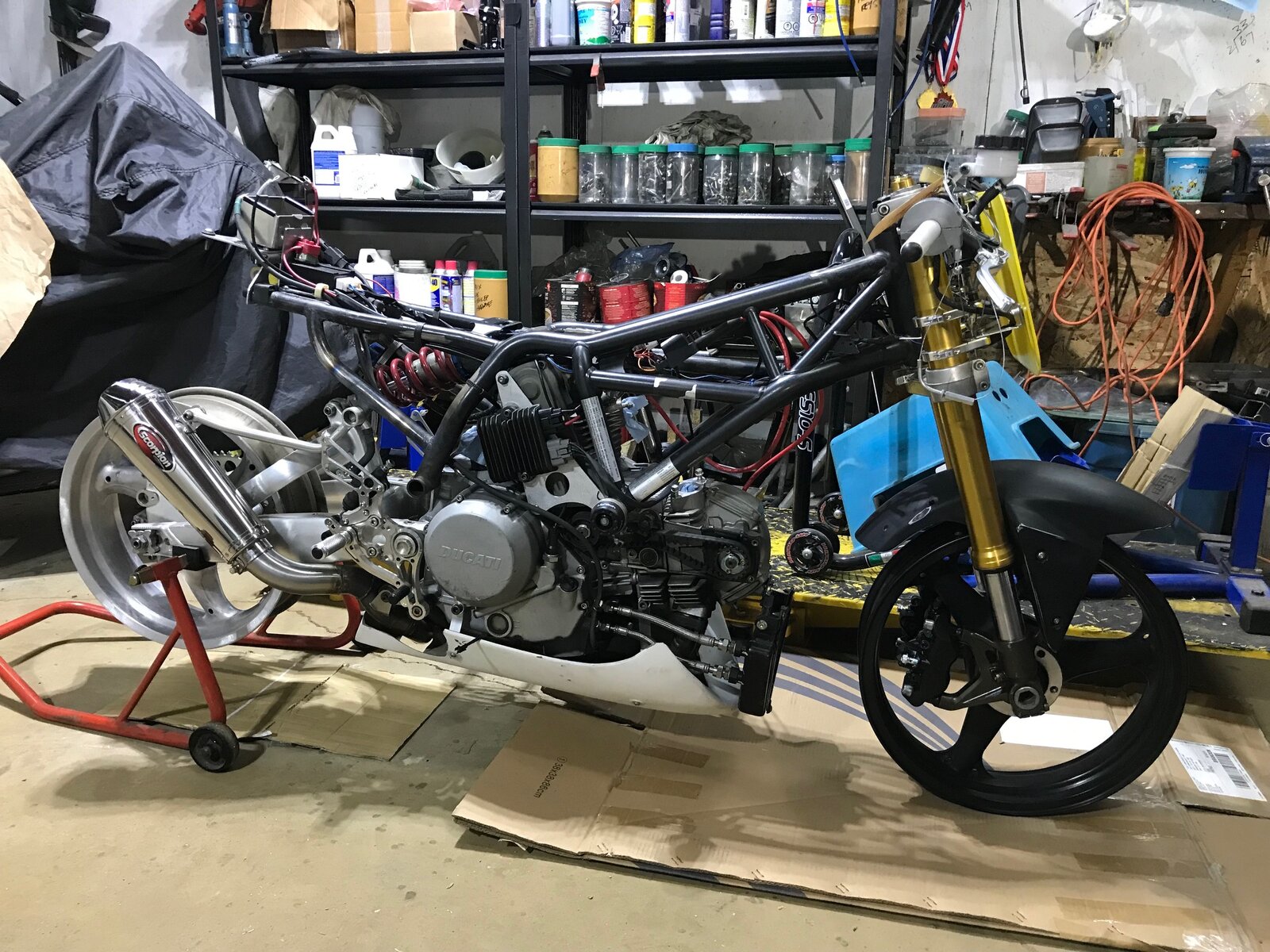

  5. Some more updates on the Scrambler project. Now that the weather isn't too miserable, I mounted up the Metzler racetechs and got the bike back on the lift.
    Even just mounting the tires makes the bike look far more along in the progress than it actually is!

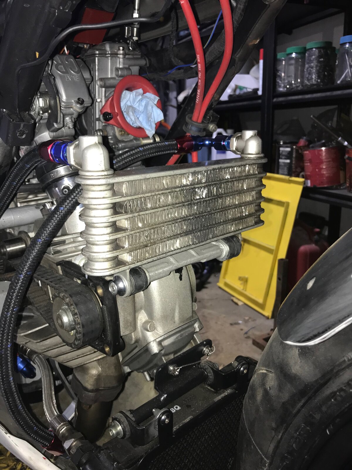

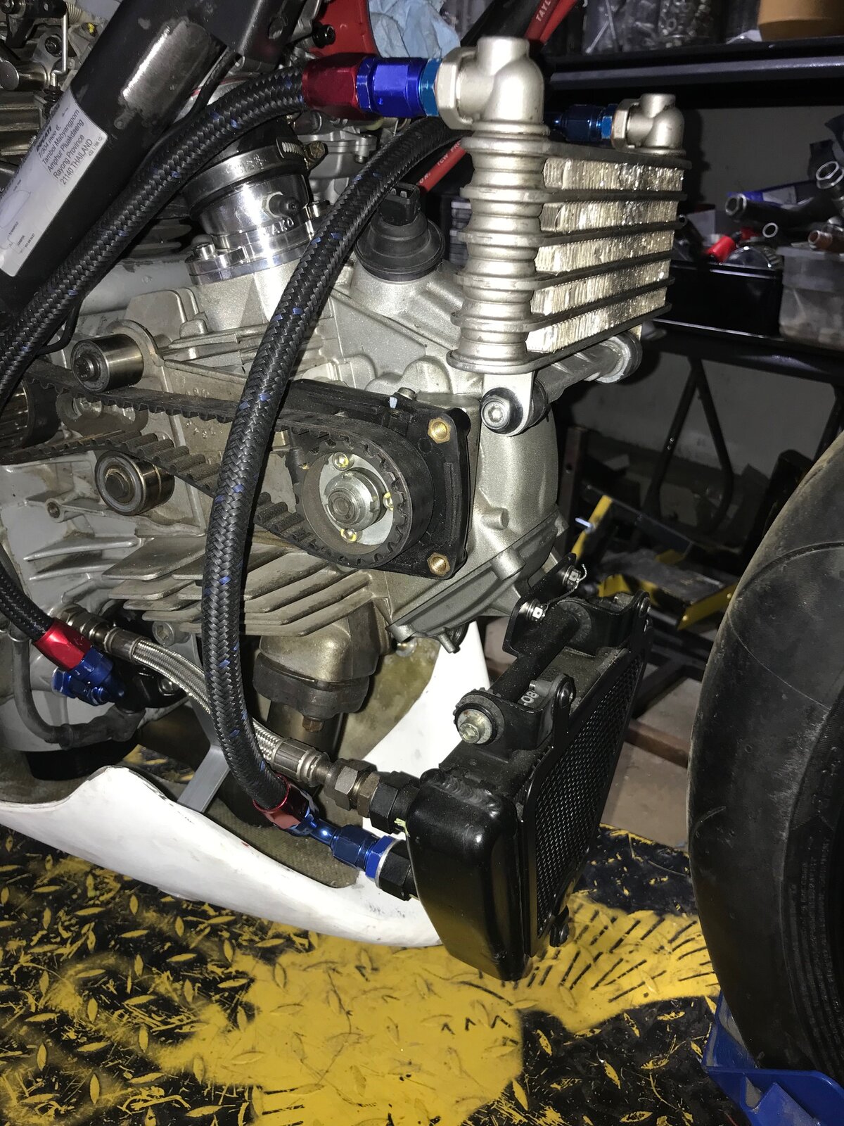

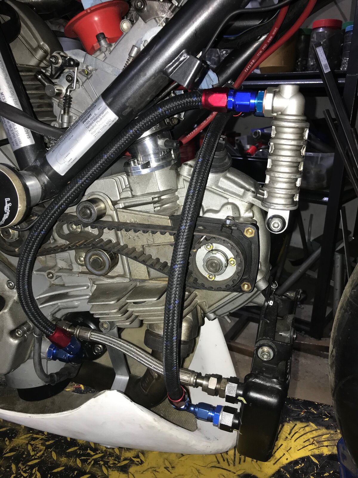

    I'm a bit nervous about the vertical carb's gaping velocity stack ingesting a boulder or two... playing with the idea of mounting 2 oil coolers, one below the horizontal cylinder and one above, with the upper on doubling as a fender-extender! upload_2025-4-19_10-15-50.jpeg
    Realistically overkill for this application, but it may necessitate a bunch of engine mods to justify 2 coolers!

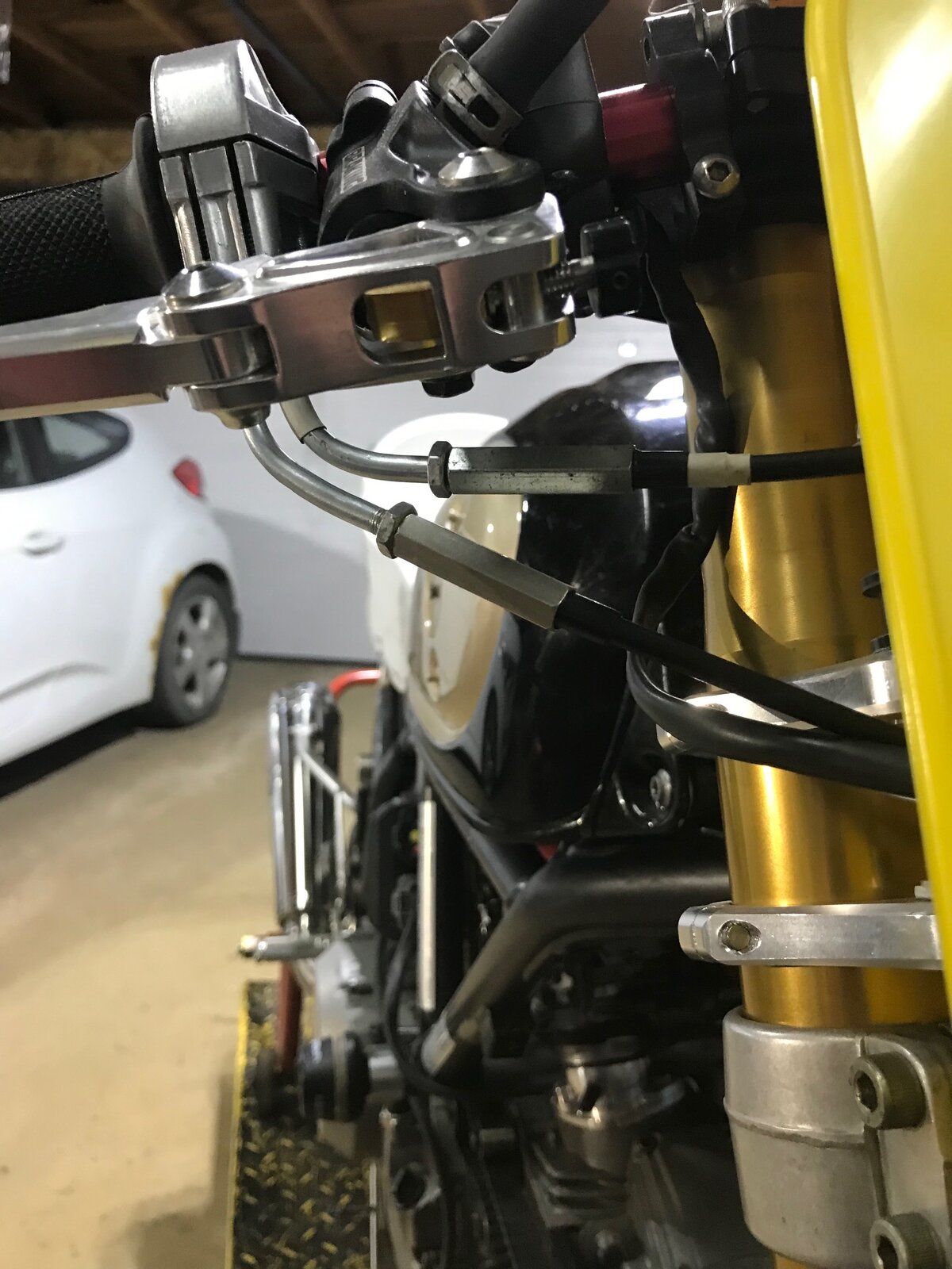

    Making the throttle cables was tricky. Some patience with my bits of venhill kit eventually resulted in a twin-pull setup.
    I had a "come to Jesus" moment on my RD350/400 hybrid early in my track "career" when the 1-2 splitter jammed open... I vowed I would avoid using cable splitters whenever possible.
    The TZ250 throttle housing is very neat, but the throw is super-short -- in the end, it might not be suitable as everyone loves a short-turn race throttle, but the cam on this unit is pretty extreme -- 1/6 throttle?

    Note the two brand new EBC wave rotors... $50 each from an overstock outlet on ebay. Still waiting on some matching pads to bleed the front brakes. Did some more servicing with the FCRs (preventative o-rings in the fuel spigot), and I'm just waiting for a new set of belts to arrive before I consider starting it with a dummy tank (the actual fuel tank needs some modification to the underside to work with the gravity fed carbs.

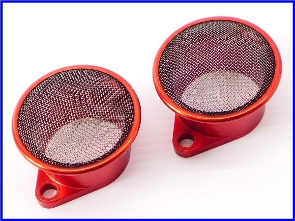

    I also found these nifty things from Japan:
    Hopefully a reasonable compromise between restrictive and goofy looking foam socks, and running them wide open.

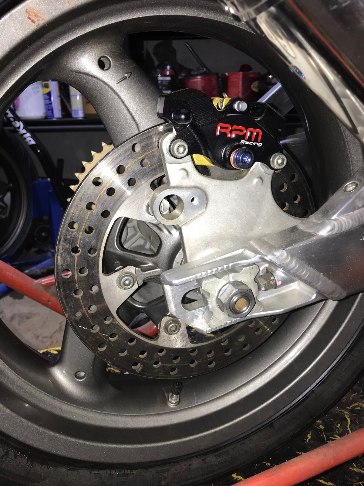

  9. Whats the quality of those RPM calipers like? I see them all the time on various websites like Alibaba etc for pennies and wondered if they were any good :)
  10. They are OK -- this is the second bike I've used them on. Cheaper than a replacement set of brembo brake pads. I never use the rear brake, so...
    A fella on the PB forum who is a great bike builder (frames from scratch, etc) uses them as well.

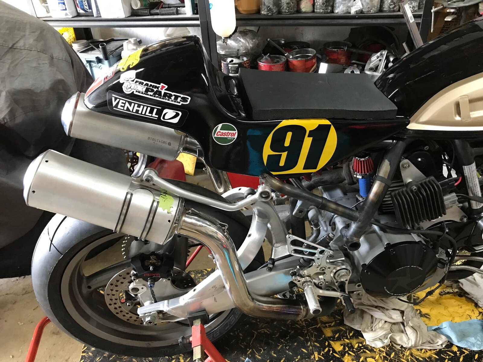

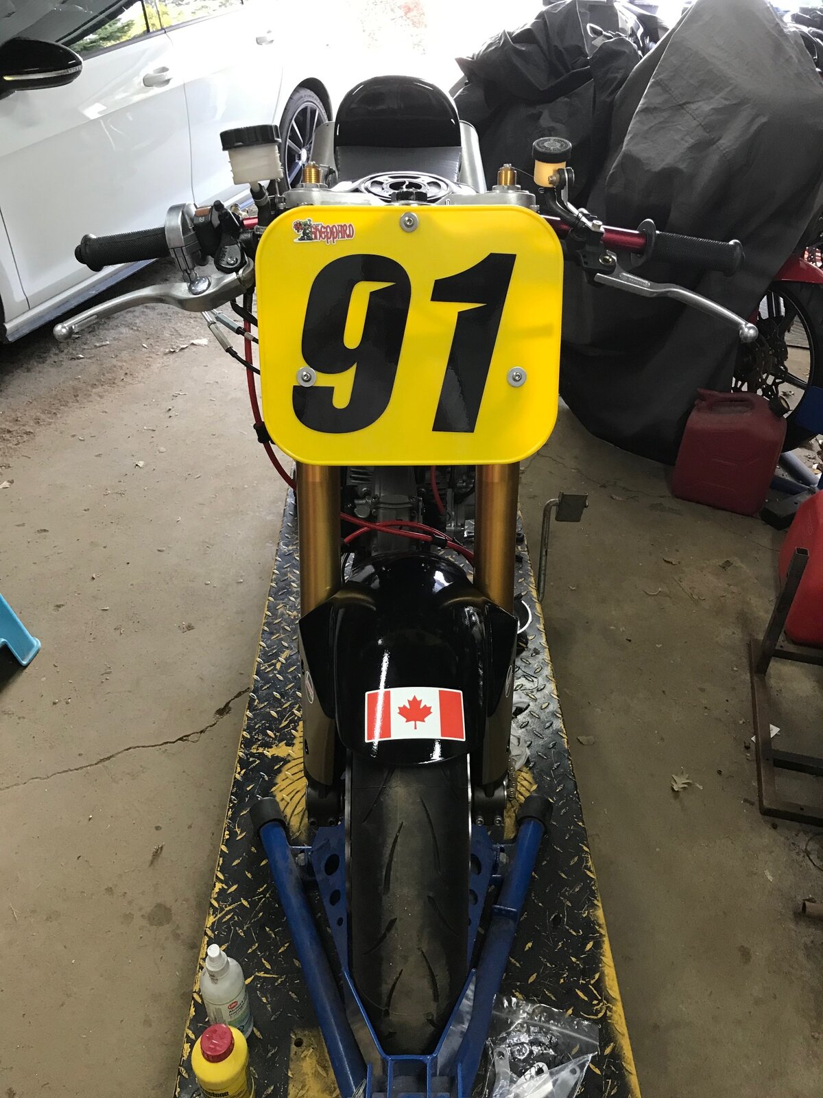

  13. While waiting for parts to show up, I couldn't help myself and went ahead and did some painting, as well as 2-part clearcoat.

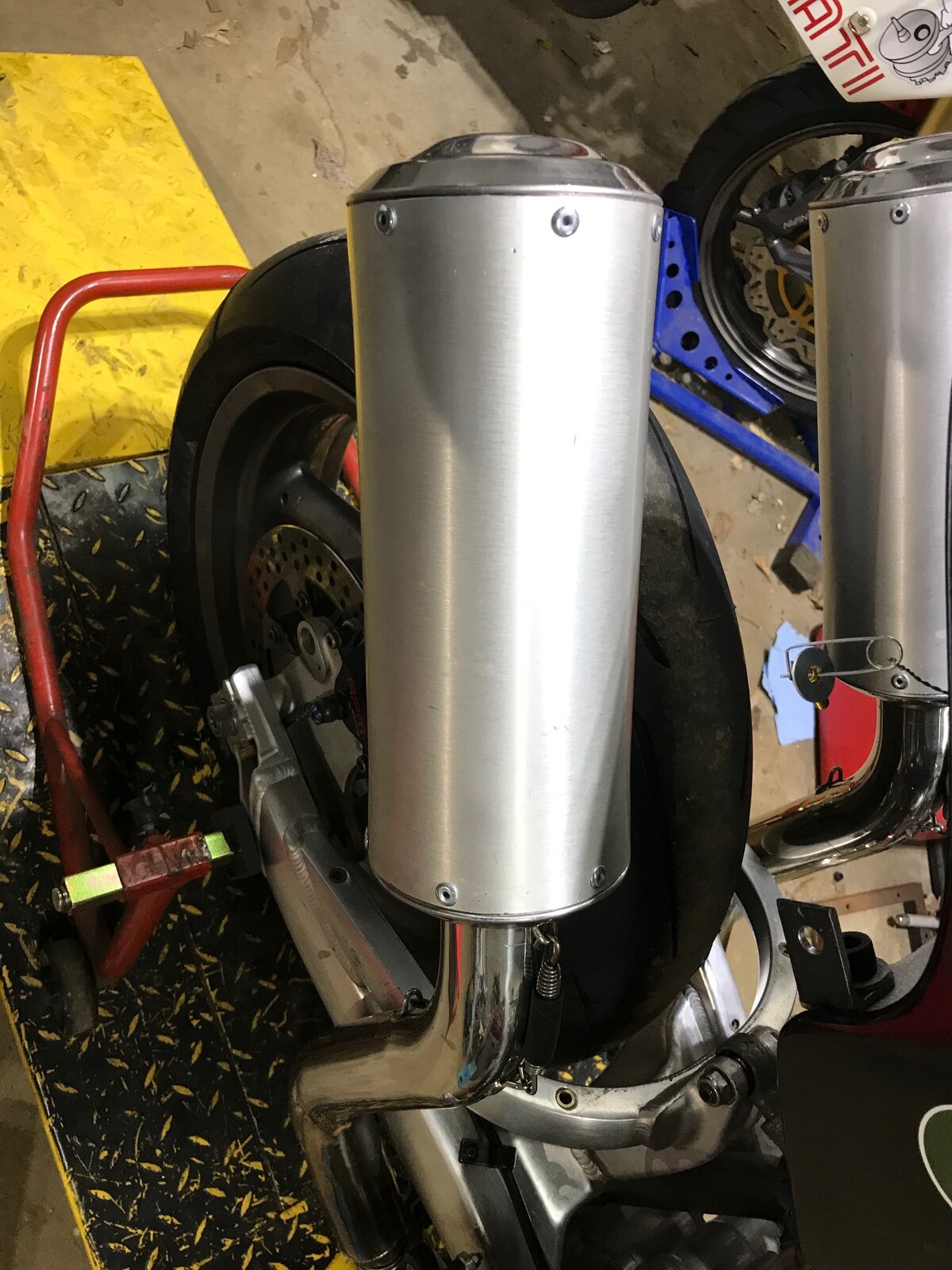

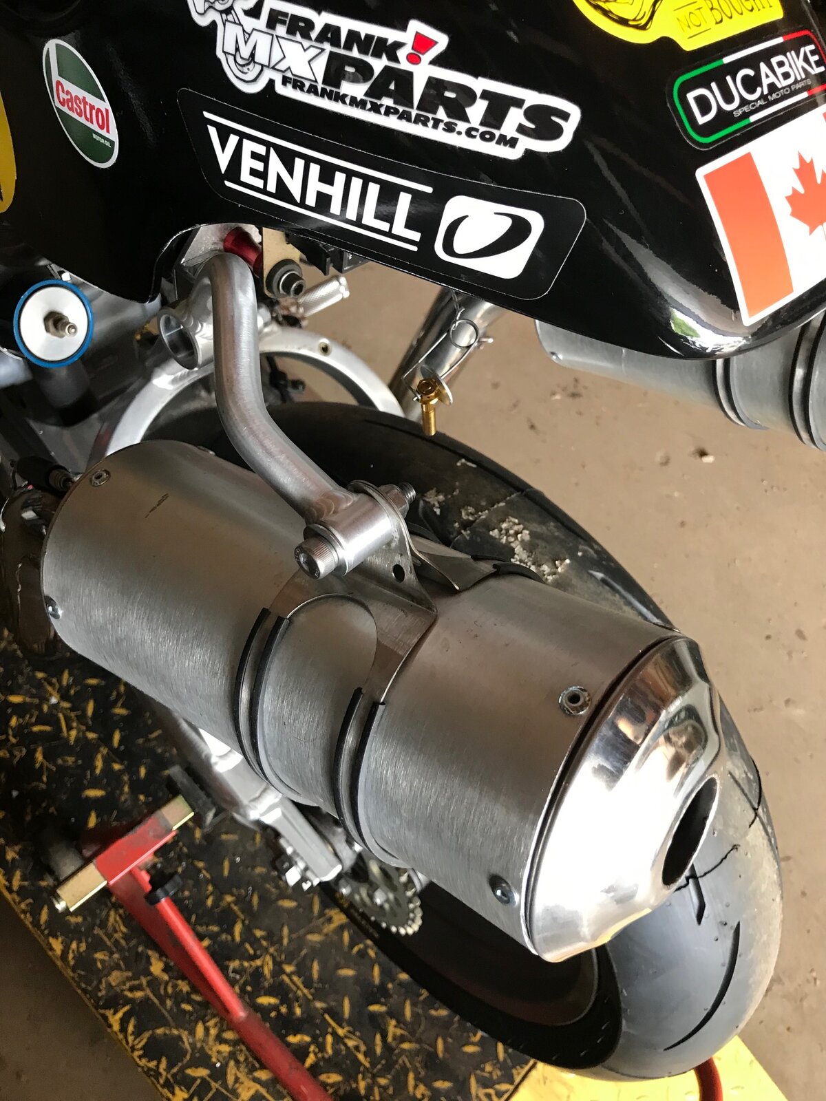

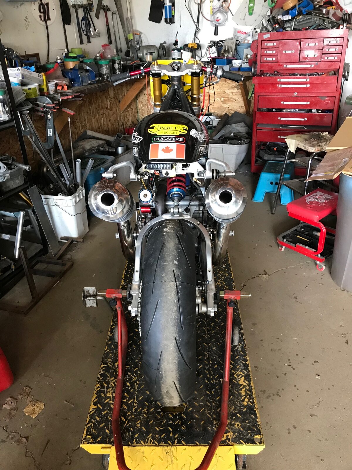

    I also have some yellow and gold vinyl, and some race numbers lying around, so I took care of that as well. I also stared at the unused Bimota mufflers from the 2-1 system, and did some figuring. I'm in the process of converting the GPR exhaust guts into the better aluminum sleeves, after cutting 10" of the muffler off to use as a starting point. I think they look kinda neat. Now I'm trying to come up with an exhaust mounting solution as well for both sides. I do have some even shorter and louder Lextek mufflers inbound, but I might end up returning them if these come together as I hope.
    Got the holes drilled on one muffler, and will temporarily secure them with Clecos. Muffler packing, proper rivets, and new exhaust springs in the mail. Slapped on some seat foam as well.

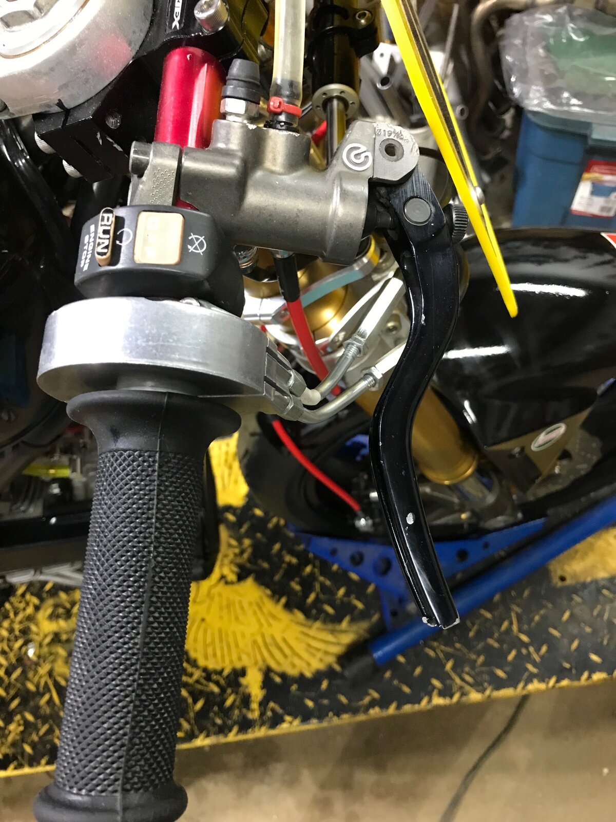

    More stickers (I picked up a few Canadian flag decals when I was at the vinyl shop looking for some transfer paper offcuts). The S1000rr master cylinder arrived. At 19mm it is far more suitable than the 17mm I had on previously. I think it is a 19x18 -- a 19x20 would feel "better", but I need to remember I'm only trying to corral 70ish hp.

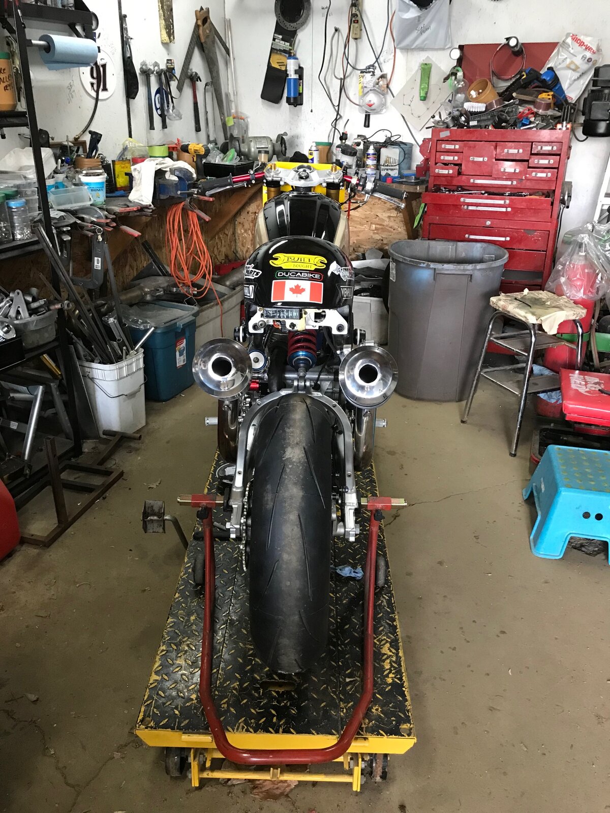

    The view from the rear:
    The mufflers need to be better aligned, but that will come with a muffler hanging solution. Another maple leaf to remind "the Donald" that Canada isn't for sale. Big props to King Charles for his visit last week!

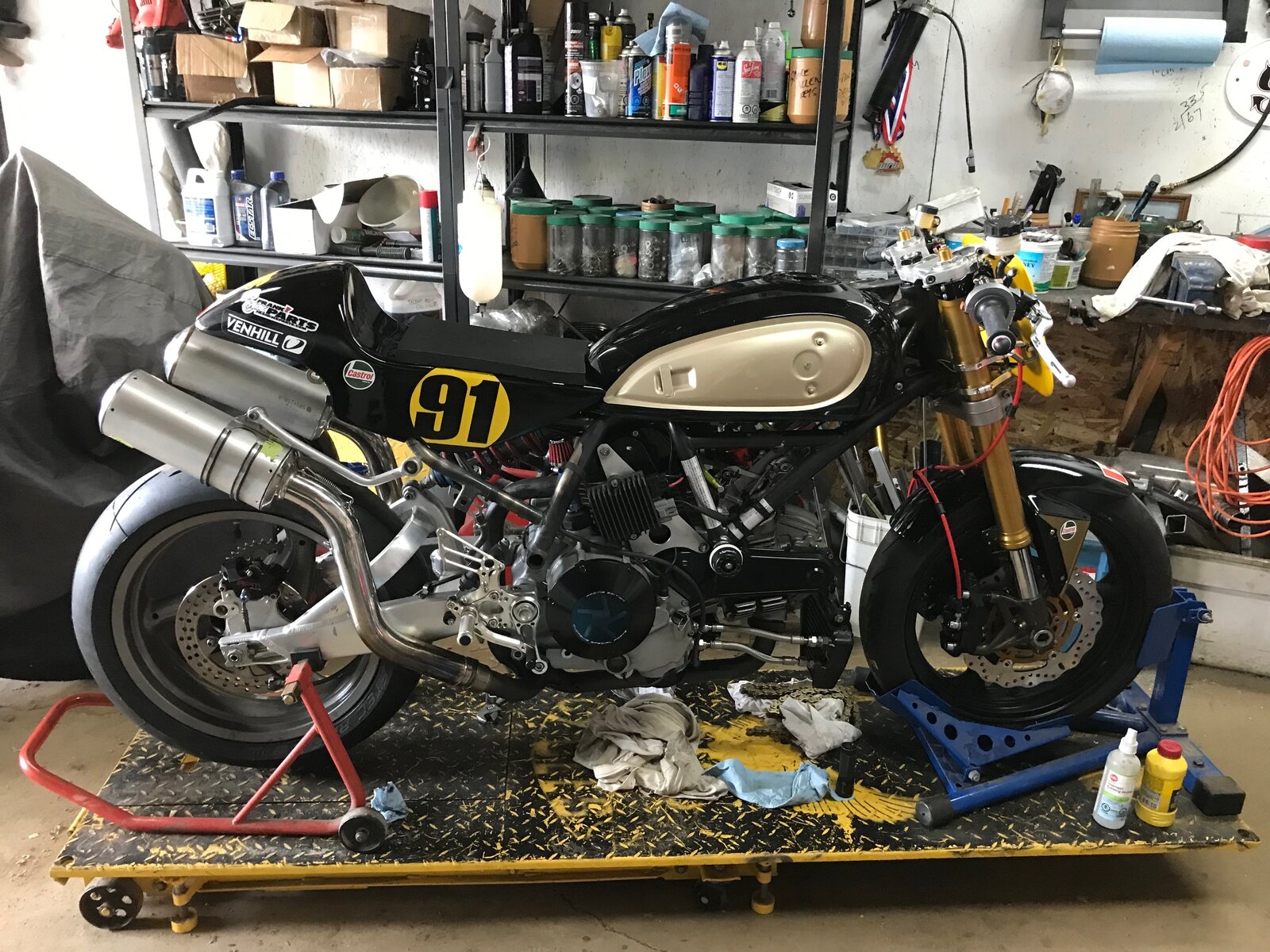

  16. I'll post a video later, but the Scrambler project is RUNNING!!! Not done by any means, but the ignitech worked as advertised (once I'd connected the coils up properly). Huge relief and sense of pride at this point. Got it to settle at a nice idle using the Chinese FCRs. Used my vacuum gauge to balance them. I'm obviously going to need to play with jetting, but it runs OK as is.

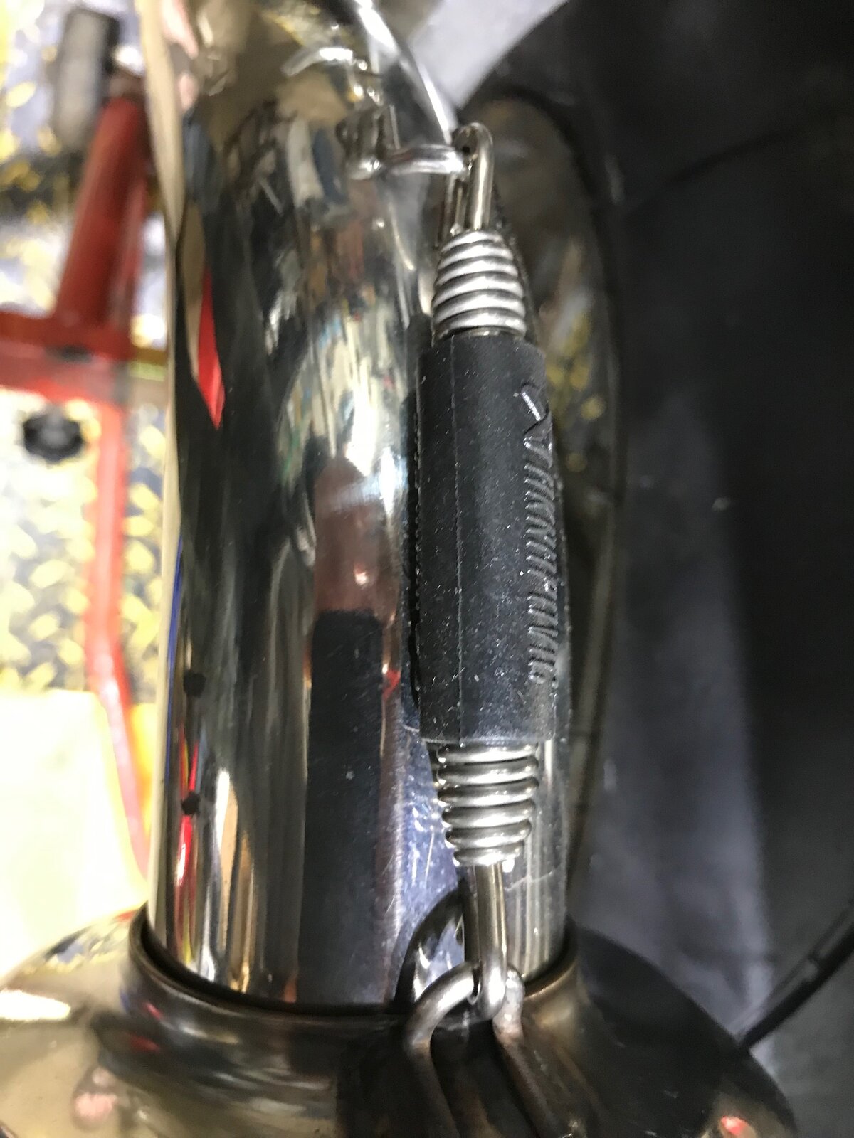

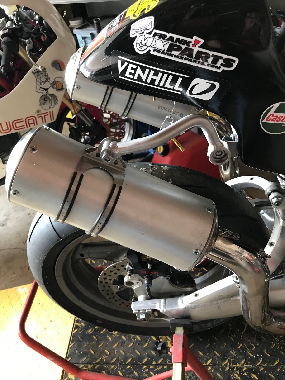

    The scrapped Bimota mufflers were repacked with a bit of stainless steel around the perforated core, muffler packing, and then assembled with proper exhaust rivets. upload_2025-6-8_13-50-6.jpeg
    Turned out OK, IMHO. Also picked up some Akrapovic springs to replace the shite Chinese ones I was using.
    My "3rd time's a charm" front master cylinder showed up. A 19x20 Brembo, with a light scuff and a broken lever. Quality, even if second hand. Bled up quickly and feels great. Replacement lever on the way.
    Now that it runs, I carefully drilled the underside of the tank to fit the fuel delivery system. Mild steel male AN fitting, with a nice aluminum 5/16 barbed AN fitting attached. Will run an inline filter and a dry break fuel line, similar to what I had on the TT project. Taped in place to take to the welder.
    Another bike built from scratch! I'm a happy chappy!

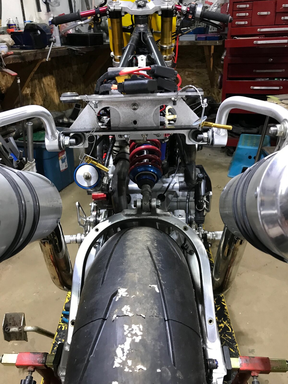

  17. So the left and right hand side aluminum muffler brackets showed up from Japan. I've used them before in other lengths, and they fit up nicely!
    They are oriented "upside down", but this is the best way to fit them, based on the frame location, angle of the muffler, etc.
    The L-clamp bolted to the frame will be modified to be a bit more sturdy, the sharp edges removed, and then painted (of course). New muffler straps are also inbound from the UK as these are looking a bit worse for wear. Methinks I have a pair of cans properly secured, though!
