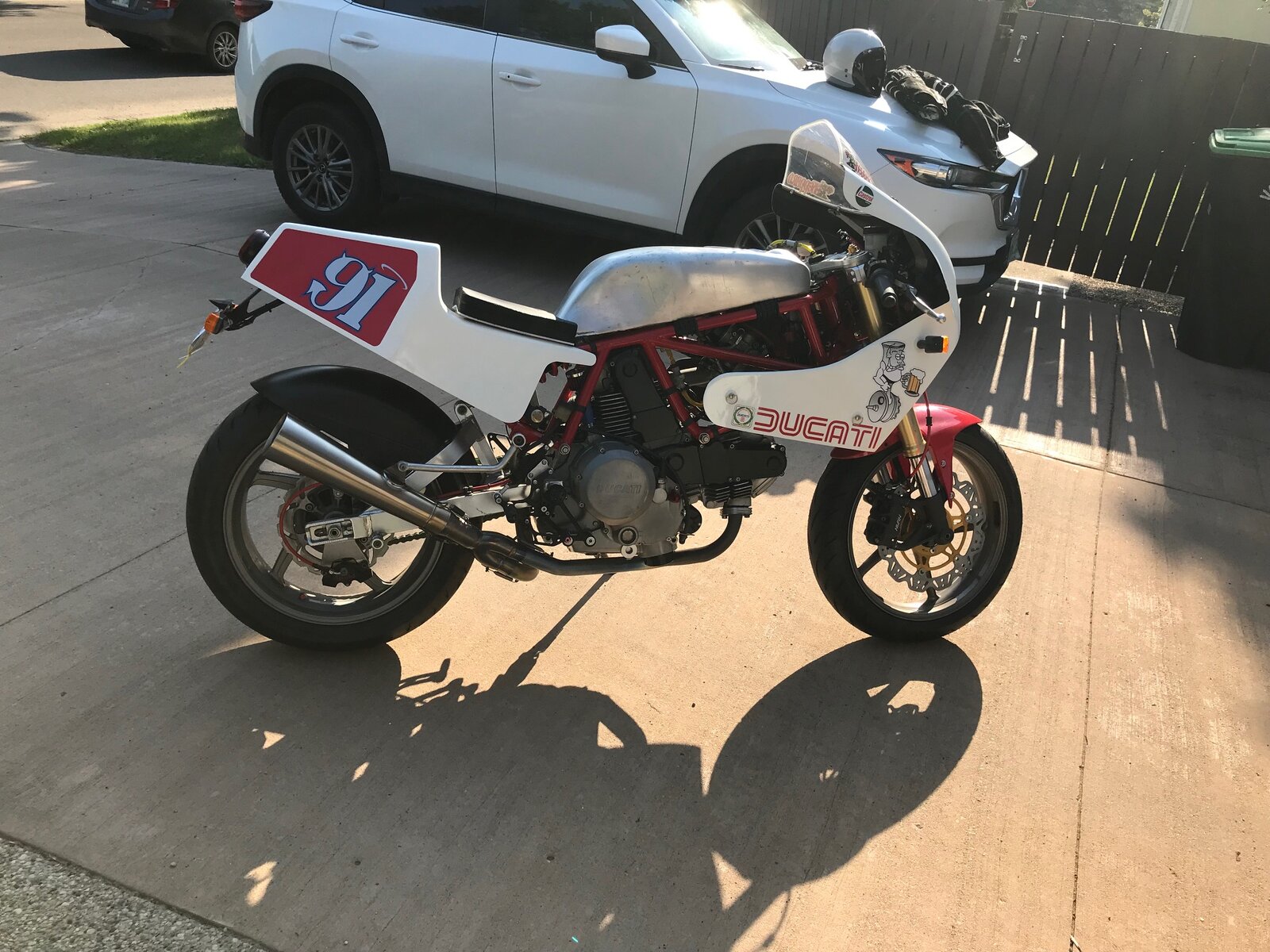

  1. While I wait on various sundry parts for the scrambler, I got temporary certification for the TT replica and took it on some test rides.
    Approximately 90km worth of dead bugs on the fairing.
    Bike seems to ride as it should. All the consumables (tires, brakes, rotors, etc) are brand new, and the front brakes are bedding in nicely. Bike starts easily on the button. Being a 600-based engine (with a 680 kit), it is not fast by any means, but sounds good with the 2-1 and megaphone exhaust. For the little I've ridden it, it also handles great (being super light), with a very racey seating position. Like any project, the to-do list is never ending, from a valve check to fine-tuning the sprocket alignment. If the weather holds, once I get it back from our version of the MOT centre, I'll take it to a "cruise night" tonight.

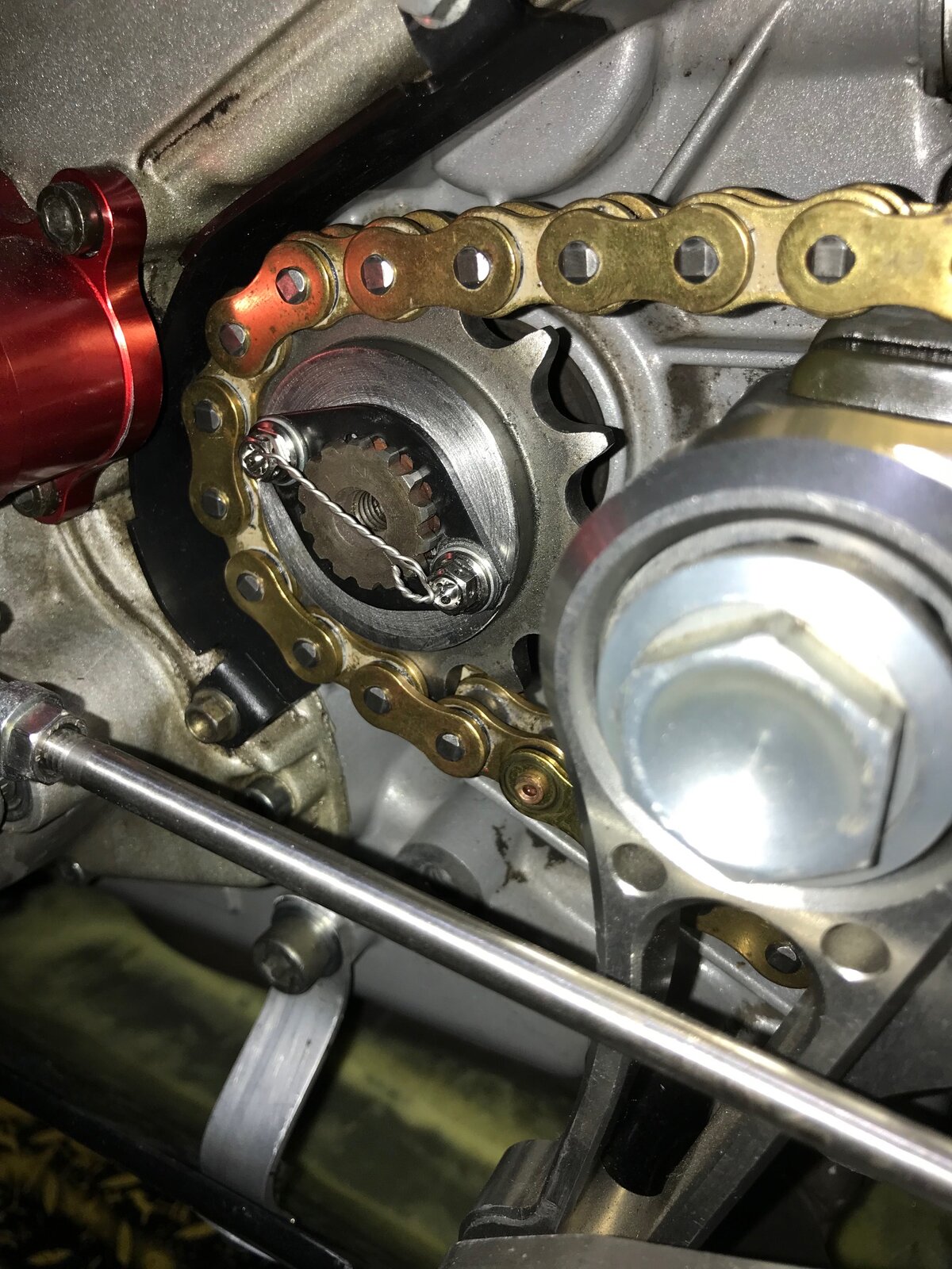

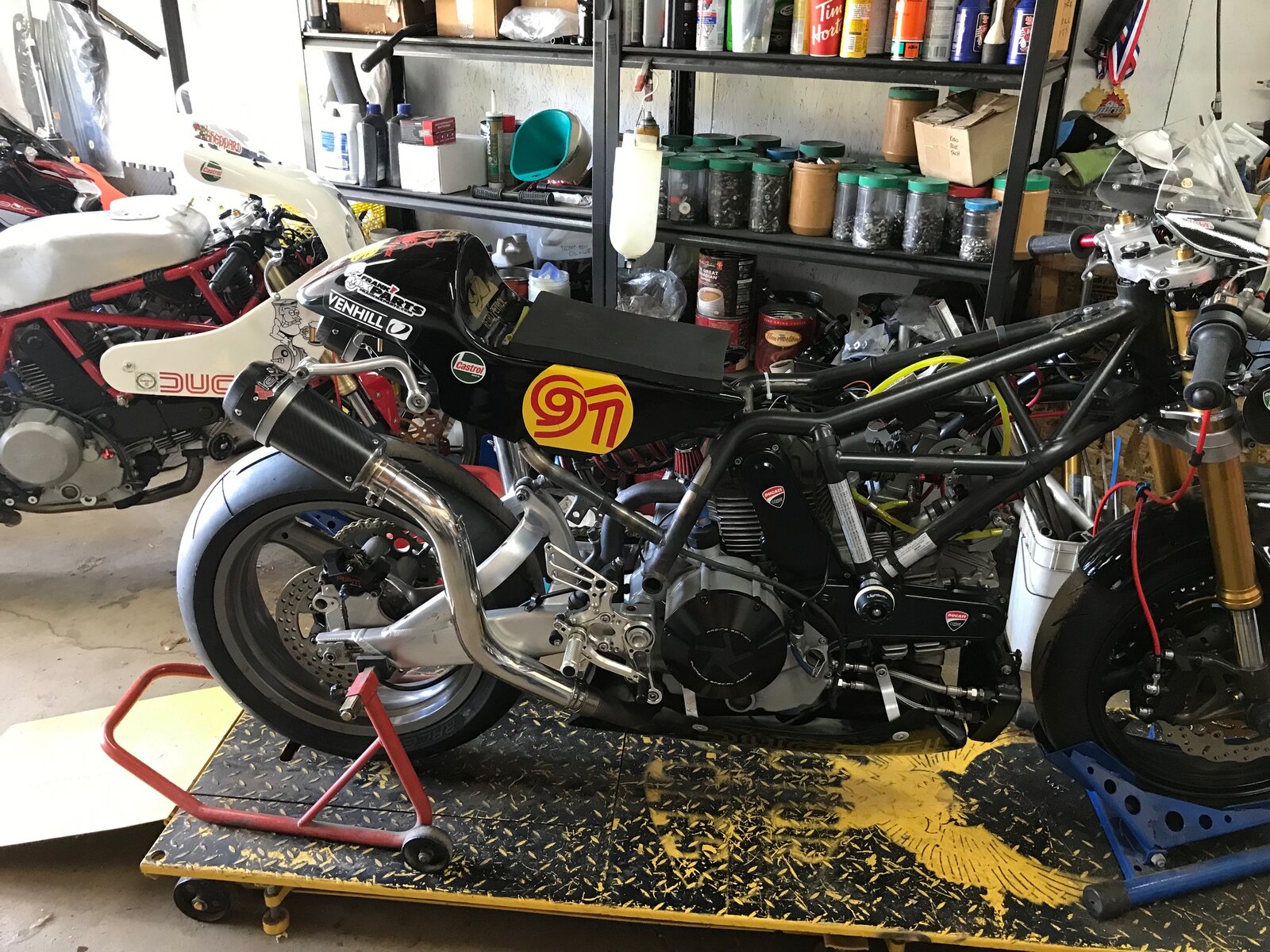

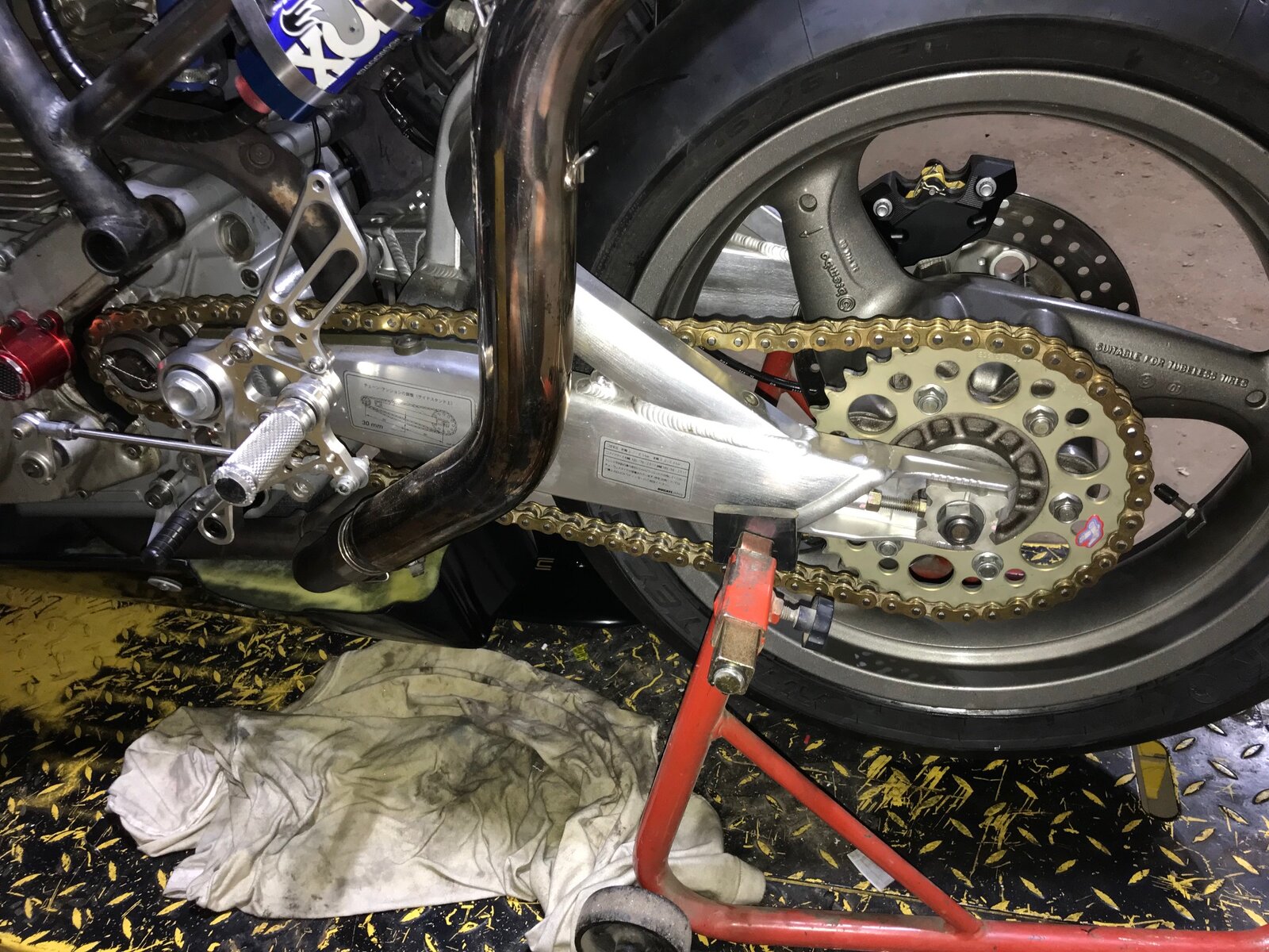

  3. I was able to get the machined countershaft sprocket back from my guy, so I thought I'd post a quick update. There is always something to "do" on a project like this...

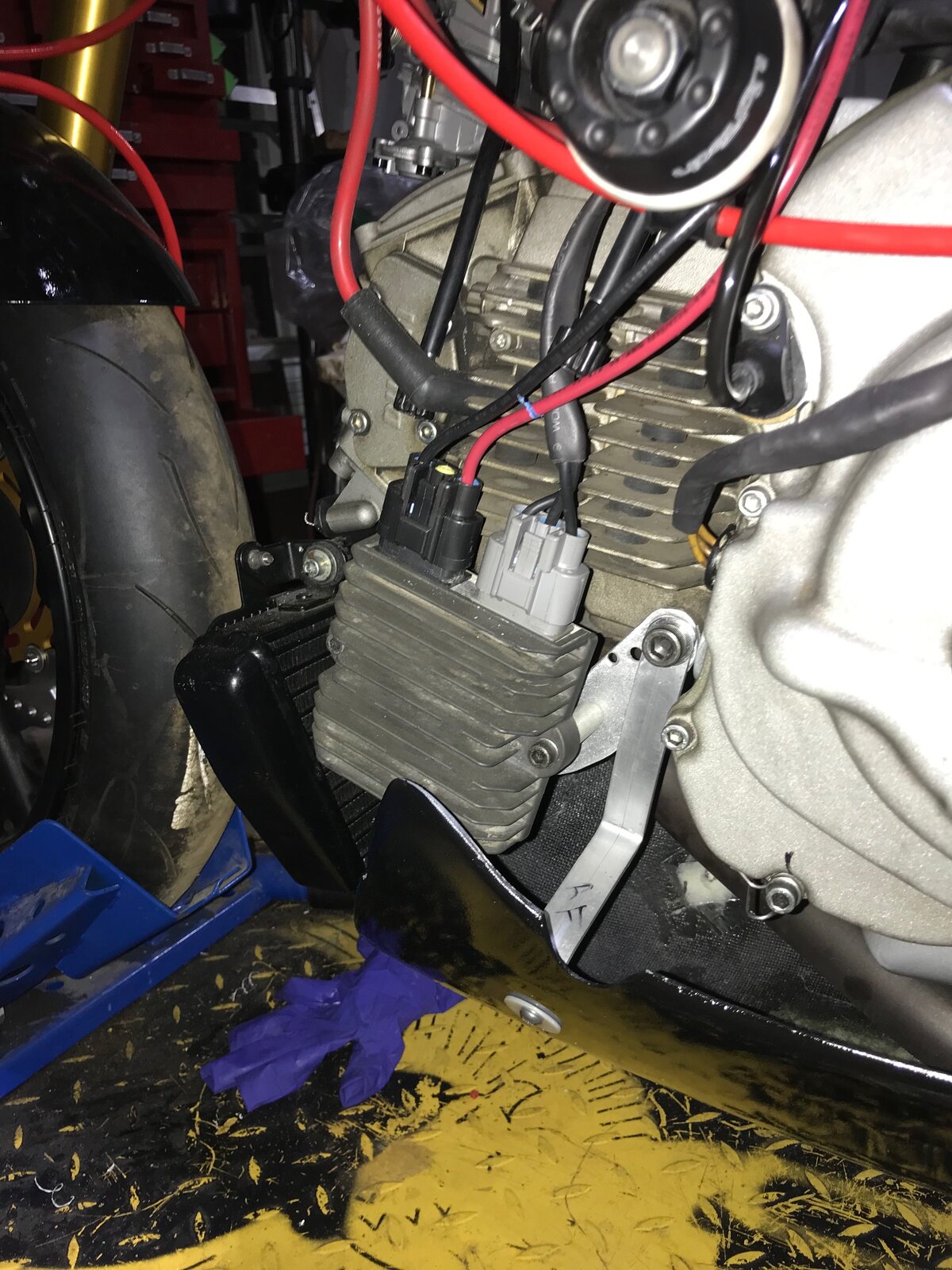

    The eagle-eyed among you will see that I've moved the reg/rec for perhaps the 3rd time. I never liked it up high covering the belt covers, so I moved it again....
    this time, down in front of the case on the left side. It still allows a bracket to mount the bellypan, and this is where the 848/1098 had the reg/rec mounted. It's in the breeze, so to speak, so should stay cool, partly covered by the bellypan.

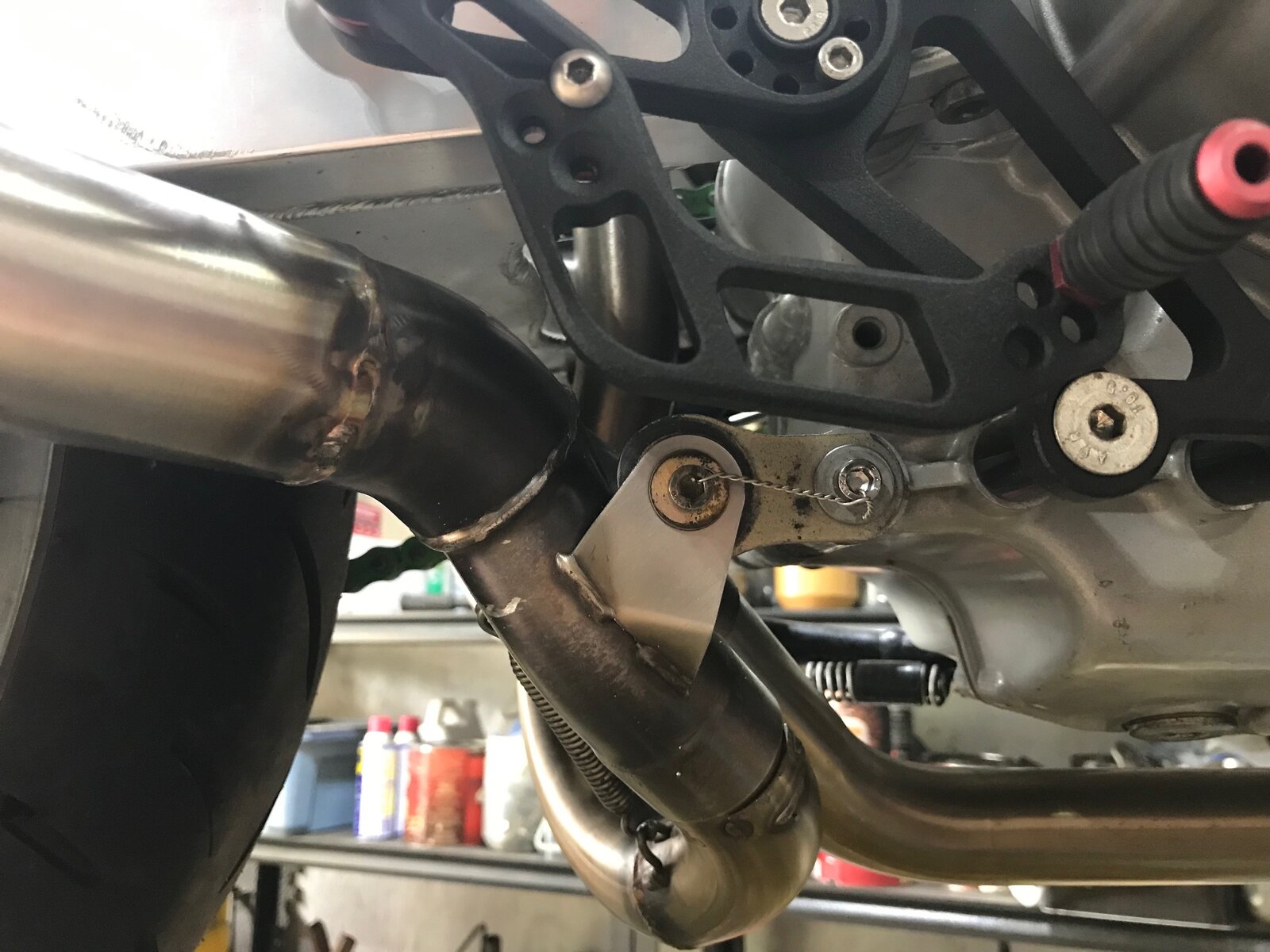

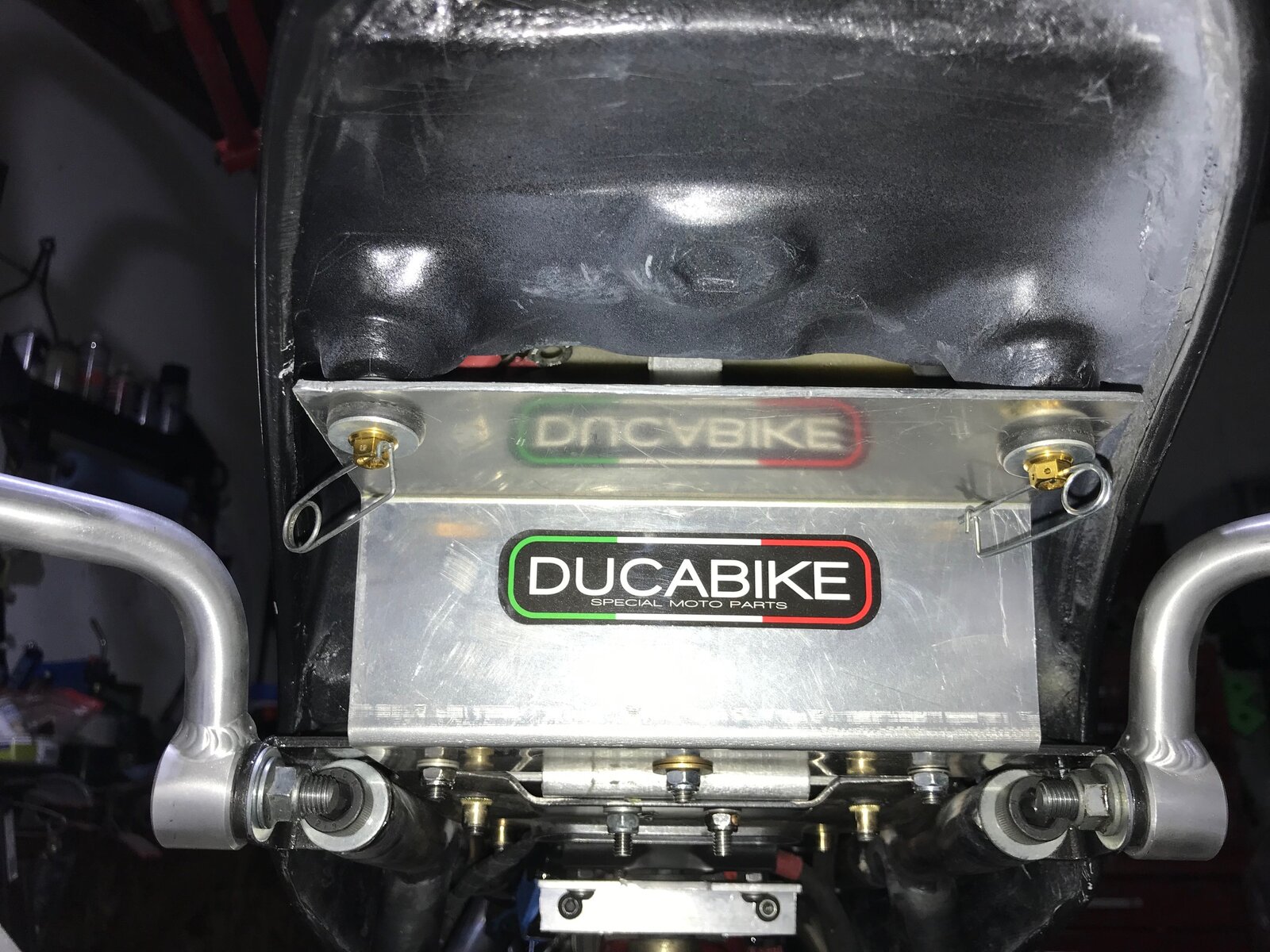

    So I've plumped for a 4 cell antigravity battery, and fabbed up another battery box, tucked behind this ally sheet. Those are drilled titanium bolts that I will secure with safety wire and P clips.
    It was quite the job to machine down the face of the hardened front sprocket, but this allowed the front and rear sprockets to line up perfectly. Depending on the engine and the swingarm, each model of Ducati has a different length of primary drive spline coming out of the case. As I'm fitting an SS swingarm to a Monster S2R engine, the sprockets did not align. Thankfully there was a lot of "meat" on the CS sprocket to remove, and we're only talking 70ish hp here...
    More M5 ti bolts and some safety wire...

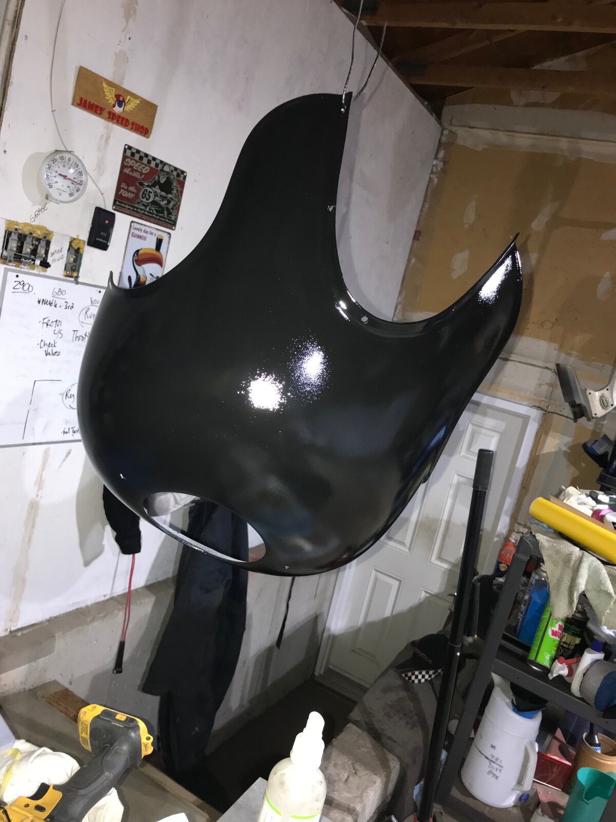

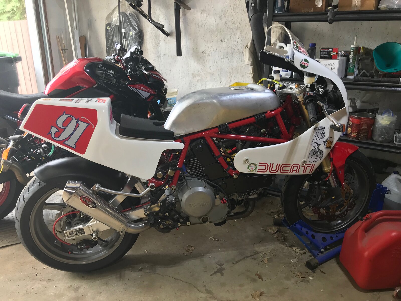

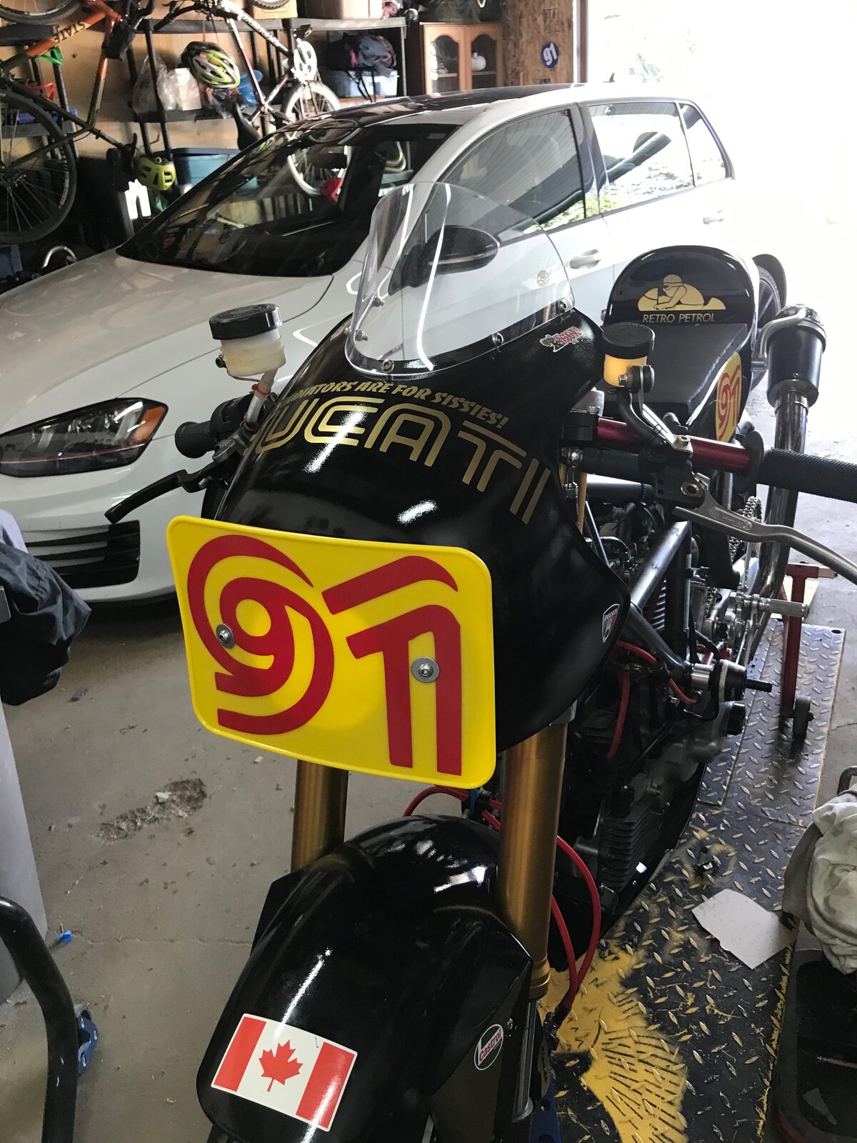

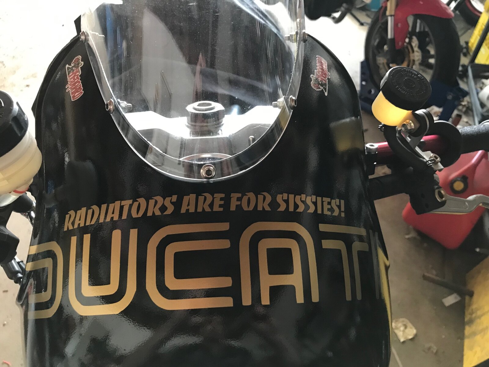

    With some thinking, I realized I had a leftover R90 front fairing and windscreen from an earlier cafe project lying around. It's a shame to leave it unused, and even a bit of a fairing might help, vs. a flat numberplate. Out came the orbital sander, and some primer and black. Once dry and cured, some clearcoat will seal it in nicely.
    I'll cover up the headlight hole with some lexan and use it for numbers.
    Hopefully the fuel tank gets finished soon!

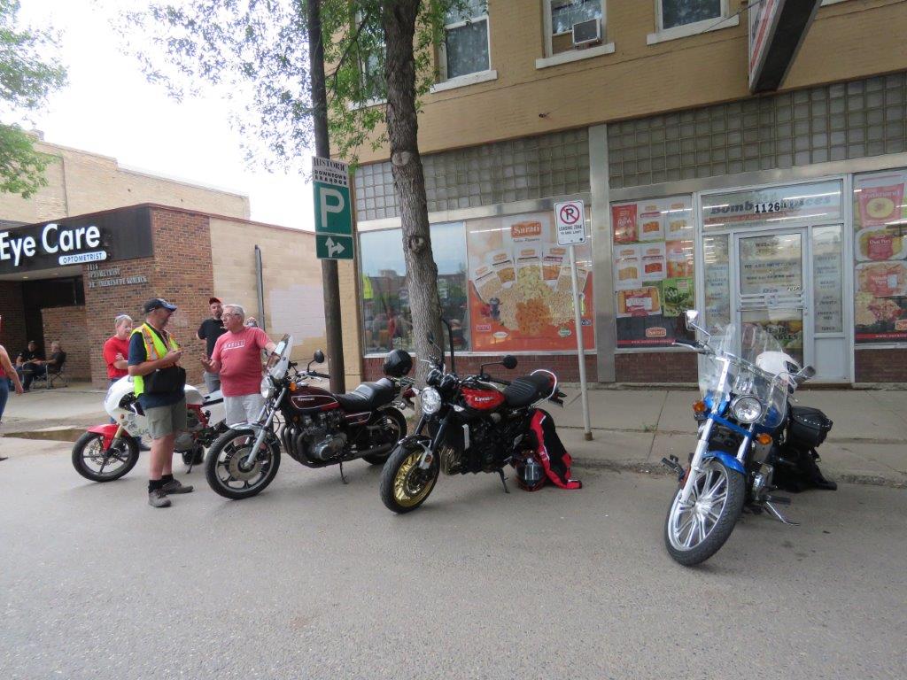

    Photo from the cruise night last week... about 300 automobiles, and around 10 bikes. This is a pic posted to the cruise night facebook page. I'm in the background (in the red shirt behind the safety marshal) trying to explain what the heck the bike actually is. Just out of shot is a bright yellow Ural sidecar unit. A few younger gixxerbrahs showed up, but parked far away from us old fogies. The bike did get some attention, but most folks walked on by. A tough crowd, as there are some custom hot rods with paint jobs more expensive than my entire bike...

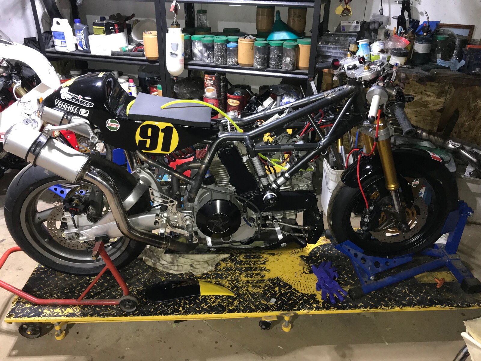

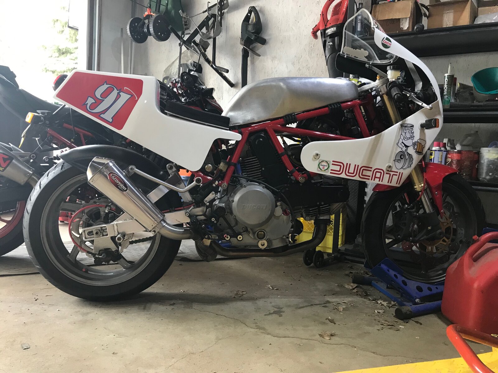

  6. A bit of an update -- I changed the FCR jetting to the recommendations made by Buzzer as a starting point (he's used these FCRs many times). I fired it up with the fuel bottle, as I am still "patiently" waiting for my fuel tank to get modified.
    Health and safety folks will notice the extinguisher bottle close by (there is a second one out of shot). As per last time, the bike fired up with two squirts of the throttle to activate the accelerator pump, and settled into a decent idle. I re-set the balance with the mercury sticks as I'd fiddled with the carbs since it last run.
    Part of what I did in the interim is order Rupert Paul's excellent wiring handbook for custom bikes. I realized I was trying to run a set of 30amp specced wires with too small connectors. Based on his recommendation I got a set of single wire connectors from kojaykat in the UK. They arrived in a very reasonable amount of time and did the trick.
    You can also see the tiny lithium ion battery at the back -- again, fired up the bike with no problems. This whole frame is so narrow front to back that mounting things was a challenge, but I think I'm done for now. Aluminum strap will be replaced with something proper later on.

    The BMW fairing is painted and cleared, and mounted on the bike. I think it will evoke the desired retro vibe!

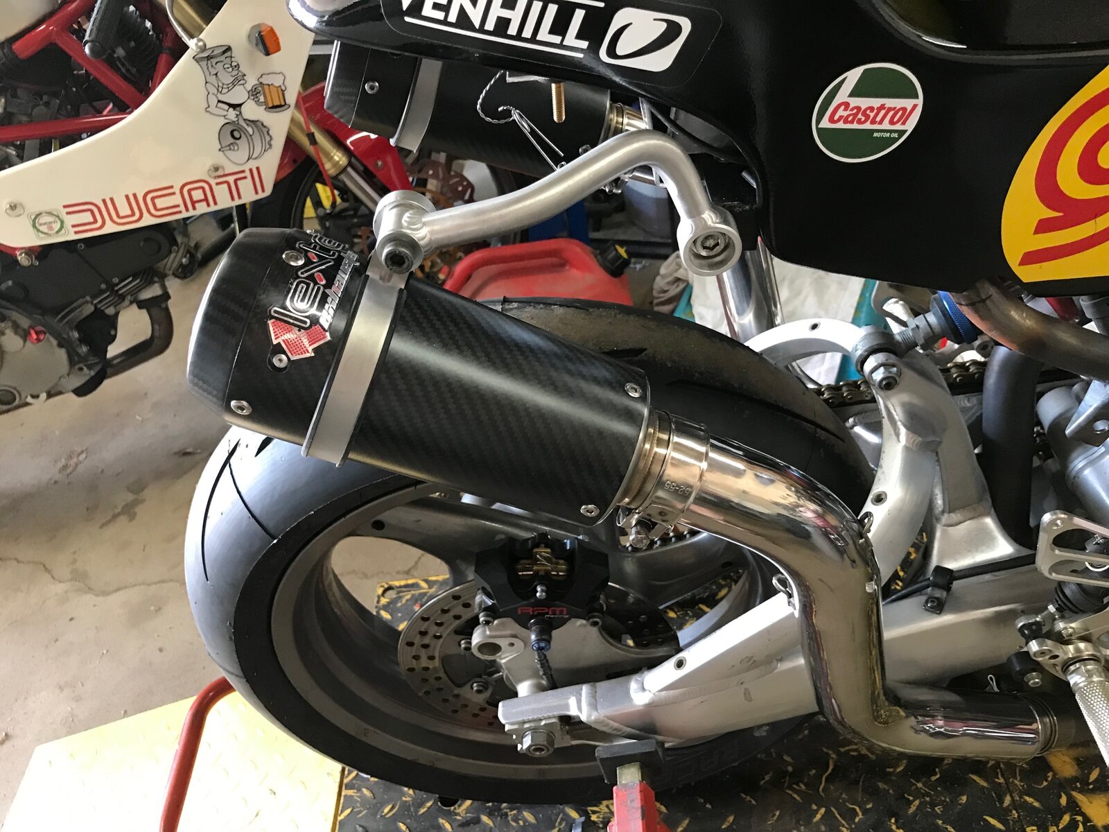

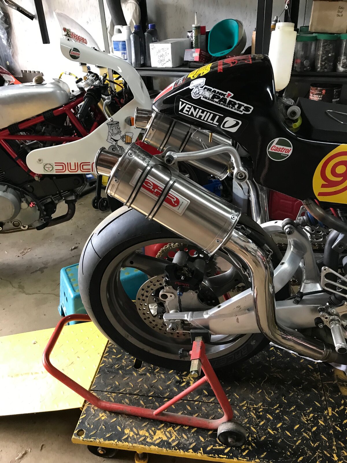

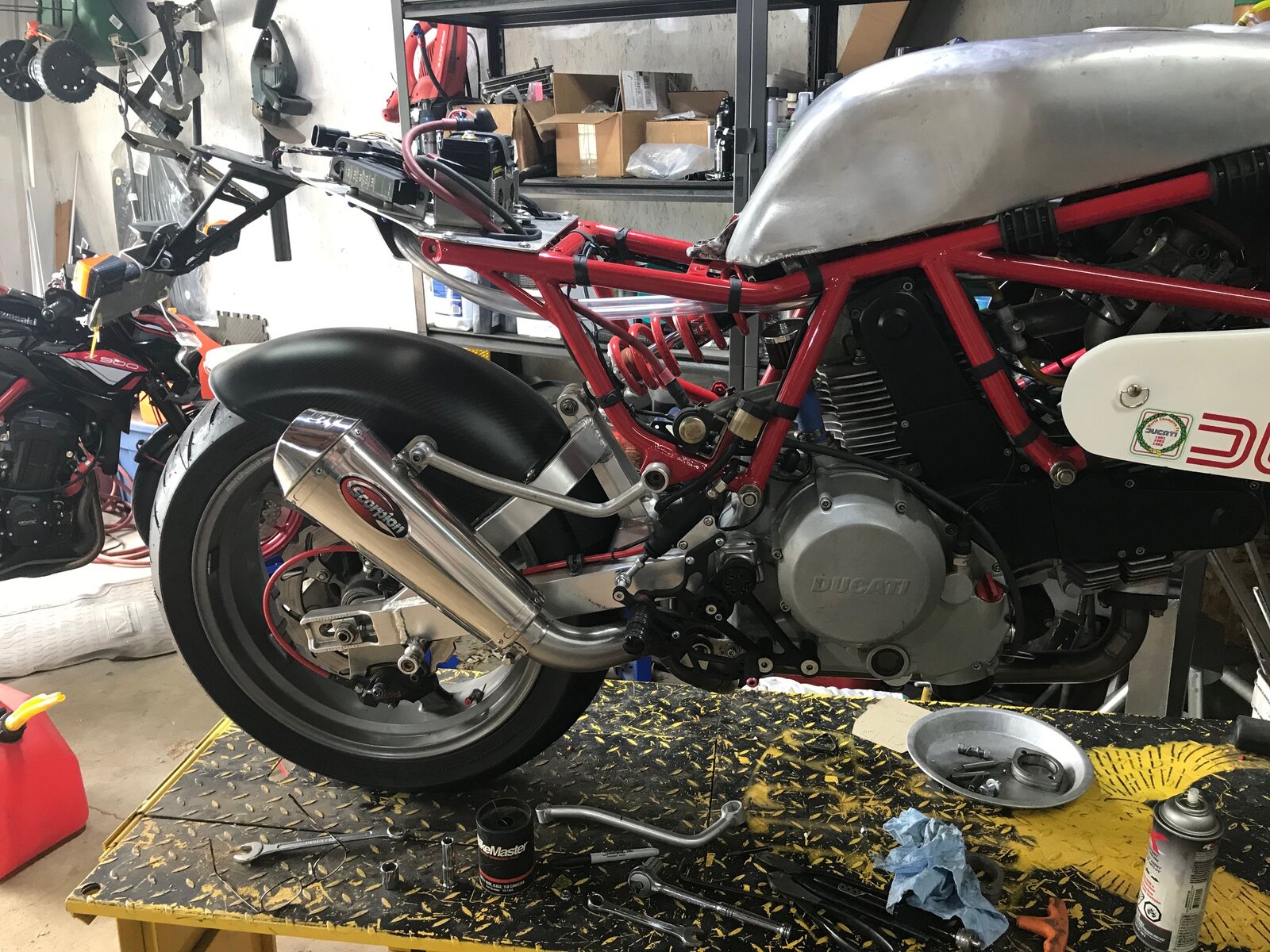

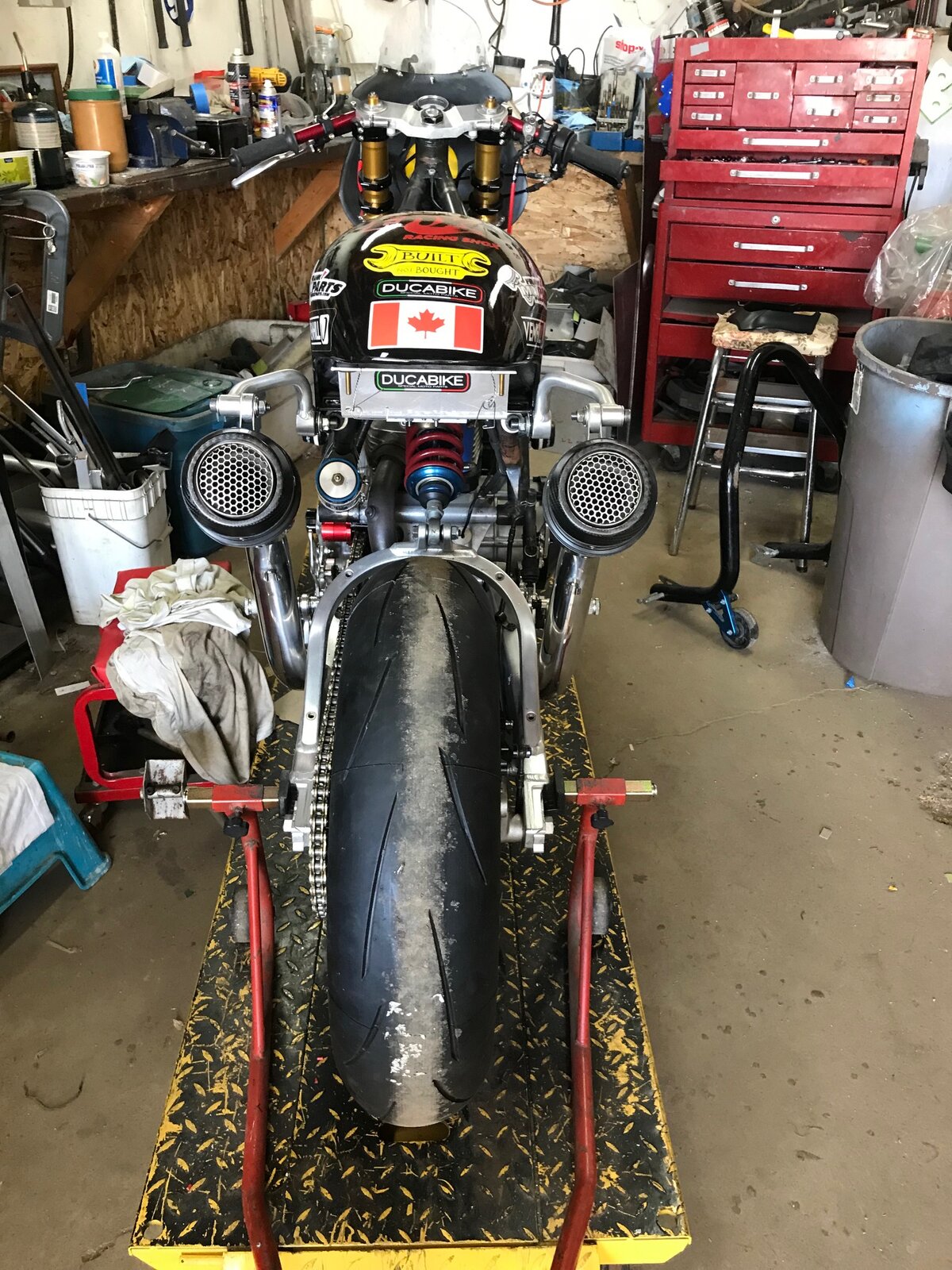

  9. Back to the scrambler project. I was able to get the wee lextek mufflers tweaked to fit on the end of the GPR high mount collectors.
    They don't look half bad, and definately give off a motoGP vibe...
    Noise will definitely be a potential issue, but I'll just have to find some time to fire them up and see...

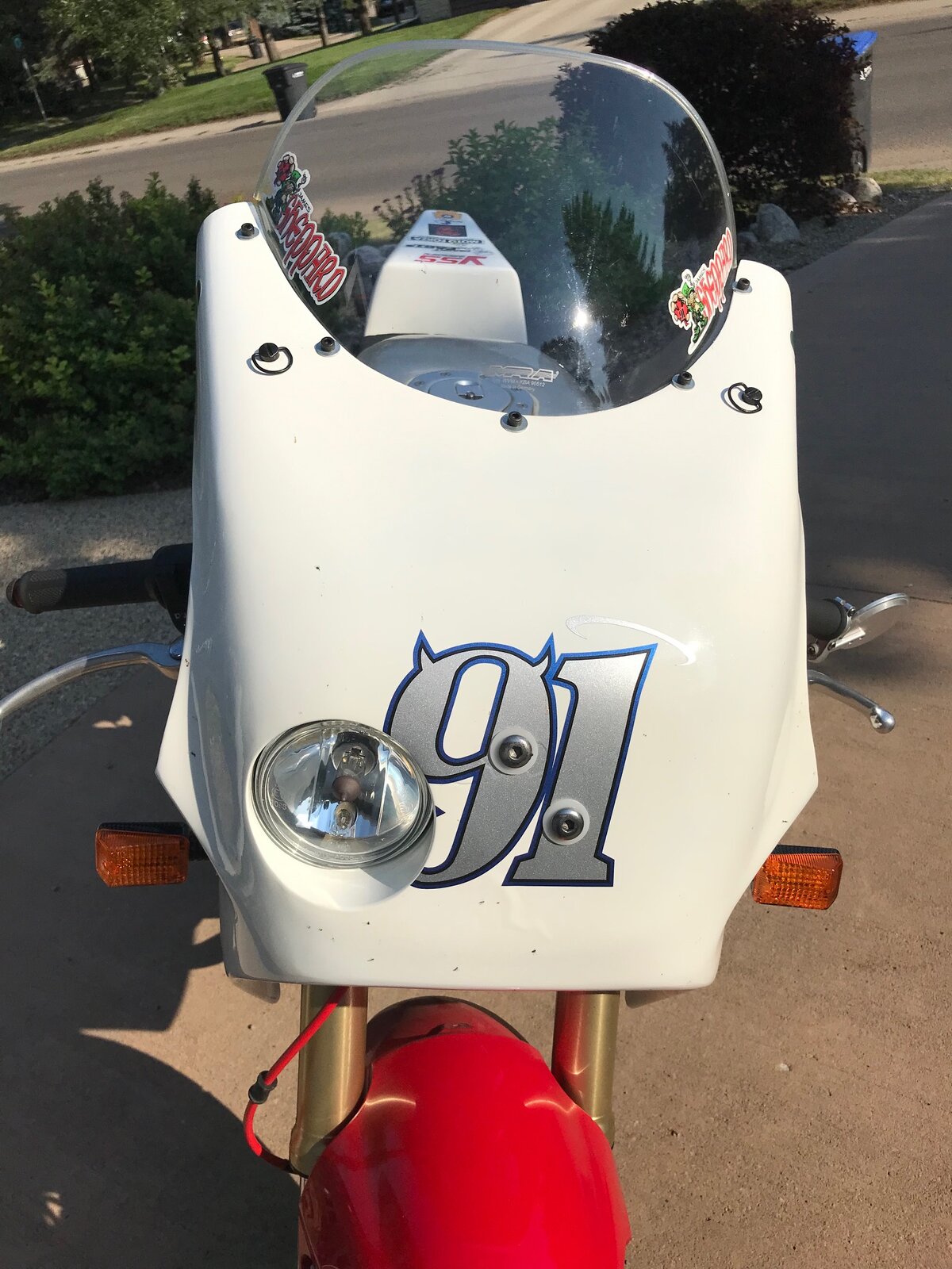

    My 7x9 numberplate came in, and I bolted it to the BMW fairing, covering up the headlight cutout. I was inspired by this:
    Its in keeping with the retro vibe, IMHO. When I fire up the bike, I'll report back!

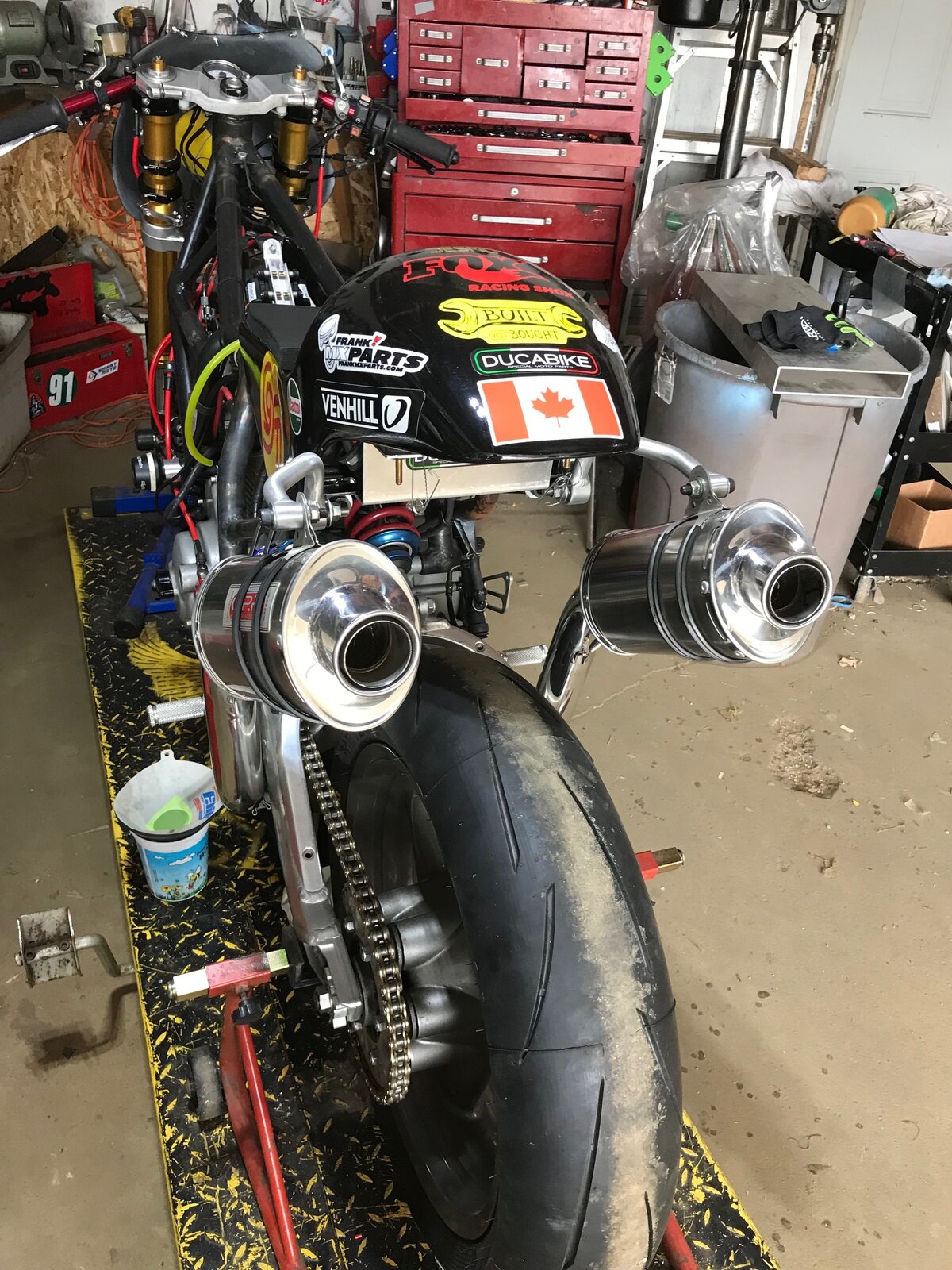

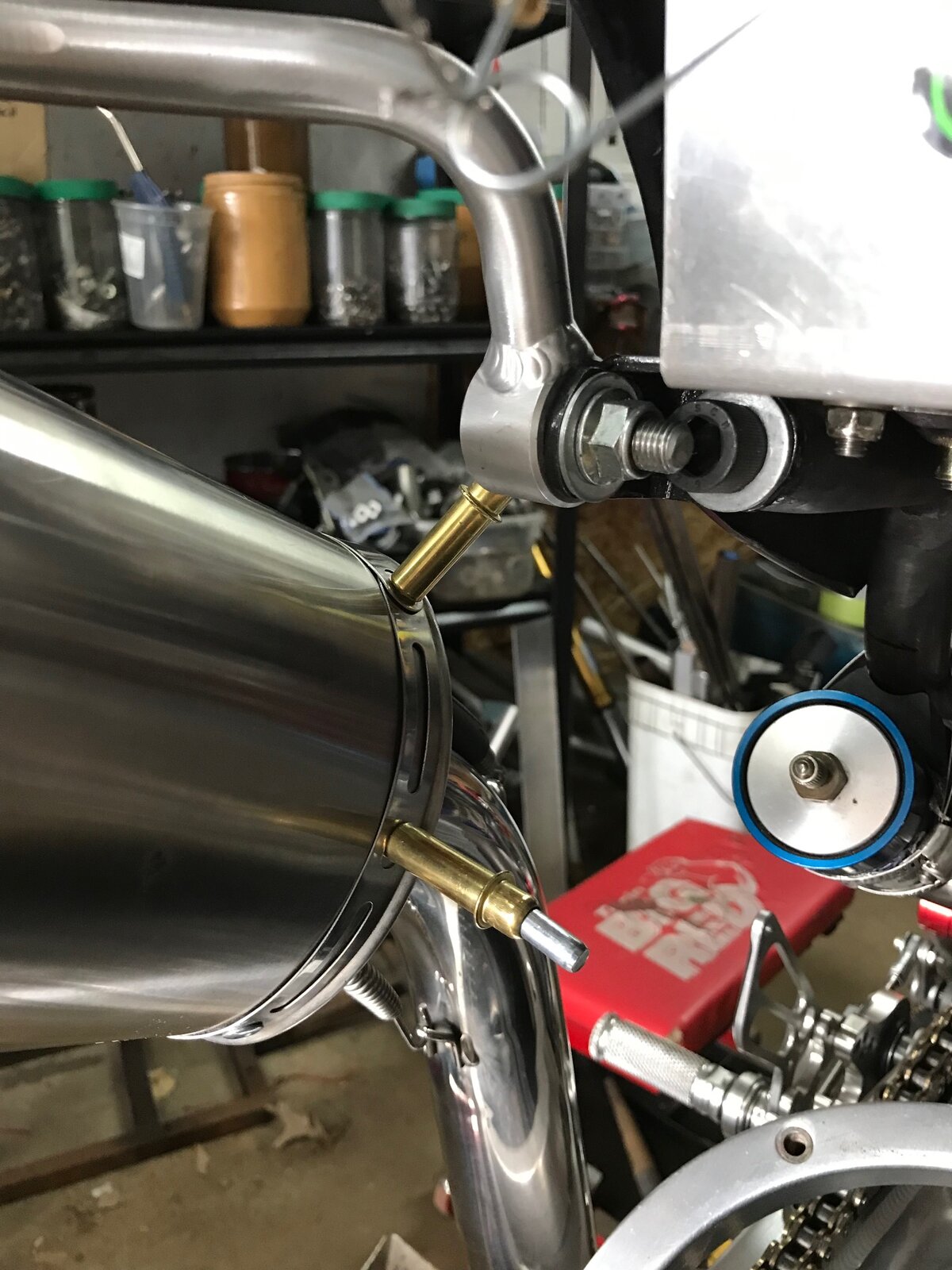

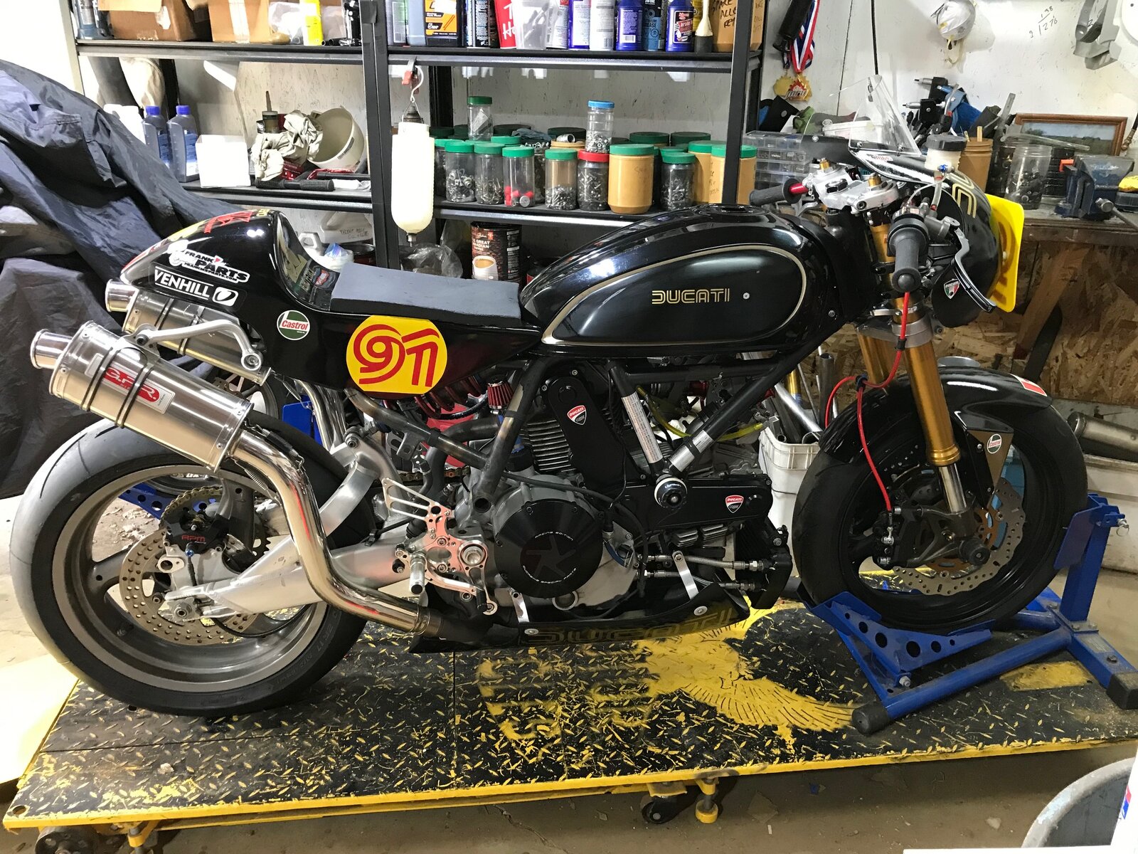

  11. So I gave the stubby lextek mufflers a try, and quickly realized they are simply just too loud. I have no idea what impact they may have on performance, but I need to get along with my neighbors, and preserve my hearing to some extent.
    Decided to have a go at modifying the GPR mufflers that came with the link pipes. The bimota mufflers are great, but a tad heavy and the muffler exit is around 1.5", for some reason reduced from the 2" inlet size. The GPRs are a straight through design. Some careful cutting measuring, and repacking and one is finished:
    To be honest, half the reason I did this is another chance to use my new favorite tool(s) -- clecos!
    These came into my motorcycle building life far too late. Where were they when I was back fitting bodywork???
    Both sides completed. I'll do a noise test when I have time. A few pounds lighter compared to the Bimotas. I was able to re-use the original packing (the mufflers had about 3 minutes of running on them, and only required 12 new exhaust rivets to complete.

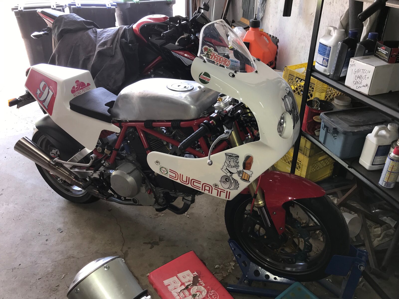

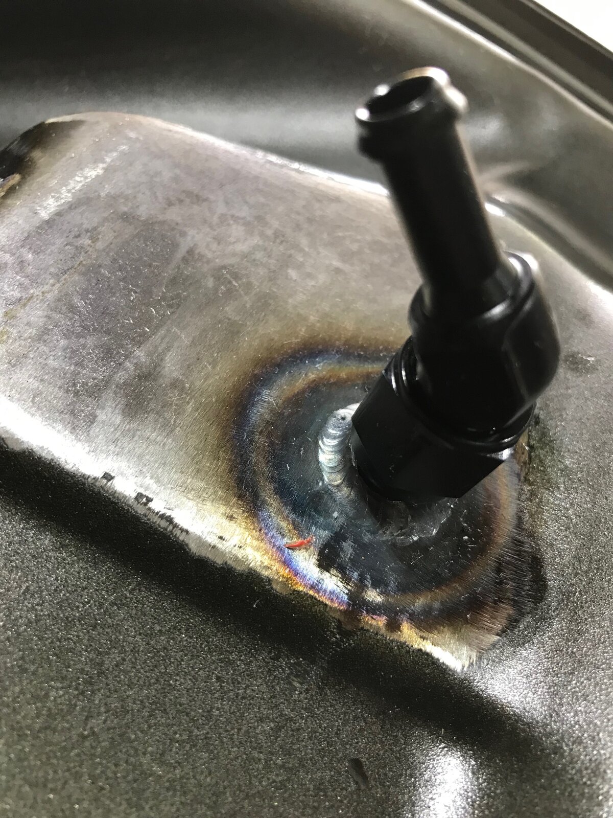

  13. The tank is done! The tank is done! Amazing workmanship from my welding guru. The an-6 bung is billet mild steel welded to maybe 18Ga?
    The hole for the fuel pump was also sealed.
    (Not) surprisingly, where was a bit of distortion to the tank -- the front rubber pads to fit the saddles in the frame have spread out a bit, so the rubber pucks need to be spaced to secure it properly.
    With the tank on, and fuel hoses connected, it was out for a short and highly illegal test ride. With the velocity stacks, the bike was running lean on low throttle, so I went from a 48 to a 52 pilot jet. Now it's a bit lean in the low-midrange, so I'll raise the needles up for the next test ride.
    To say I'm excited is a bit of an understatement. From bare frame to running bike in less than a year of evenings, weekends, and summer holdiays. Still a lot to do, but a huge step forward this weekend!
