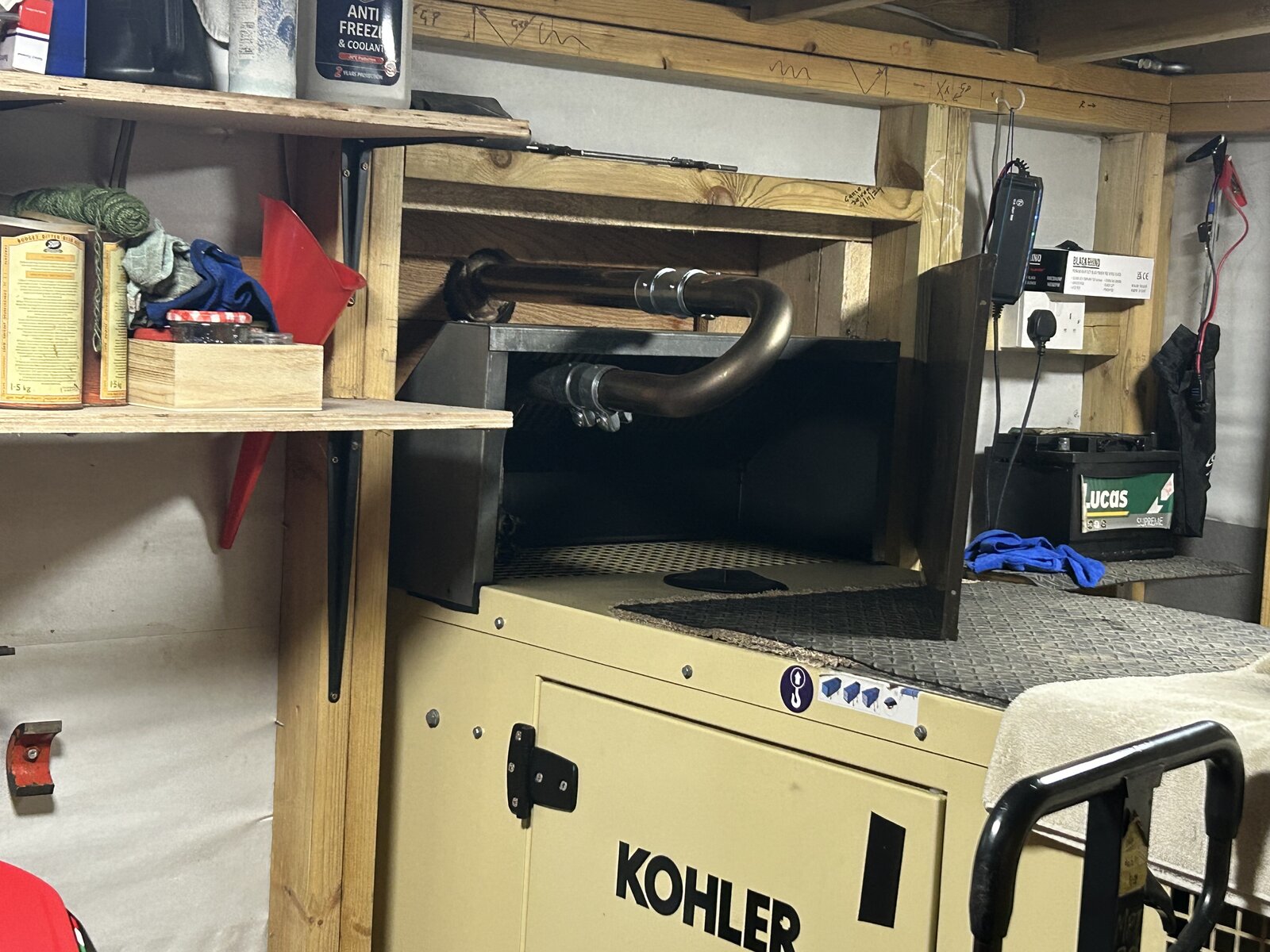

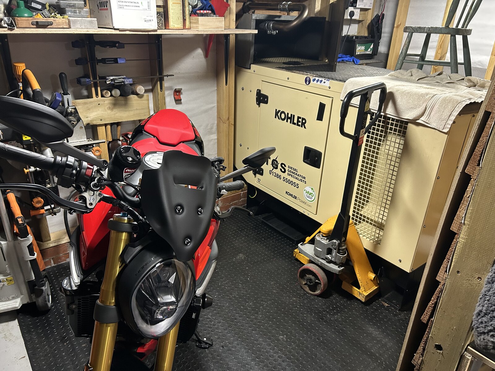

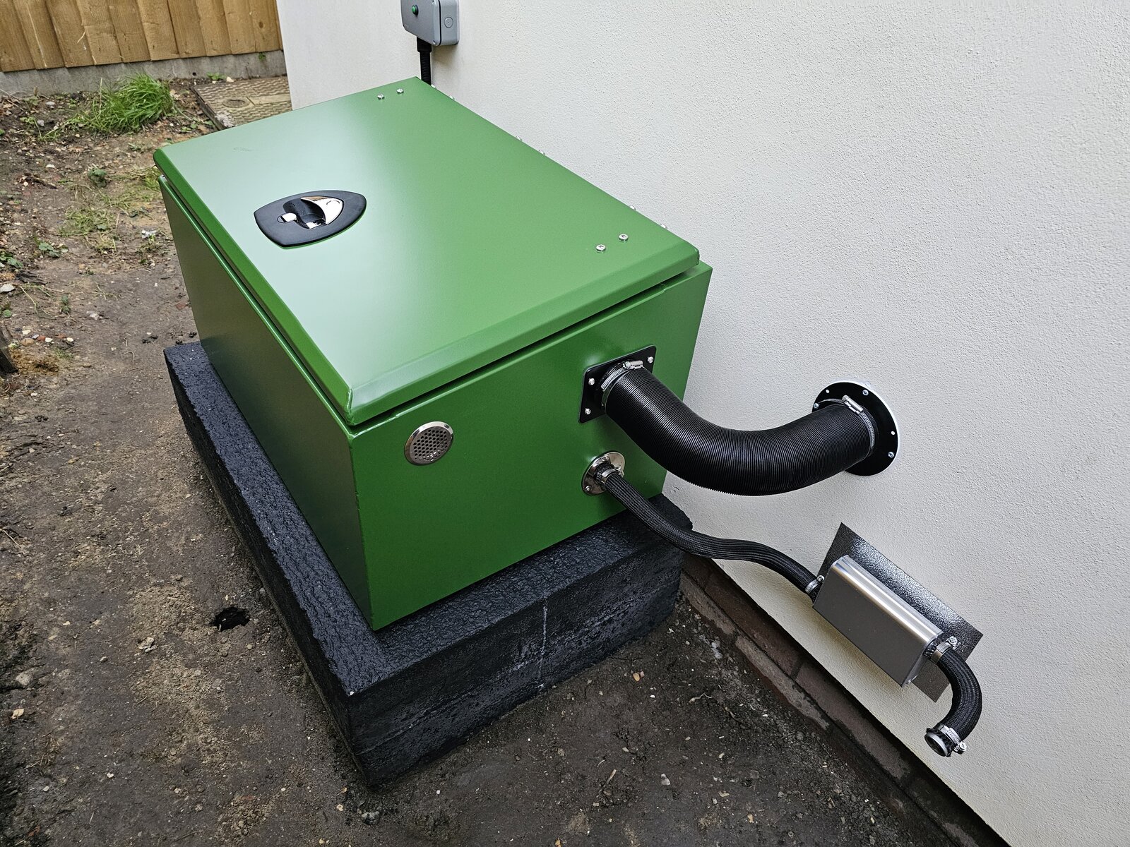

  6. My Frankenstein diesel heater set up takes care of the temperature, though I am fortunate that the garage is also damp free. Unlike my previous one.
    • Like Like x 8
  7. Nearly as fancy a set up as your bike :upyeah:
  8. Almost. Took me six months to design and build it. Has been run for over 400 hours now without a hitch, though it will require a stripdown and service in the spring. I've used around 133 litres of fuel in that time so around £200 over 13 months which ain't bad.
    More info here, if you want to set up something similar for yourself: https://www.ducatiforum.co.uk/threads/turning-up-the-heat.94234/
