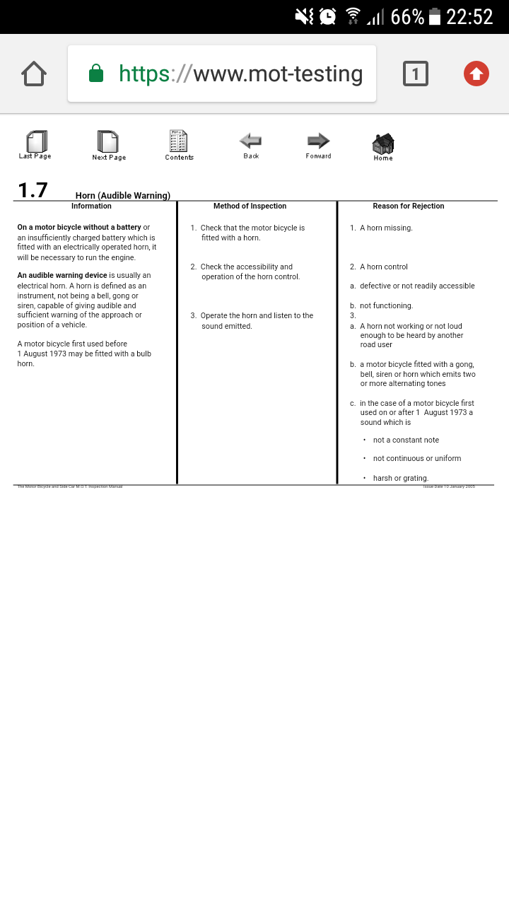

  1. So that's another for no Reflector needed - just the horn to decide upon?
  2. I tried posting the page but it won't down load, bit it's easy to access the class 1 mot Manuel.
  3. its not actually called a day time MOT, or any thing else come to think of it. The mot certificate is actually a normal one. Its just a case of if the lights are there, they must work. If they are missing, its not a fail.
  4. I ran a 916 and 999 for year on a "Day time MOT"
    Its just an advisory "No lights fitted at time of test"
    No Horn is a fail
    Thinking about it I have no reflector on my Pani and thats never been a problem. So I think it must have a horn regardless
    Found the page
  8. You can find any answer you want on Google :thinkingface: so I asked the guy who will be passing my bike :yum
  9. I've just read my Manuel and must admit if bike has no lights and is only used in day light hours NO reflector is needed. :upyeah:
  10. Do basically bang the horn on and your ready to go .
  11. Cool, I will ask about the horn again :):upyeah:
