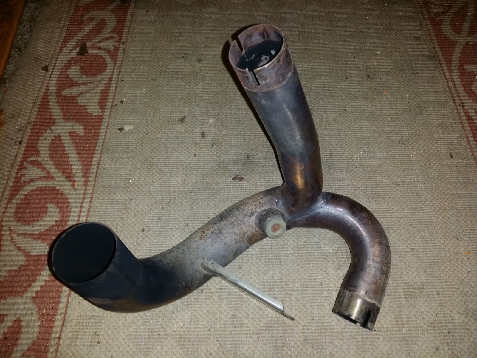

  5. IMG_20150203_214000.jpg You wont have to! - the decat comes with an o2 sensor option (the Danmoto one does anyway) so when you take the cat out and put the decat in - you can re-attach the sensor. Here's mine - note the o2 sensor down at the bottom of the pipe - mine is blanked as mines been dyno'd.

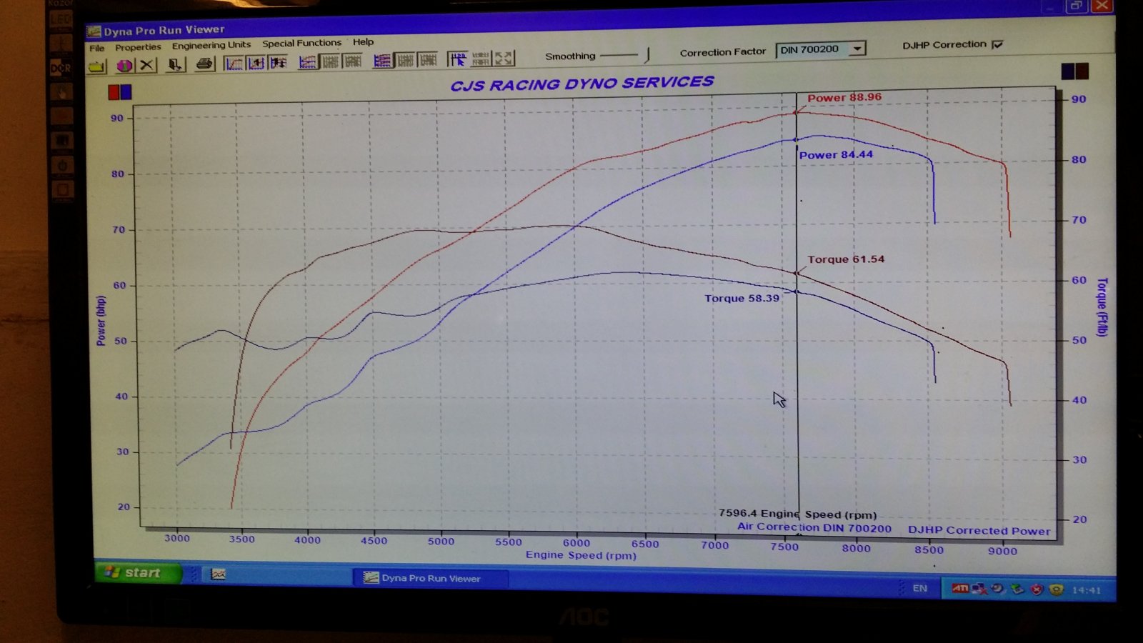

  10. Yes - that's the best way but to do that you need to get it to a dyno operator - if you take it to a good one they will delete the o2 sensors from the ecu - that way you wont need those eliminators then....believe me - this is the best and most cost effective way plus youll get a lot more performance and fuel economy from the bike.
    Here's mine. It is without doubt the best thing you can do performance wise for the bike. Ive just changed my front section so it will be going back again in the near future.
  11. Totally agree, deCAT+remap+dyno set up = a Happy Hyper

  19. As posted previously in the thread, after doing the usual mods the £350 spent on the remap/dyno tune is the best value £ per difference mod I've done in 40yrs of riding. It totally transformed the way bike rode, much smoother low down, far more mid range pull, uses less fuel, what's not to love ;)
