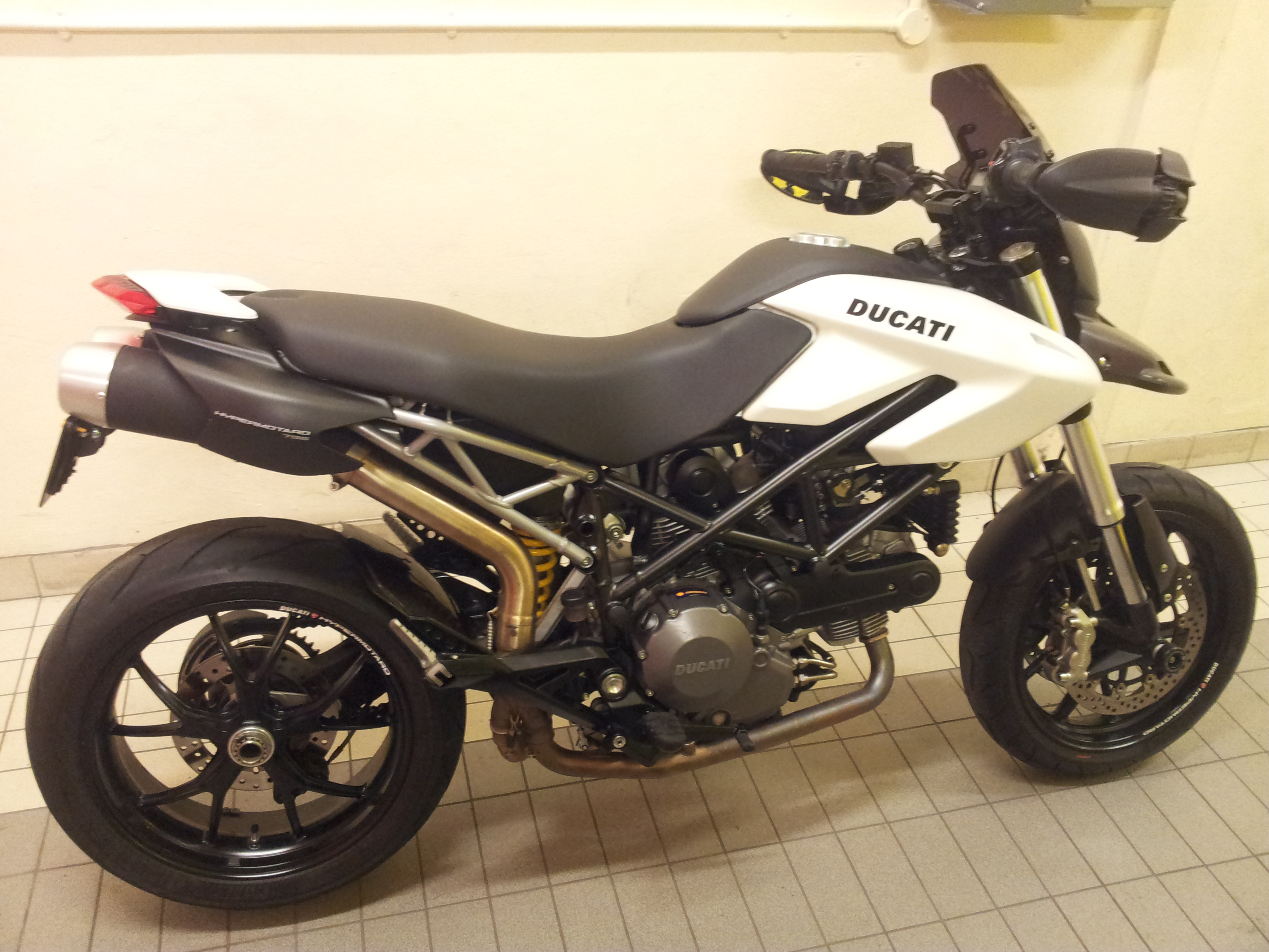

    I have the standard tail pipe with just the decat on there.
    I think yours is a 1100 with tail pipes otherwise I would be considering it :)
  3. Ah yes....didn't see that....didn't see the rest of thread ( replied on my tiny phone screen )!
    Standard pipe! - you need to start modding my friend!!
  4. I want those bar end mirrors!! Do u have the blinkers?
