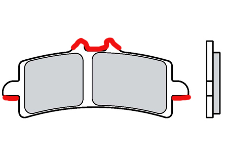

  13. A Mechanic advised me to add a tiny bit of grease where it touches the caliper and shim to stop squealing (as well as the back of the pad - which he said does nothing). I've marked this in red, but be very careful not to get any on the pad or disc.

  16. Make sure its Copperslip not just any normal grease.
  17. Rick B is right, but regardless of the grease you should only apply copperslip to the side edges and never to the top of the brake pads. Even though copperslip should not melt and run onto the face of the pad it is still possible for it to migrate it's way from the top to the bottom in certain circumstances ... gravity is a bitch like that.
