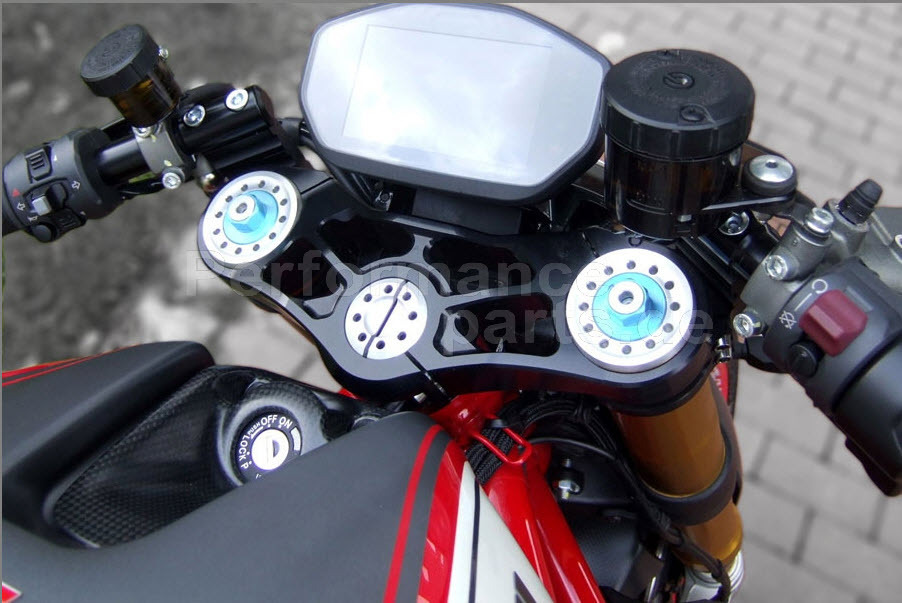

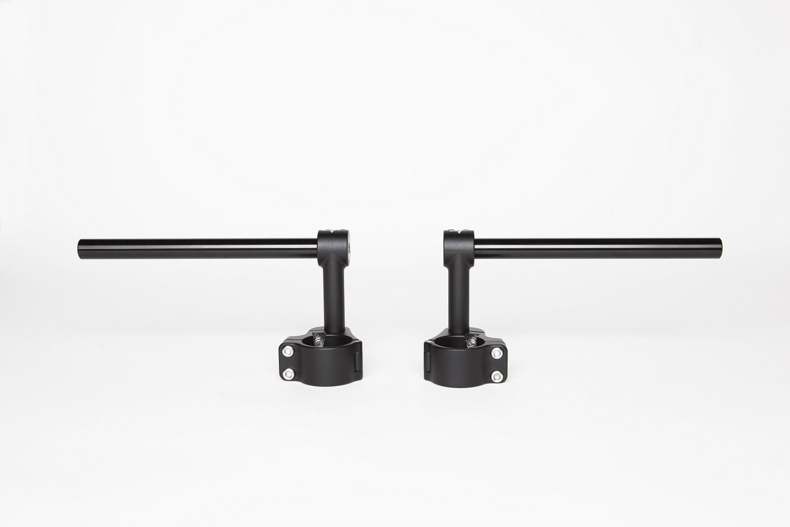

    I am considering asking Santa for these, would appreciate any thoughts/alternatives (they're pricey).
    --it's always been my intention to fit clip-ons, I am not too much of a fan of the riding position being almost sit-up-and-beg on my 1200 but the bike is a dream realised - hope I don't offend anyone with this :-/
    They appear extremely pricey at around £500...........
    http://www.duc-store.de/epages/15495490.mobile/en_US/?ObjectPath=/Shops/15495490/Products/LS.PP.MO12
    .................especially when compared to this model from the US which unfortunately they don't make for the Monster, a shame at that price and the option of mounting them above or below.
    https://www.ebay.co.uk/itm/292660422623?ul_noapp=true

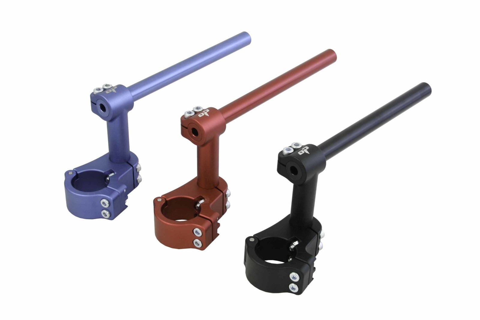

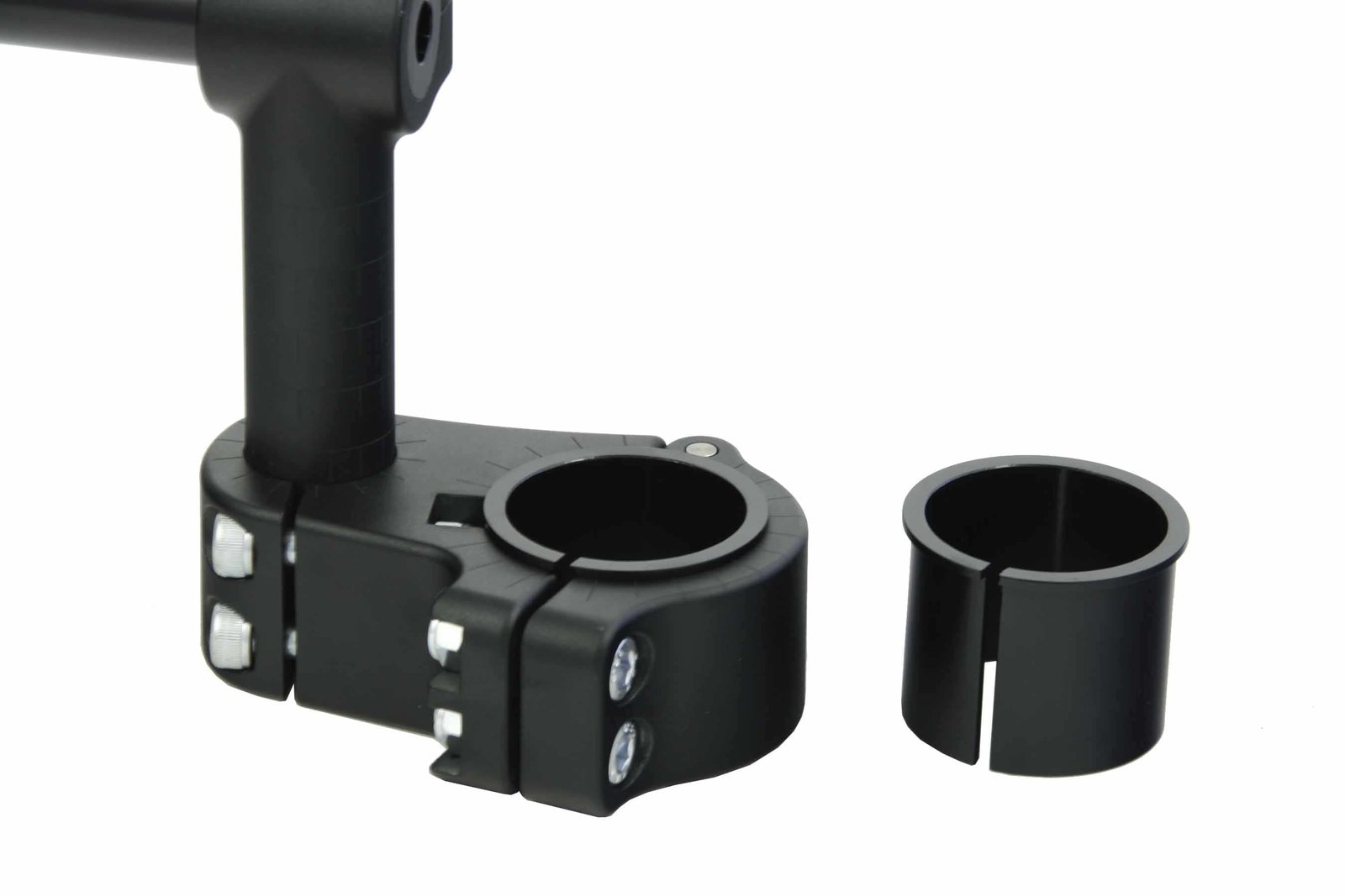

  8. Hi everyone,
    After much more research, I have decided that hinged or split clip ons that are also adjustable in height. This allows me to experiment with the fitment without removing the triple clamp and taking my bike off the road while I find the courage to fit them myself :) --I am pretty sure about doing it myself, I can take my time over winter and it shouldn't be too hard, right :-/
    There are plenty of clip ons with a quick Google search, but none that I can find from reputable vendors, that are adjustable and are split/hinged.
    Ebay I can find some, and they are as cheap as chips, and I am not so confident I could trust them!!
    Here is a vendor I would be happy to buy from, they are $350 which seems a lot, but I am reassured by the video and the materials and claims they make regarding life time warranty...
    https://onpointperformance.com/product/adjustable-clip-on-handle-bar/
    I would appreciate your opinion.
