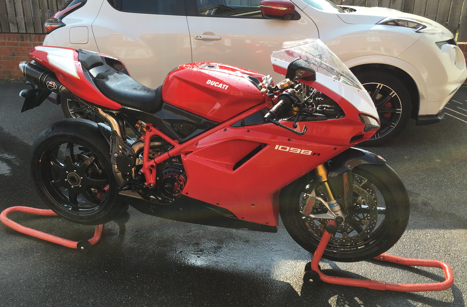

  13. I've got front and rear paddock stands :thinkingface: Do I have to put carpet under them? :worried:
  14. Think you have to double carpet for paddock stands Robber !!! o_O
  15. Or an onion under the bed supposedly helps.
  16. :bucktooth::bucktooth::bucktooth:
    If that was mine there would be carpet under it for the winter paddock stands or not ..purely because it would be in my front room ..

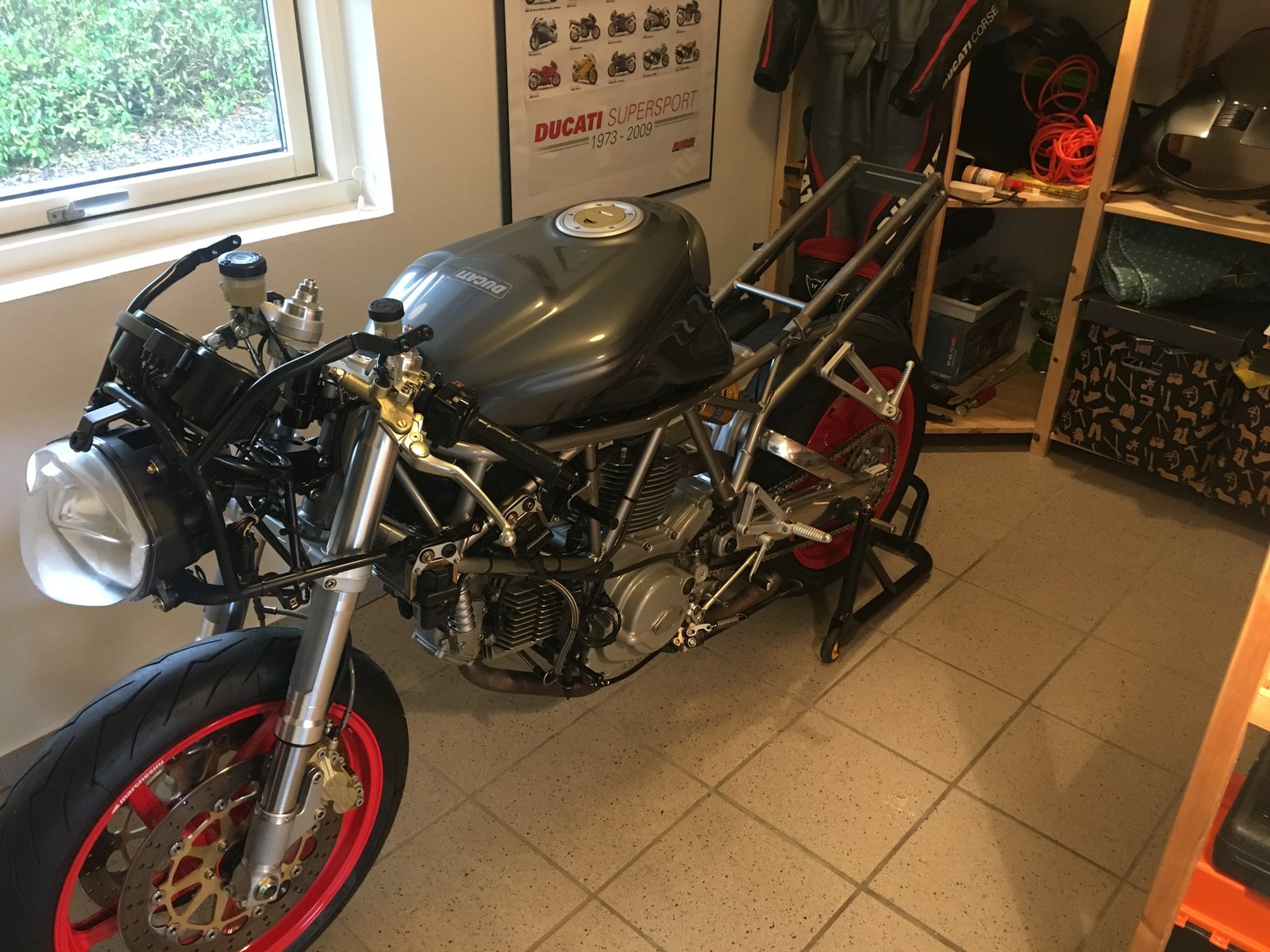

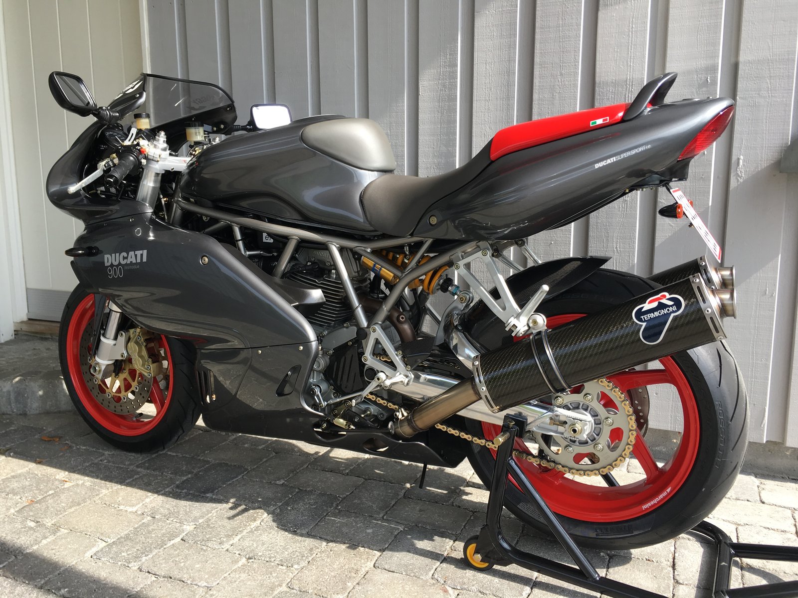

  17. I use ACF50 extensively. I have never had any issues other than a 15 year old DUC looking like new (more or less, at least).
    After each cleaning of the bike I wipe the whole bike over with a microfibre cloth “soaked” in ACF50. So it always have a coat of ACF50 on. Keeps everything looking like new, and all plastic etc. stays fresh looking. Of course all the nook and crannies are the most important areas to pay attention to.
    I’m fortunate to have a dry warm room for the bike during the winter, but still uses ACF50 to preserve areas I have cleaned. I never ride in the rain, but moist in the air will make screews, bolts etc. look matte and eventually rusty, if not preserved in some way. Especially the dodgy painted welding joints on the frame is prone to rust and I use ACF50 to assure that no rust will never form.
    I use ACF50 on all electrical connectors as it keeps them from corroding internally and keeps moist at bay.
    Lastly, I wipe my chain with ACF50 after each ride, and it keeps the chain looking like new with no spray from sticky chain lubricants. As I use an O-ring chain, it mostly needs to be prevented from corrosion on the outside of the links, for which ACF50 is perfect. To my understanding and experience, ACF50 does not dissolve other grease as WD40, and hence is safer to use, in case it does get into the O-rings and in contact with the grease inside the links. But that is my own little theory.
    In my experience, the ACF50, if applied with a cloth and not sprayed on excessively, does not make the bike sticky, oily and does not attract dirt in an extreme fashion.
