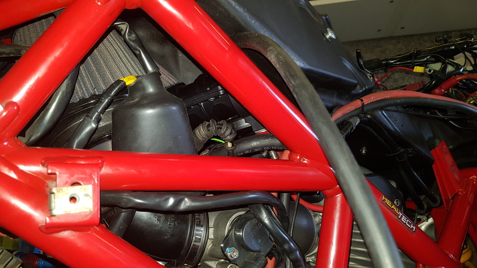

  1. Very generic but if you're running air filters then there's a shed load of space where the airbox went. I've got one of these on my zed and it's fucking brilliant....about 6 months ago I was travelling over a roundabout by my house...I bloke in a car drove onto the roundabout knowing I was there, on the phone also and even had the fucking cheek to wink at the same time...cunt...I pressed the horn which gave out a feeble " meep "....So bought the Soundbomb for my zed....another unfortunate driver kind of did the same....cue freight train style horn...so...wondered if I could fit one to the hyper...turns out...you can...right next to the air filters...under the tank...!

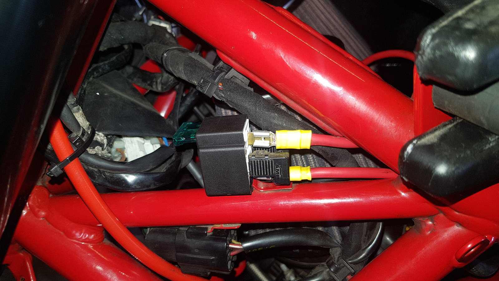

    I put the relay here...
    Which has a built in fuse you can get to easily, and unplug easily to if it needs to be replaced...I look forward to scaring someone shitless tomorrow in rush hour traffic...

  5. If anyone is wondering about wiring its dead easy....if you put the relay where i did you unplug the old horn and and plug into two of the 4 pins of the relay. The negative on the horn goes to the frame. The positive from the horn goes to the 3rd slide connector on the relay and the 4th slide connector on the relay goes to the battery...easy...

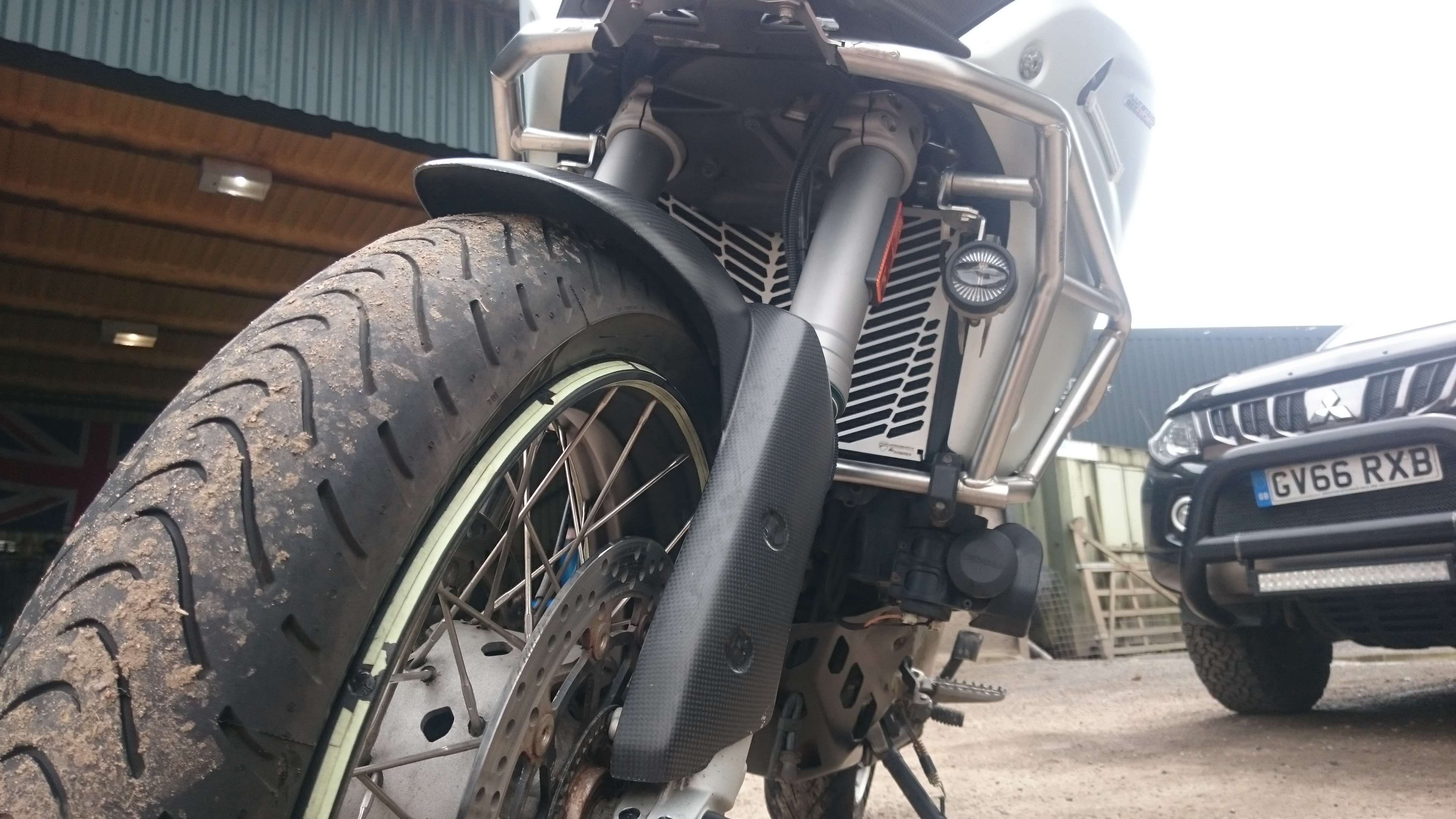

  6. I fit one to the KTM.
    Had a car driver try joining my lane on the motorway. I held my horn and he didn’t react at all. I had to brake and tuck in behind. When I undertook and gave a finger, he clearly had no idea what he’d done. I checked my dash cam footage and I couldn’t even hear the horn on there. Ordered a Denali straight away and it’s great. Will be going on every bike.
