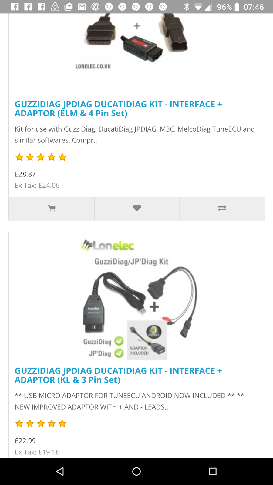

  4. Is it the 3 pin cable below? The one with the adapter leads? Screenshot_20181022-074626.png
  5. Bottom pic. Fiat adaptor with red/black fly leads
