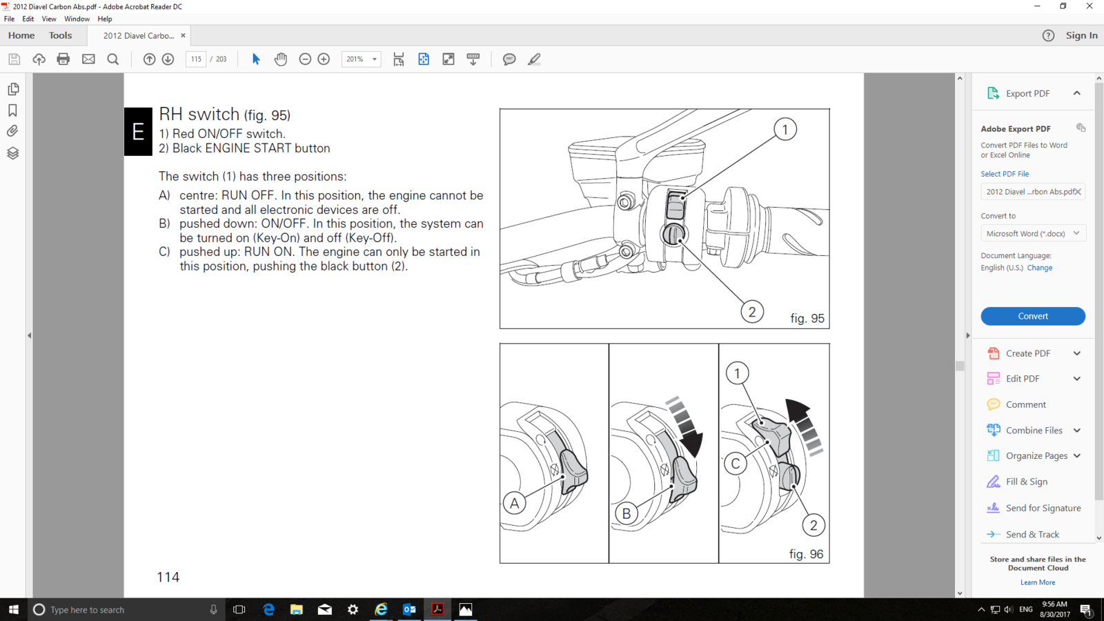

  12. Are they sticking in the position that wake's the bike up? If so I can't agree, as after fitting my new part it always returns to cover the start button as it did before it started to jam.The book refers to three positions but position b you have to hold down as when released it should return to cover the button as mine did when I first had it and now I have fitted the new part
    #13 Paulo61, Aug 30, 2017
  13. There are three position for the switch on my Multi, two stable and one unstable.
    1. All the way up (stable)
    2. Most of the way down, covers the button (stable)
    3. Most of the way down + a little bit more (unstable)
    I am assuming the Diavel is the same ?
