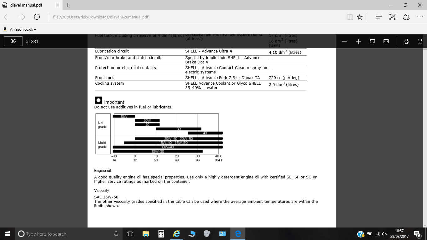

    The manual says,just Shell which lead me to put a post in the "Technical help" thread to get other peoples general cencensious,
    #23 Rick B, Aug 28, 2017
  4. Does it? I cannot see the word Shell for the engine oil. It gives the viscosity and the SAE grade and "A good Quality oil".
    There is no such thing as Diavel oil, everyday oil, not so good oil etc. All the oil does is keeps two bits of metal apart, and the oil has no knowledge of what bike those bits of metal belong to.
    So all along the answer to your question was in the handbook.

  8. The recommended oil is Shell Advance Ultra 4 (fully synth) - nothing wrong with it , I use it
  9. Bob, It says at the top that Shell Advance Ultra 4 is the recommended oil for the engine lubrication circuit.
    This is a motorcycle-specific fully synthetic oil.
    They then say that any good quality. similarly specified oil will be fine.
    So yes, the answer is in the manual as you say: use a good quality fully-synthetic motorcycle-specific oil.
