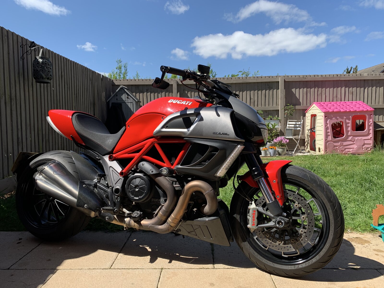

  1. So got the panels off and swapped out the ecu, no joy….
  2. Reconnected the battery, tryed the centre button, lower dash kit up and showed the switch not in lowered position warning, then nothing( I took apart the right hand switch and cleaned the contacts beforehand).
    Cannot replicate it now, so contacted Ducati Coventry, and they will come and get it early may, the technician suspects a faulty hand free unit.
    will post an update when it’s had a diag done.
  3. Spoke to Ducati Coventry today, They found and fixed some broken wires by the keyless unit, but they still cannot Power the bike on.
  4. Ducati Cov got back to me today, starter relay changed, bike is back up and running, pick it up Thursday.
  5. Bike picked up from Ducati Coventry, great service and you can tell they love what they do.
    Nice ride out tomorrow me thinks!
