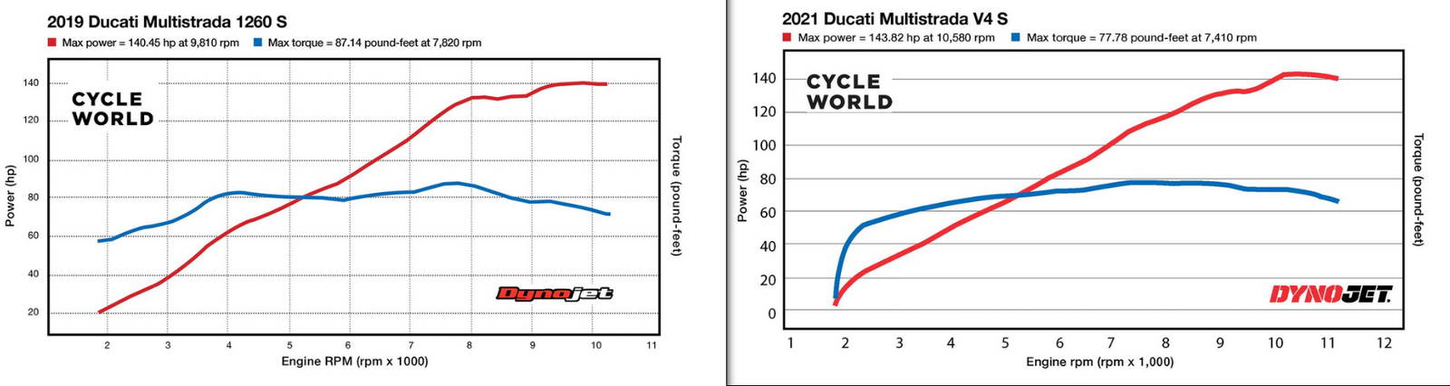

  5. It took me awhile to build this table although a torque version would be nice but the spoiler alert is that the 1260 V2 87 ft-lb torque just tramples the V4's 77 ft-lb anywhere along its curve as to be expected from a twin. RS dyno'd torque figures are unfortunately nowhere to be found.

  8. Unfortunately, the torque data was not available from BHPUK which is where I extracted the HP figures for all three bikes. What's important is using the same dyno for comparative purposes. There's always discrepancies between dynos in absolute terms. I'm not disputing any other dyno figures which may yield higher numbers but all three bikes (1260, V4, RS) must be tested using the same machine.
    Consequently for torque, (using the same dyno) we can observe the torque difference of (about 10 ft-lb) in relative terms produced by Cycle World.
    The 1260 V2 numbers are absent from Captain's post. However, we can reasonably infer the following torque figures using the dyno he presented as follows:
    V2 @ 98 ft-lb,
    V4 @ 88 ft-lb,
    RS @ 80 ft-lb

  16. With all due respect, why don't you look at the torque curve comparison in post #48 and then tell me which is flatter.
