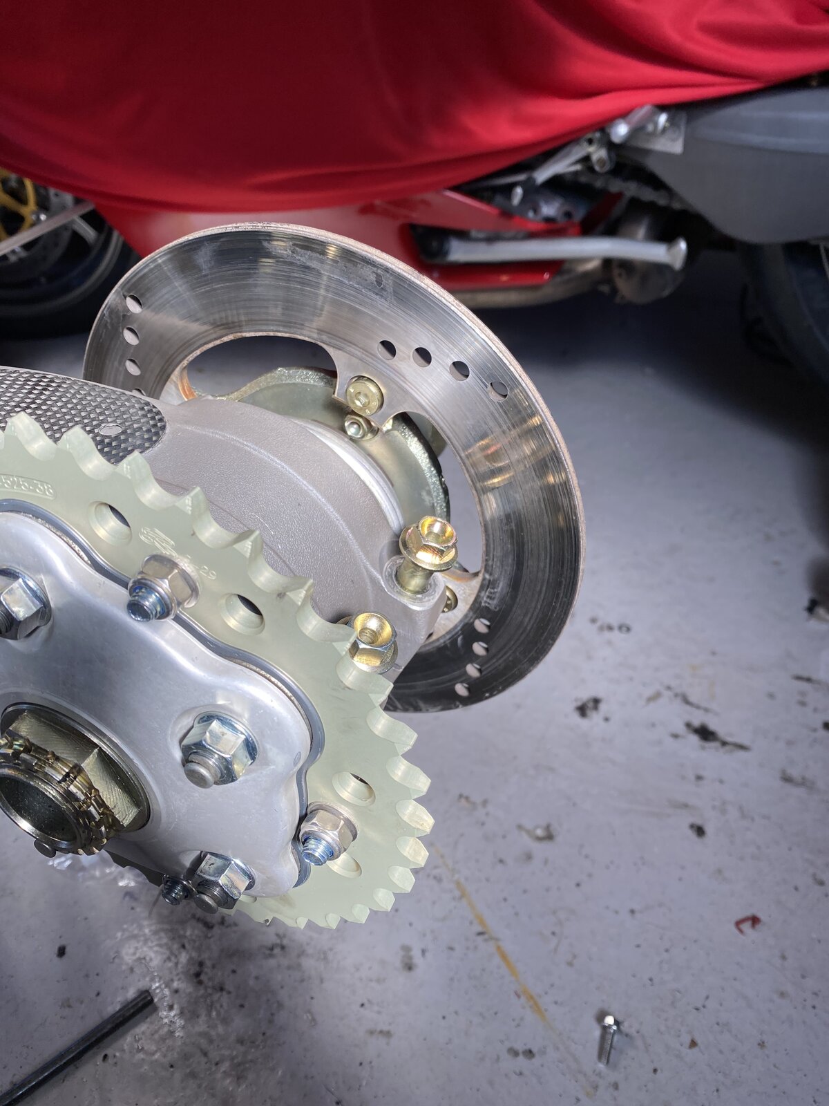

  1. ha the whole axle been replated ?? if so get some fine wet and dry flatting paper and clean the plating of the face that fits snugly into the inner wheel bearing and i think youll find it will glide through as it should
  2. @Messer hope that fixes it for you mate
  3. Sorted yet?
  4. Sorted!
    was exactly that, spoke to Rich at Louigi and he suggested that there are times when the tolerances are just a touch out.
  5. nice one mate

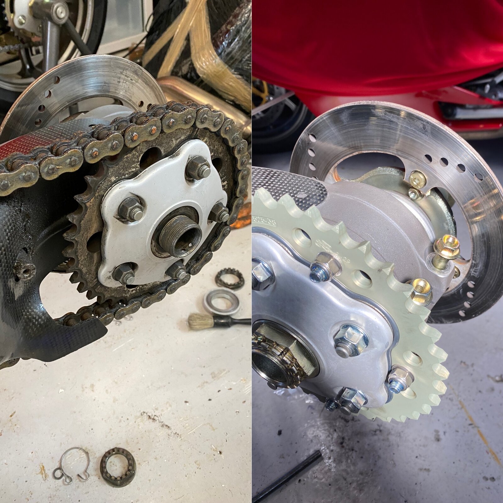

  6. Before and after shot!
  7. What’s changed, Tony?
    :p
  8. My floor got a lot dirtier!
  9. Top answer! :)
  10. :D
