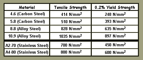

  1. That's excellent info @Sev, both myself and a friend (that builds Ducati and Lamborghini engines for a living, so has experience with tightening stuff at the least) have had this problem when fitting stuff to my F9 track build with Ti bolts, it's cost me a couple of throttle housings in the past few weeks alone and I've finally gone back to using OEM fasteners on fragile components as a result as neither of us understood what was happening. The bolts felt nowhere near 'tight' yet the torque load applied was obviously enough to snap light alloy castings.
    If you replace an 8.8 steel bolt with A4 stainless, it's pretty damn close. But if you use an A2 stainless bolt, you are pushing your luck.

  16. As long as you can get the correct clamping force without overstressing the fasteners you will be fine.
  17. This is the correct answer
