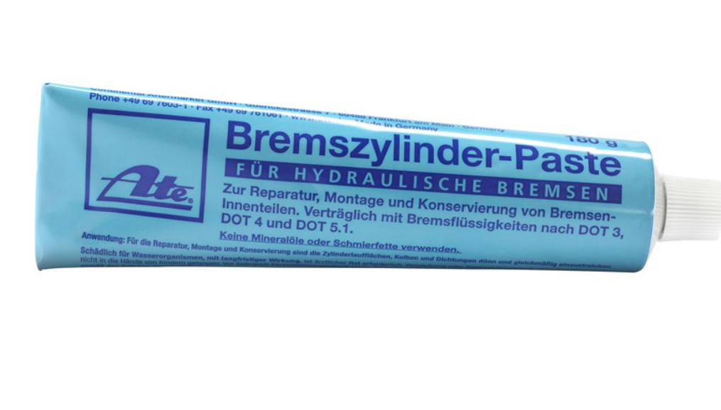

    The grease you can use on the pistons, and should use on the caliper seals if they’ve been disassembled completely for service is a special brake grease such as ATE Bremszylinder Paste.
