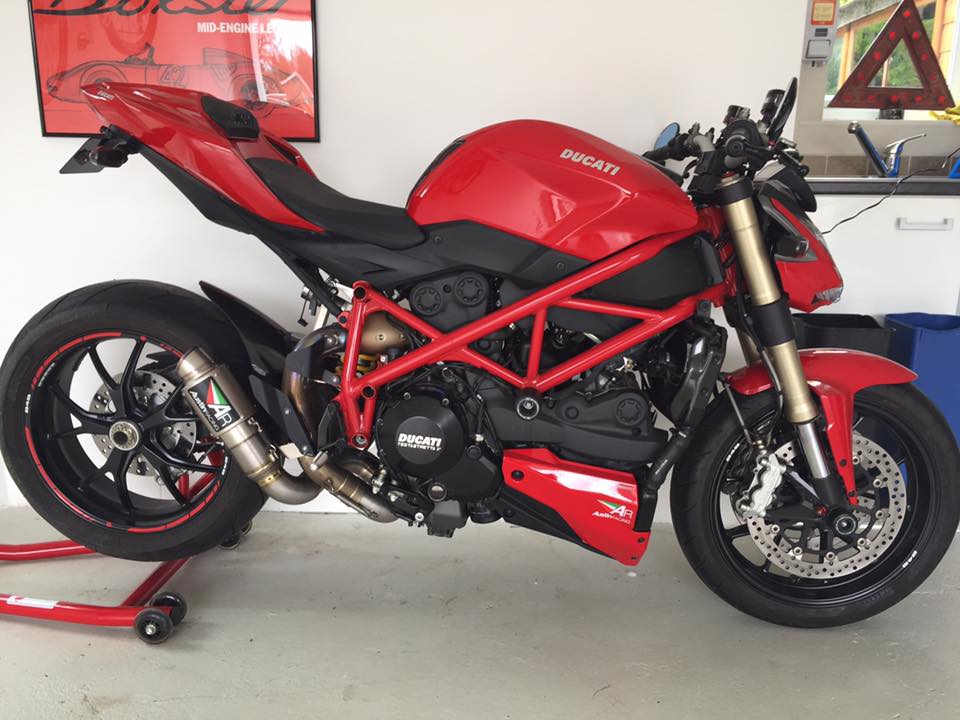

  1. 18193720_10154372903870264_4486615710064441444_n.jpg Firstly I have sort of asked this question before but to be honest Im still very confused.
    I have a Streetfighter 2015
    I fitted last year an Austin Facing Exhaust onto it.
    The web site says NO re-map require but says to re-map to get optimum power from it.
    Im not bothered about anymore power
    BUT I am bothered about blowing up what seems to be a china doll engine (reading all the other threads on here)
    Will I burn valves etc???
    Also since I changed the Exhaust the Engine management light is on because I removed the flappy thing and I am led to believe that is going to be an MOT failure ??? Ducati say they can't reset it which is a pain in itself.
    Thinking about just putting stock exhaust back on
    any help would be appreciated cheers

    If you want the light to go out buy one of these. It fools the ECU into thinking the exhaust valve is still there and working as it should be.
  8. Bloody hell whats that? where does it plug in? why have I not seen this before cheers
  9. Bugger not compatible with the street fighter 848
  10. There’s plenty of other manufacturers that make servo eliminators. As mentioned above it fools the ecu into thinking that the servo is still fitted so Just bypasses it upon removal. Try somewhere like healtech if you just want the light off, they seem supply servo eliminators for a wide range of bikes and they are very good quality... can’t guarantee they will make one for your bike but I have used them in the past and hey do exactly what they’re supposed to.

  16. Cheers to all above , I ordered the servo eliminator in the post above , received it within 48hrs fitted it in less than 10mins (took me 6 mins to find my glasses lol) and cured the engine management light issue.....thx again
