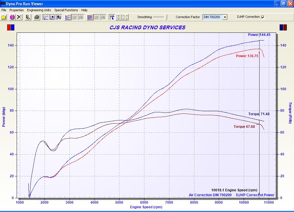

  10. If youre talking about CJS yes. Hes done my z1000 too.....in fact, i think at the time i was the first one worldwide to get an ecu flash (at that point it wasnt documented anywhere plus asking on forums the general consensus was it wasnt doable, at that time). I took it in, Chris got a dump of the ecu and gave it to his software guy i believe. I had to wait about six months or so then took it in. The difference was massive. The list of ecu tweeks were...
    1. Fuel mapping.
    2. Flapper valve delete.
    3. Reduced engine braking.
    4. Primary injector cut in time changed from 7k to 3k before the secondary injectors cut in.
    5. 500rpm added to the top end as it was still making power at the redline.
    The base reading there is with the full system and air filter already on so, stock you could probably knock a bit of the initial run.
    And there it is getting caned...
