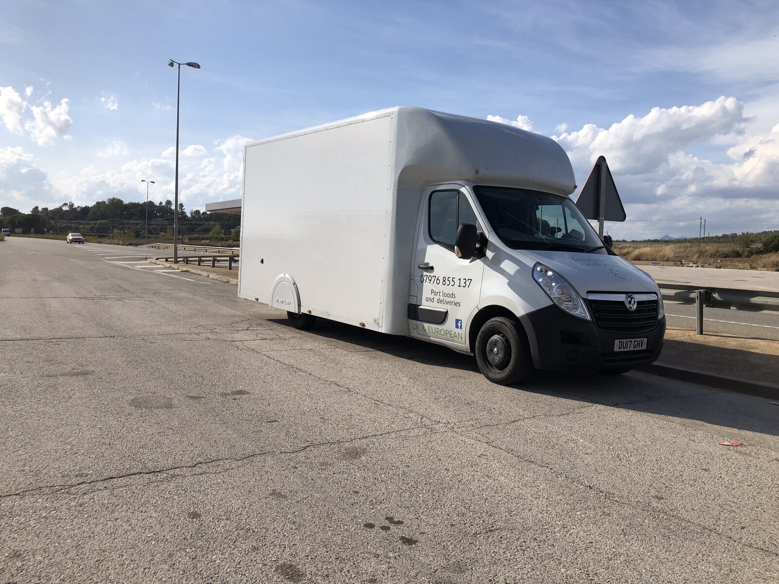

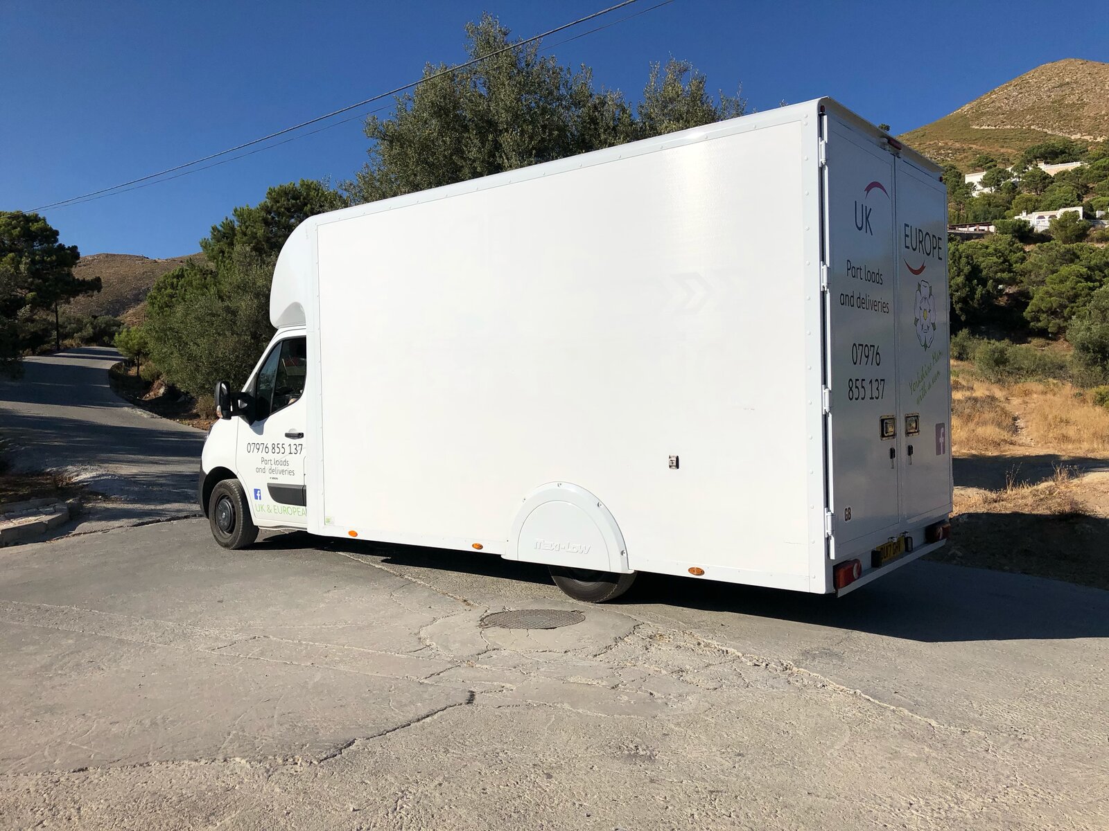

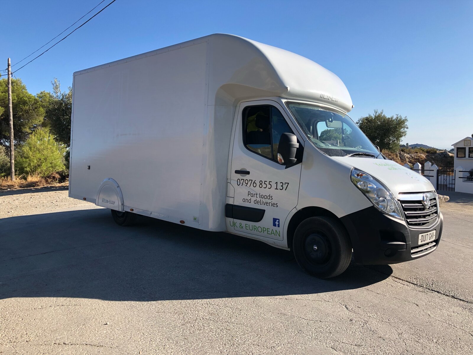

  11. Hmmmm if the van is honeycomb (some just have a dense expanded foam core) with a thin laminate no fastener will work as it has nothing to bite into. I’ll assume it’s a body you’ve had built onto a chassis cab from your description?
    Most of the box bodies I’ve worked on are constructed in this way nowadays as majority of consumers of box bodies prefer weight saving to longevity. Gone are the days of GRP that builders would screw and rivet now screws and rivets are used to hold the racking strips in place whilst the bonding agents set.
  12. Honeycomb possibly but very small dimples all over the body yes for weight savings as van payloads are the biggest problem especially when as big as my van my old van was similar but much stronger so carried less like 170 kg less
