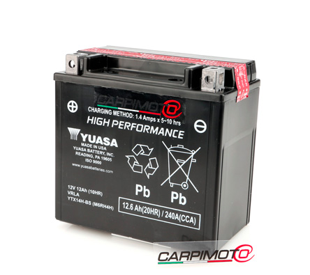

  12. Yuasa are probably the best and widely available, be wary of batteries on ebay that claim to be gel (Motobats are the worst offender for this for some reason) when they are simply expensive AGM lead acids
  13. second this, I had issues with mine on a NEW bike, the connectors had moisture, condensation or whatever in them from the bike being sat in storage, ended up with a PUMP16 fuel relay issue. Dealer replaced both and never had an issue again. on my recent 848 I routinely used to check them all out.
  14. I think the OEM option for 2008 Ducati 848 should be YT12B-BS (Yuasa 10,5Ah and 210A) - dims 150x69x130mm.
    YTX14H-BS (Yuasa 12,6Ah and 240A) dims 150x87x145mm meaning the depth and height of the battery are much bigger and I'm afraid that the height doesn't fit my rides battery compartment...?
