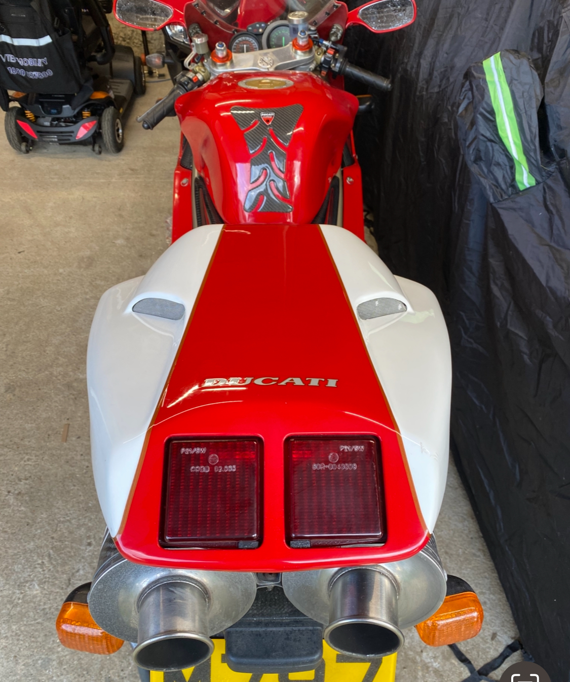

  11. All my panels are stamped for June 94 so it would be good to keep them original if I can.
    If needed I’ll get a new one and still have the old one fixed and painted; just don’t want to be off the road all summer for the sake of a panel.
    I checked my levers and they are dated 93, with all the history and photos I’m sure they were fitted from new and the guys at pro twins confirmed that the early 916 S (199 made) came with the ohlins rear, adjustable levers and different livery.
    If you look at the tail piece the centre section is tapered, on the other models it’s parallel.
