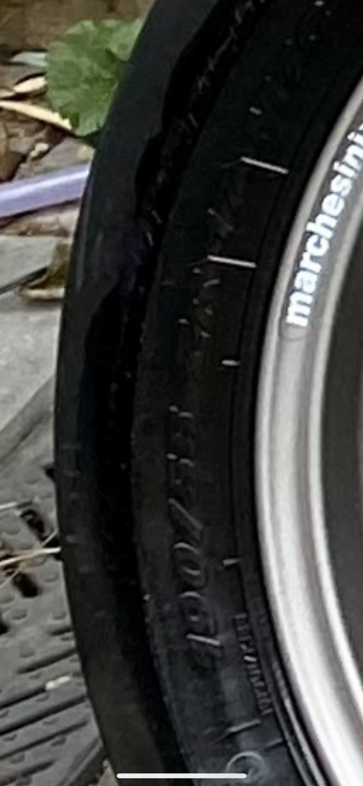

  4. So…. Some petrol on a rag and gave the tyres a decent clean off, thanks, that done the job. Went for a slightly longer ride and have a few observations.
    The 996 is lazier below 6000rpm than the 748, but then really comes alive once you start using the full rpm !!
    The 996 handles like a drunk cow… I’m mean it’s absolutely bloody awful!! I did notice already all the compression and rebound setting are miles out compared to the 748’s , so a full going over and starting at factory setting is needed.
    Tyres are past their best so some fresh rubber required
    The 748 is mega comfortable and doesn’t hurt my neck or wrists at all, the 996 killed me in about 6 miles. The 748 is MUCH lower so will try set the 996 up the same as the 748, comfort over looks I’m afraid.

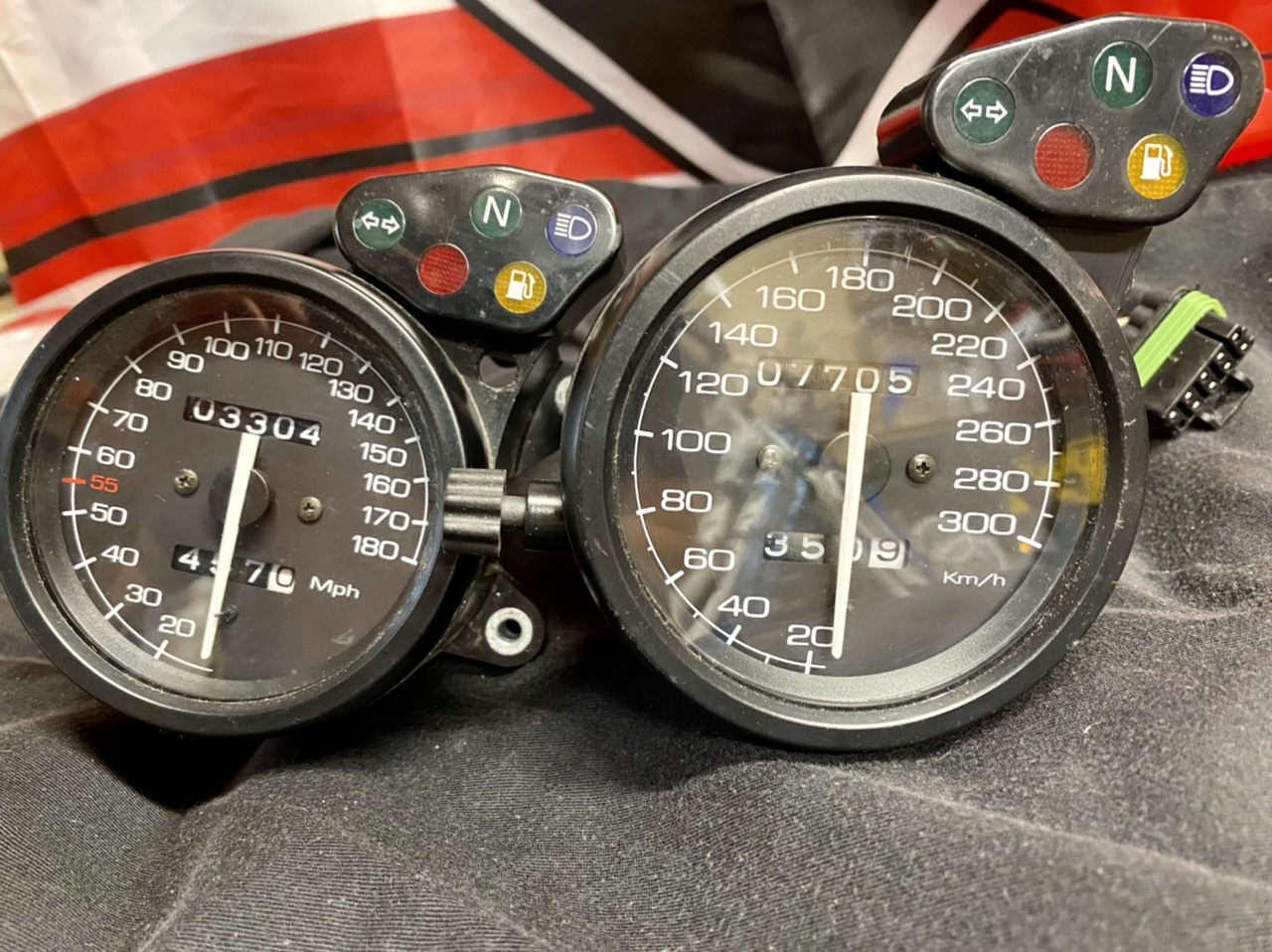

    Finally, Speedo is a MPH speedo but it’s appears to be reading on Km ? Are there different speedo drives or someone ? It’s definitely over reading distance by a country mile, and possibly the speed too, but I would need someone to ride with me to confirm that bit.

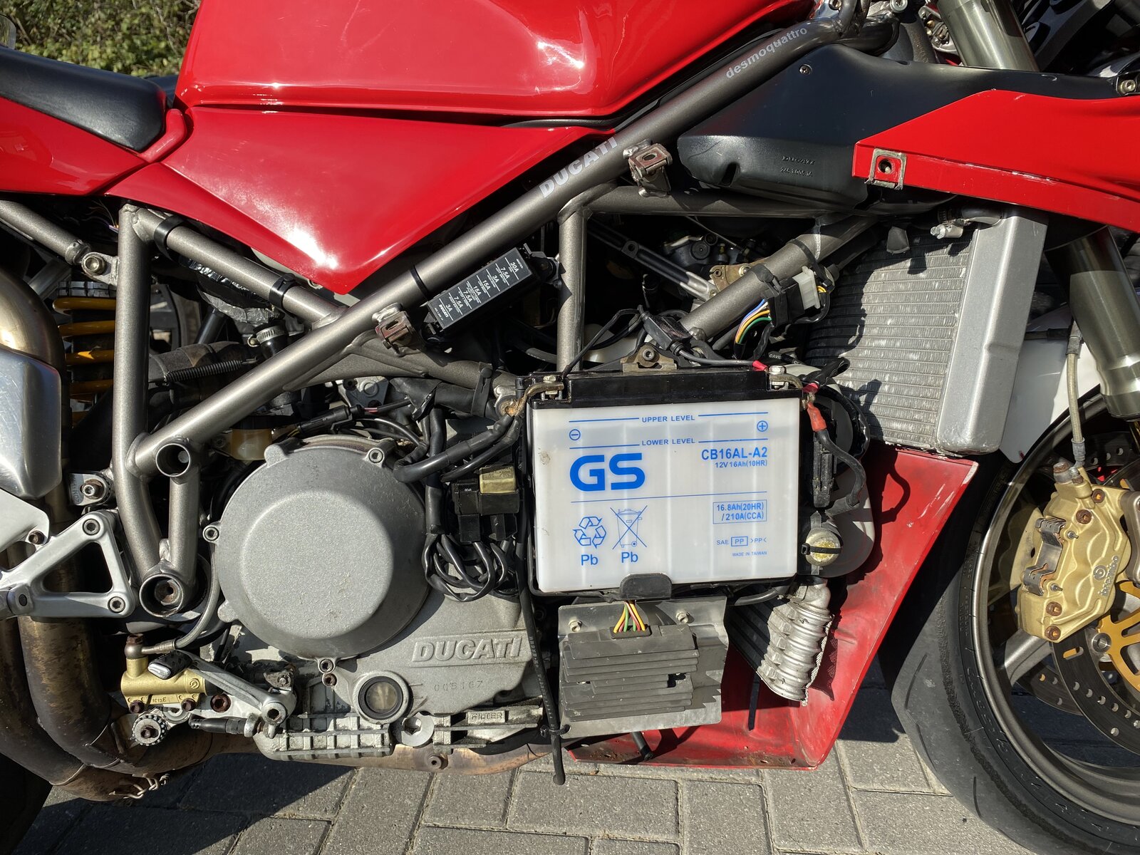

    So far so good, but it will want some going over to get to my standard. Have a free pic with fairing removed… dunno why, just cos :)

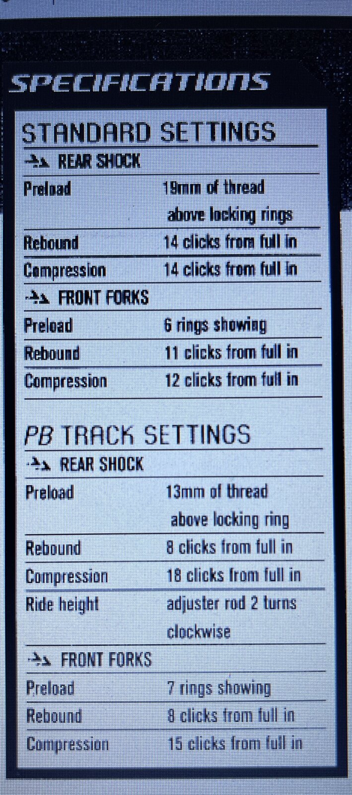

  6. Here’s an old PB set-up as a start point
    • Useful Useful x 2
  7. Is that for an S with Ohlins rear and Ti Showa up front ? Many thanks !

  9. ping me a PM and ill send you PDF

  11. Get your Karcher out, there's no tyre gel I've ever come across that can resist the force!

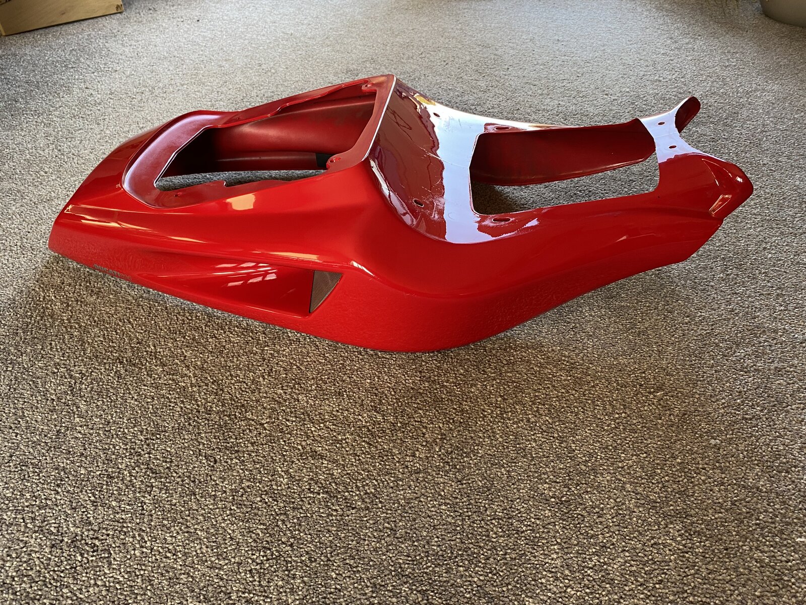

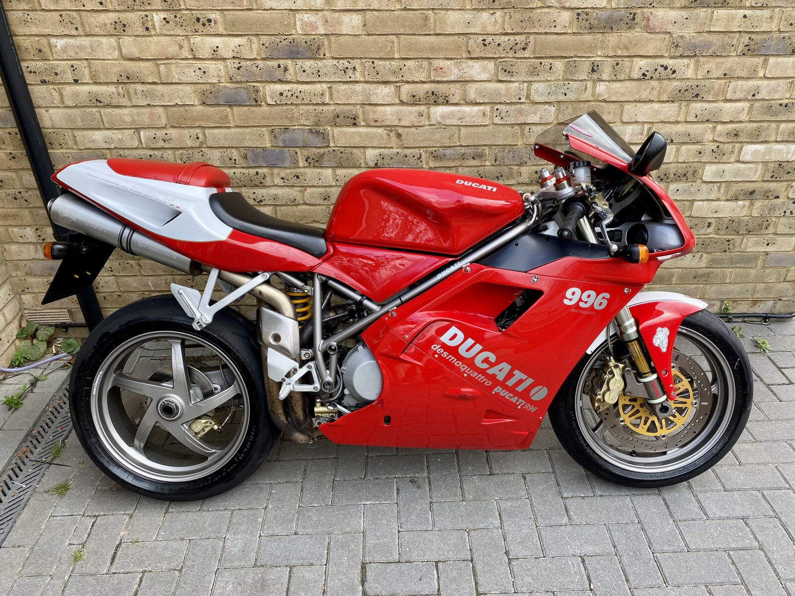

  15. Well the first part arrived today… couldn’t really say no to an original 996 biposta seat unit in the original red for the grand sum of £50 ! I do like the one on the bike with white number boards but the damaged paint on the side annoyed the life out of me. I will hunt down a monoposto seat unit at some point but this was a quick fix
    2041F770-0280-433F-B547-4CEC608EE1AD.jpeg 120B8C1C-B480-4627-A22B-202393619328.jpeg E1C1AA69-A319-48AD-A90A-2B8457F2F887.jpeg 87E51AC6-EA49-4367-B428-E0551BC970B4.jpeg
    I also went through all the suspension settings on both bikes. Wrote down what each bike was set too and then mirrored the 748’s setting onto the 996. The 748’s settings were no where near factory setting but then I’m only 12 stone wet and the bike rides beautifully for my style so don’t feel the need to alter it. 996 now has the same suspension setup and hopefully a road test will show a vast improvement over before…I mean it literally could not handle any worse so nothing lost there :D

  19. The drive unit in the front wheel is the same regardless of whether it’s supposed to be an mph or Kmh bike, it’s the dash unit and it’s display that’s different. Thus you can swap a mph dash unit for a Kmh dash unit with impunity.
    AFAIK, the only difference is the display of units under the needle. ie where the needle points at 50mph will be exactly the same position it will be in on a Kmh speedo just the number on the Kmh dial will be 8/5ths of the mph dial ie 80kmh. Look at these two side by side
    If you believe it’s not giving an accurate reading then it may be the gearing inside the display unit that’s fubar.
    You could get a cheapy gps Speedo unit off eBay to ascertain or use an app such as MyRide and check what it says was your top speed on a run compared to what you saw displayed.
