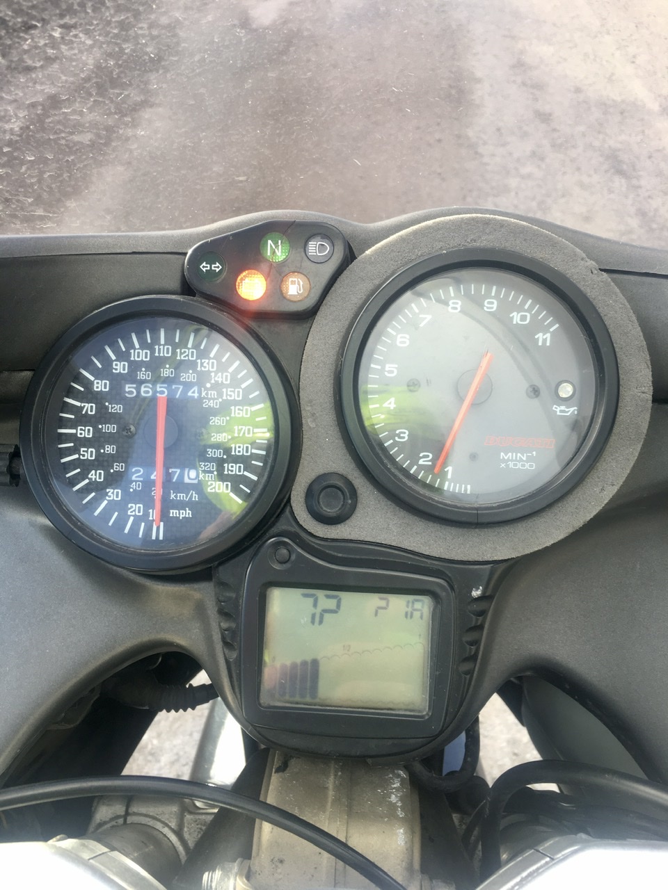

  1. The speedo is definitely a mix of something ! The mileage and trip meter are most definitely in Km , and possibly an even smaller unit. I did a couple of very short rides probably around 10 miles at a guess but trip is now showing around 27 somethings . The speedo however does seem to tally with mph though. I know the route I rode well and when I was doing a certain speed between certain points, it most definitely was around what I would expect in mph rather than Km.
    I have read this before with others experiencing similar, Km trip but mph speed. Don’t know what the problem or solution is, it doesn’t overly worry as speed is more important than distance, but on then other hand there’s a possibility it’s only done 14000 Km rather than 14000 miles ?? Bike is an import btw, although I don’t know where from.
    That’s the speedo unit, looks to be a proper Mph one but guess when I give it all a strip down an going over I will find what’s going on .
    At the moment I’m just trying to find all the niggles so I can work though them over winter. Throttles and tps want setting up too and I guess the air bleeds as I get the odd sneeze through the airbox at low rpm.
  4. The more I think about it, this makes the most sense. Speedo is definitely in Mph and distance in Km. Only real way that could happen is as above where a mph face was put on over a Km unit at point of import. Can’t see any other logical way a clock can read separate units like this .

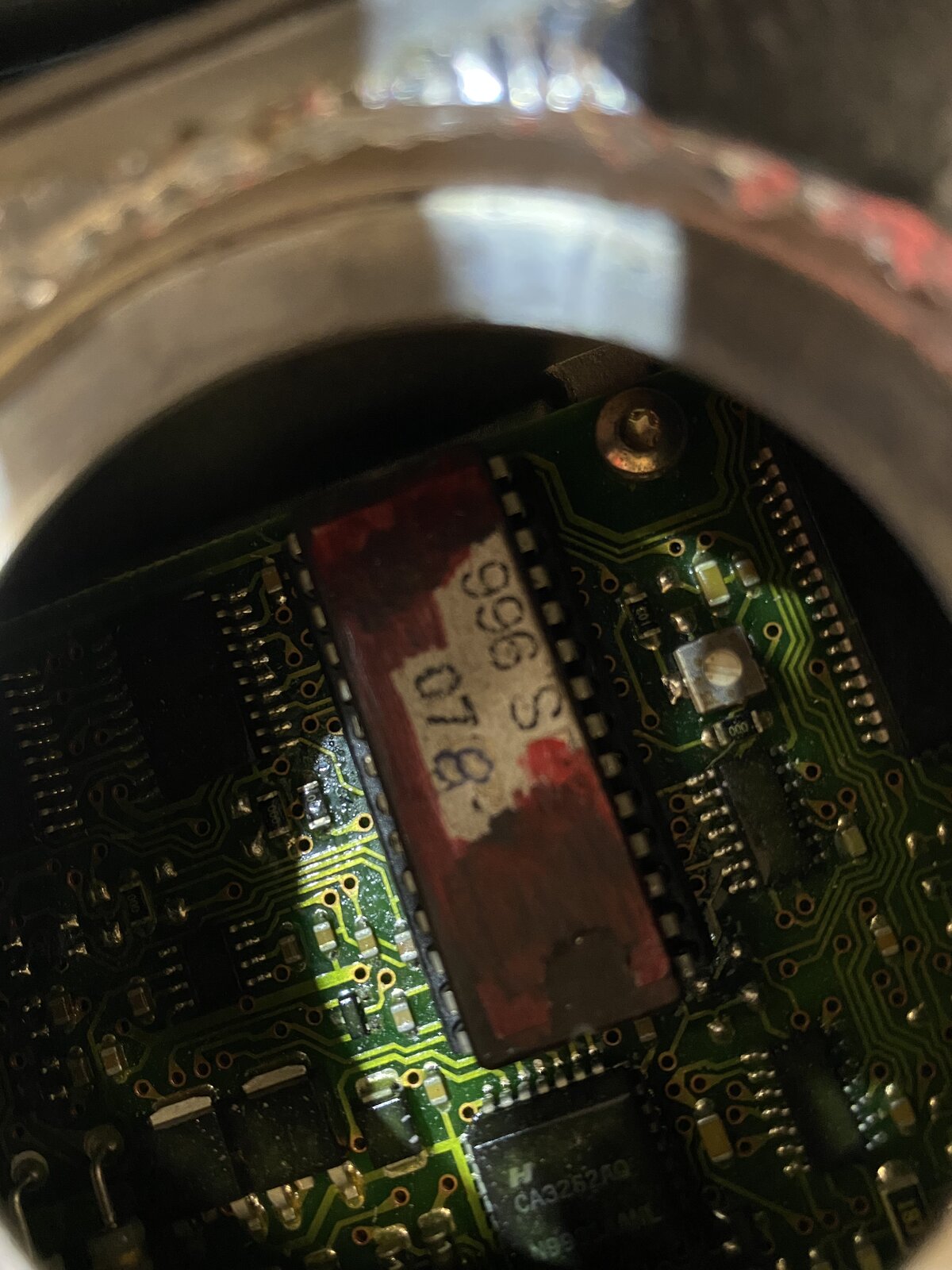

  14. So my 1998 748 has these idiot lights below.
    The ECU on the 996 and the chip fitted. Bike appears to be mechanically standard including standard 50mm exhaust.. need to look up chips and see what this one is

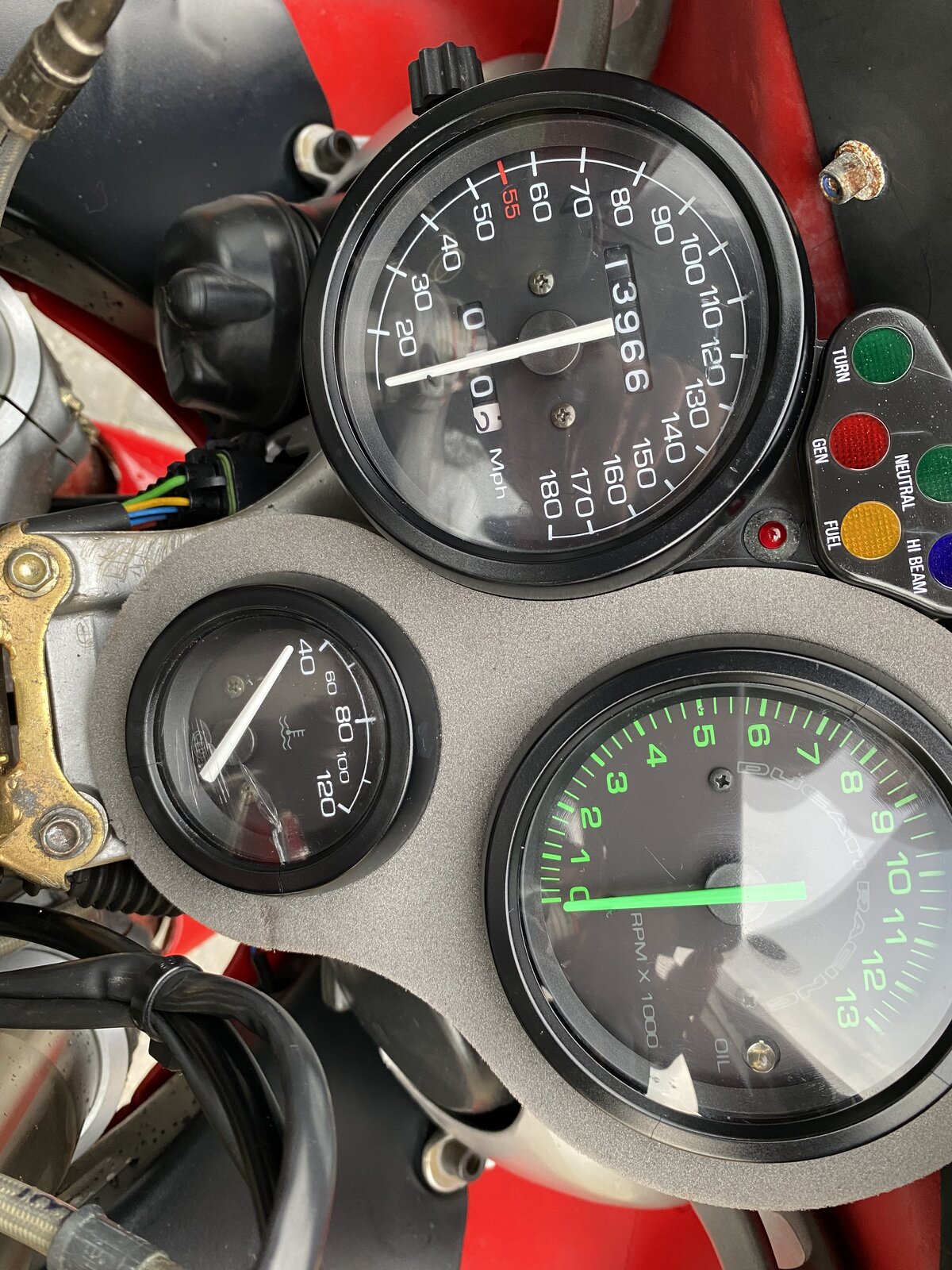

  19. My 1998 916 (owned from new) has an oil light in the rpm cluster

  20. Looks to me like the standard and correct EPROM in a 1.6M ecu for a 996S
    I beg to differ, both my, unmolested by others, 748 and 998S have the oil light in the Rev counter.
