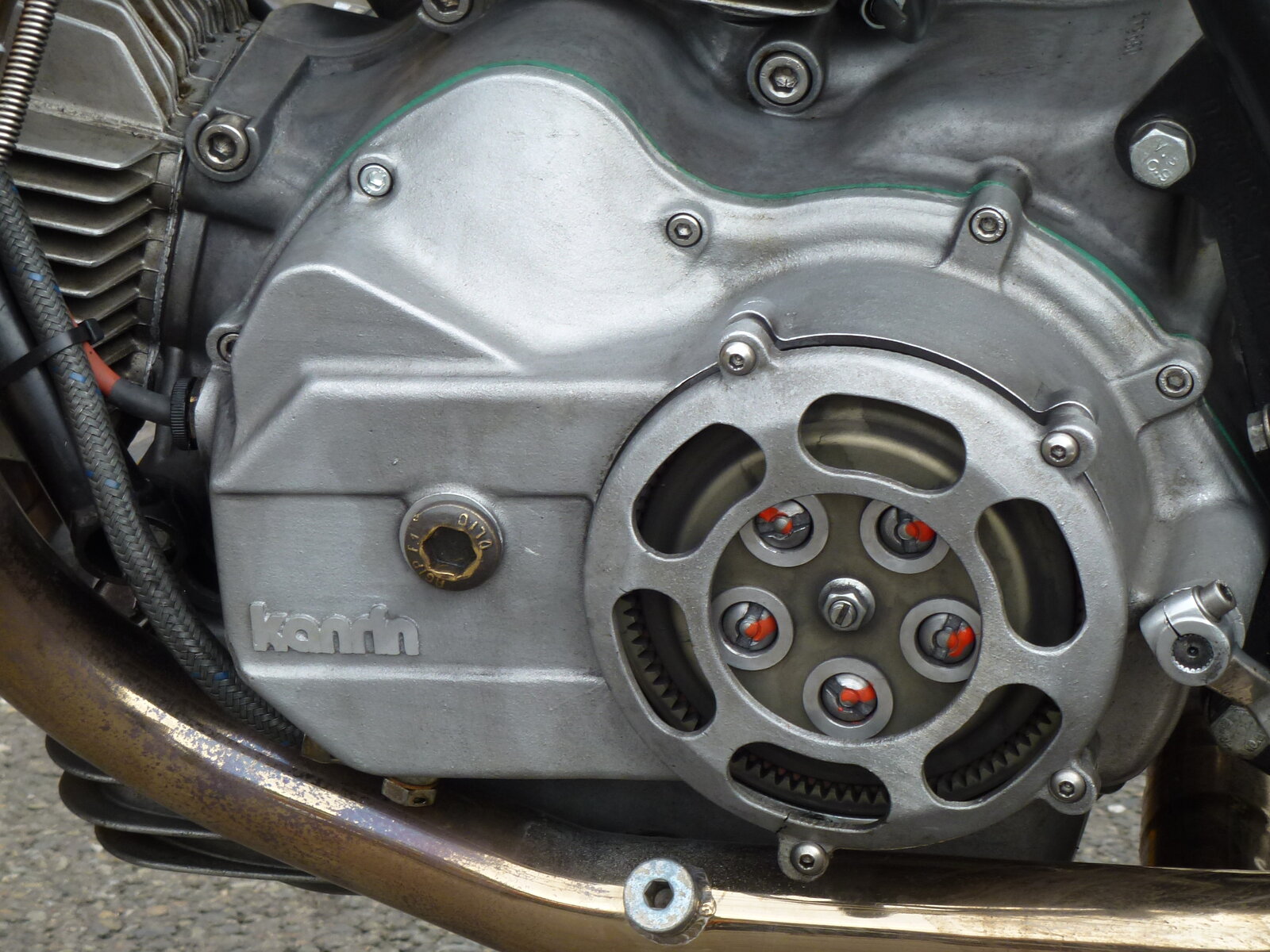

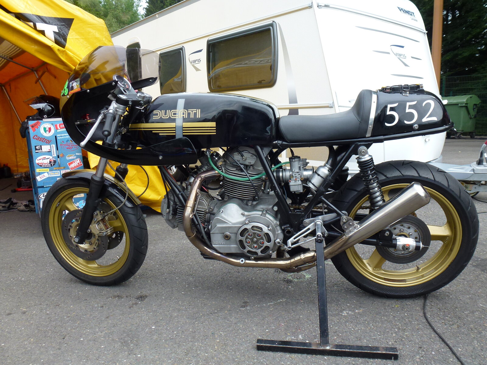

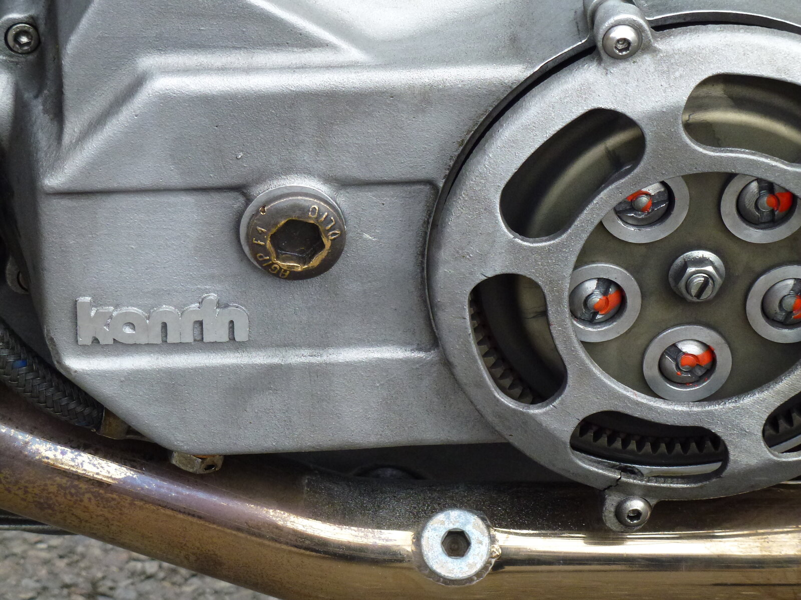

  13. A dry clutch conversion spotted at Spa
  14. So much want for this .... love dry clutches but thats the same cost as a decent set of wheels ....
