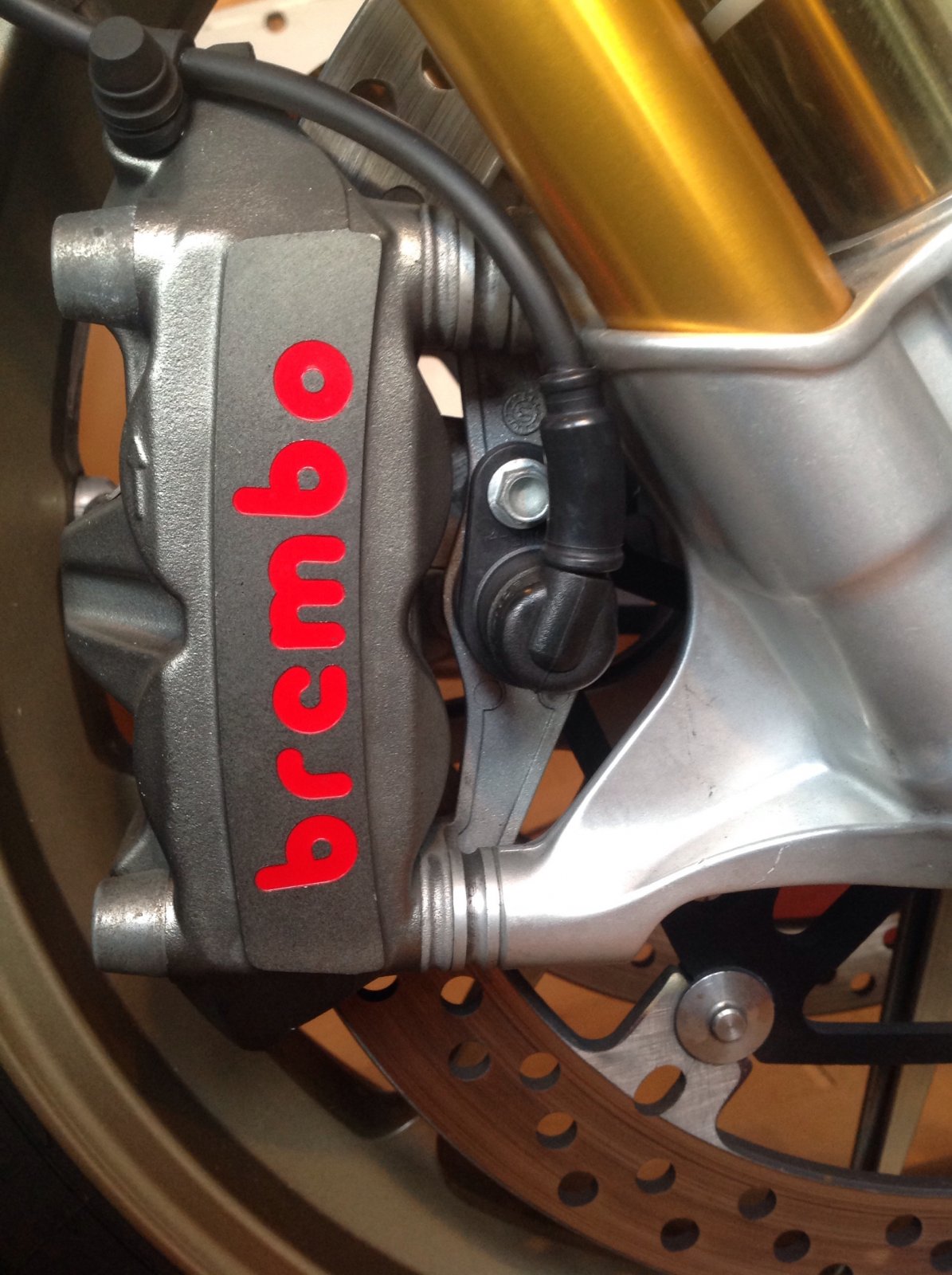

  2. @Bullitt Hi,
    As you know, my 1098R also has FG353 forks installed by the previous owner/JHP. I can measure the spacer that has already been installed on my caliper mount on the RHS where the ABS sensor is located.
    Also...I have the same subframe and a race seat unit...it already has the exact same bracket as you show in your picture for mounting the DTC sensor. Ahgain, this was already installed by the previous owner/JHP. I do not know how it was done but I can take some pics if you like?

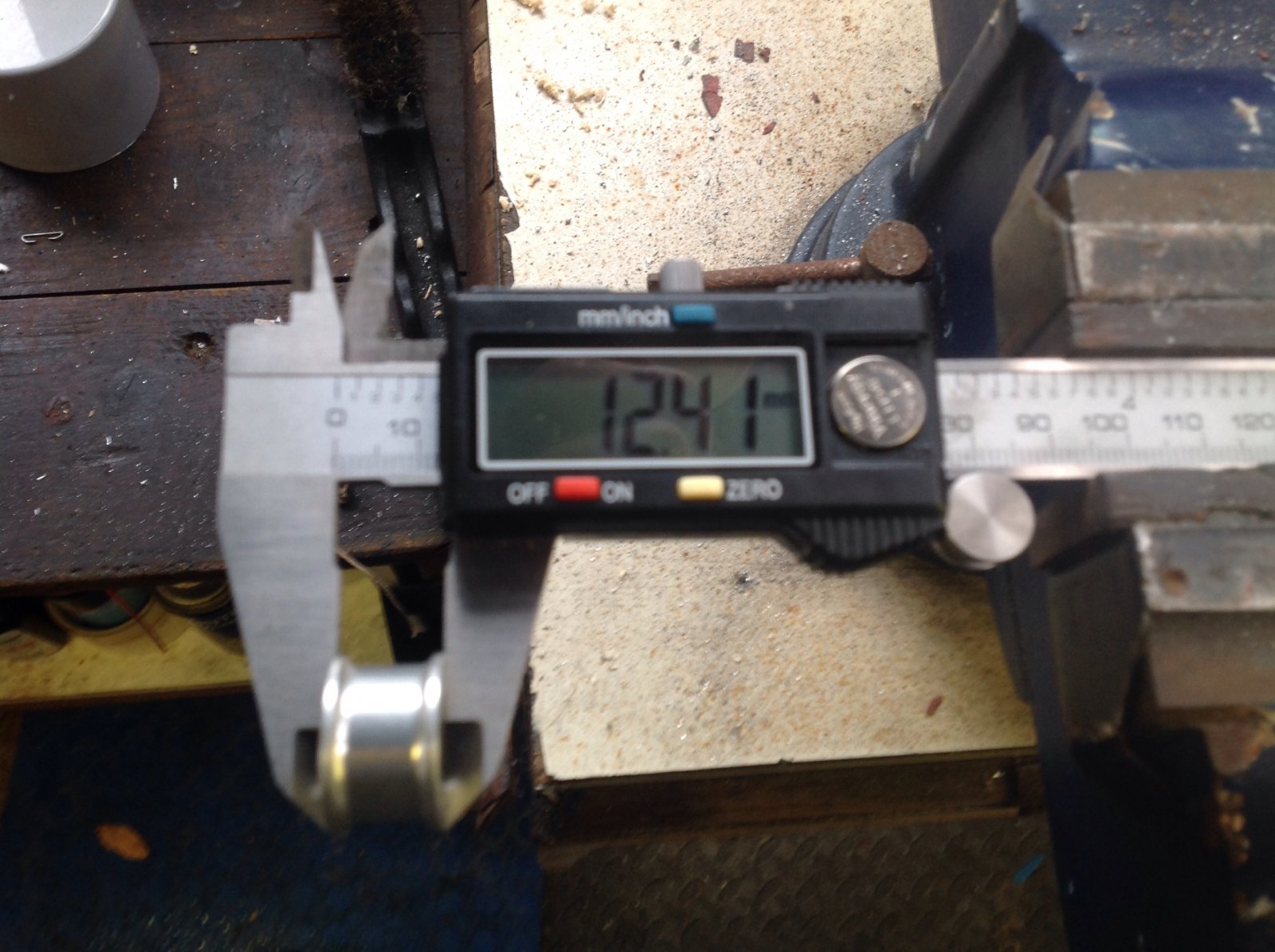

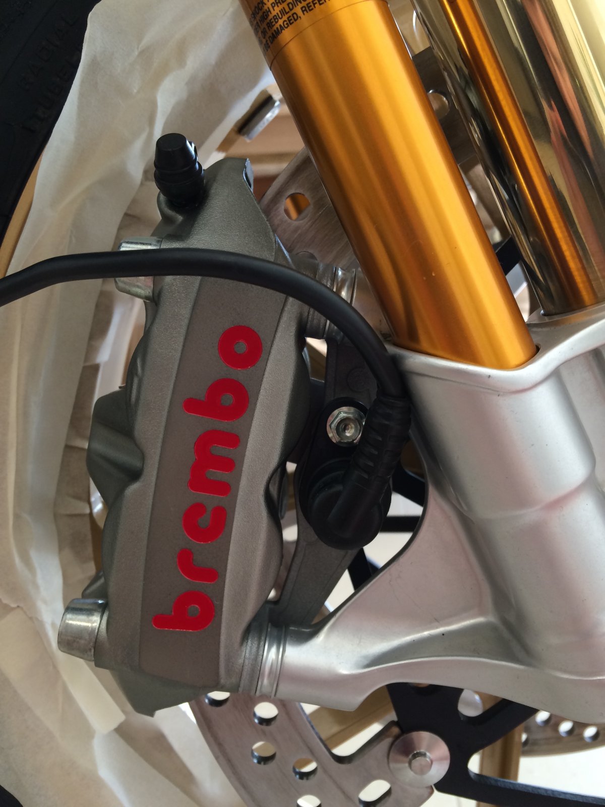

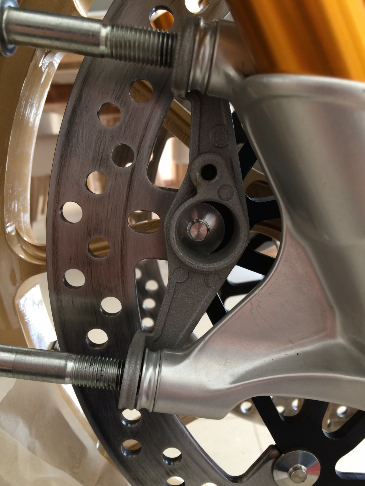

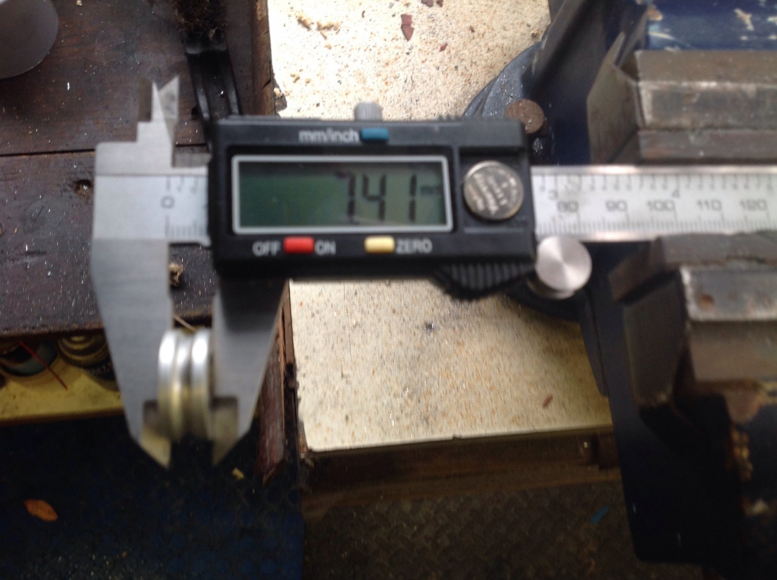

  8. @Bullitt
    Brake spacers.
    RHS : 7.41mm
    LHS : 12.41mm

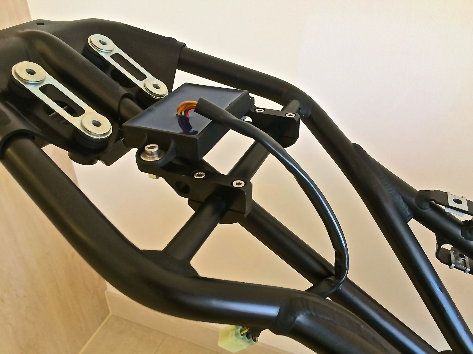

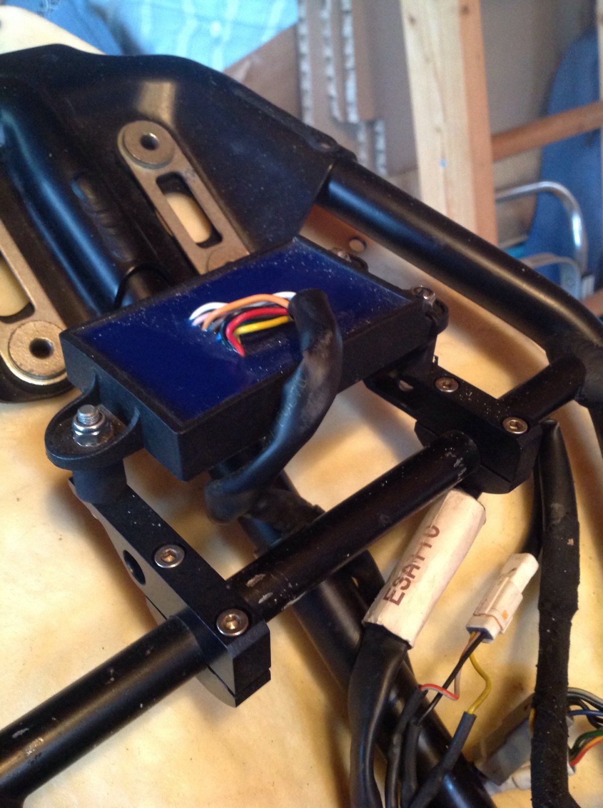

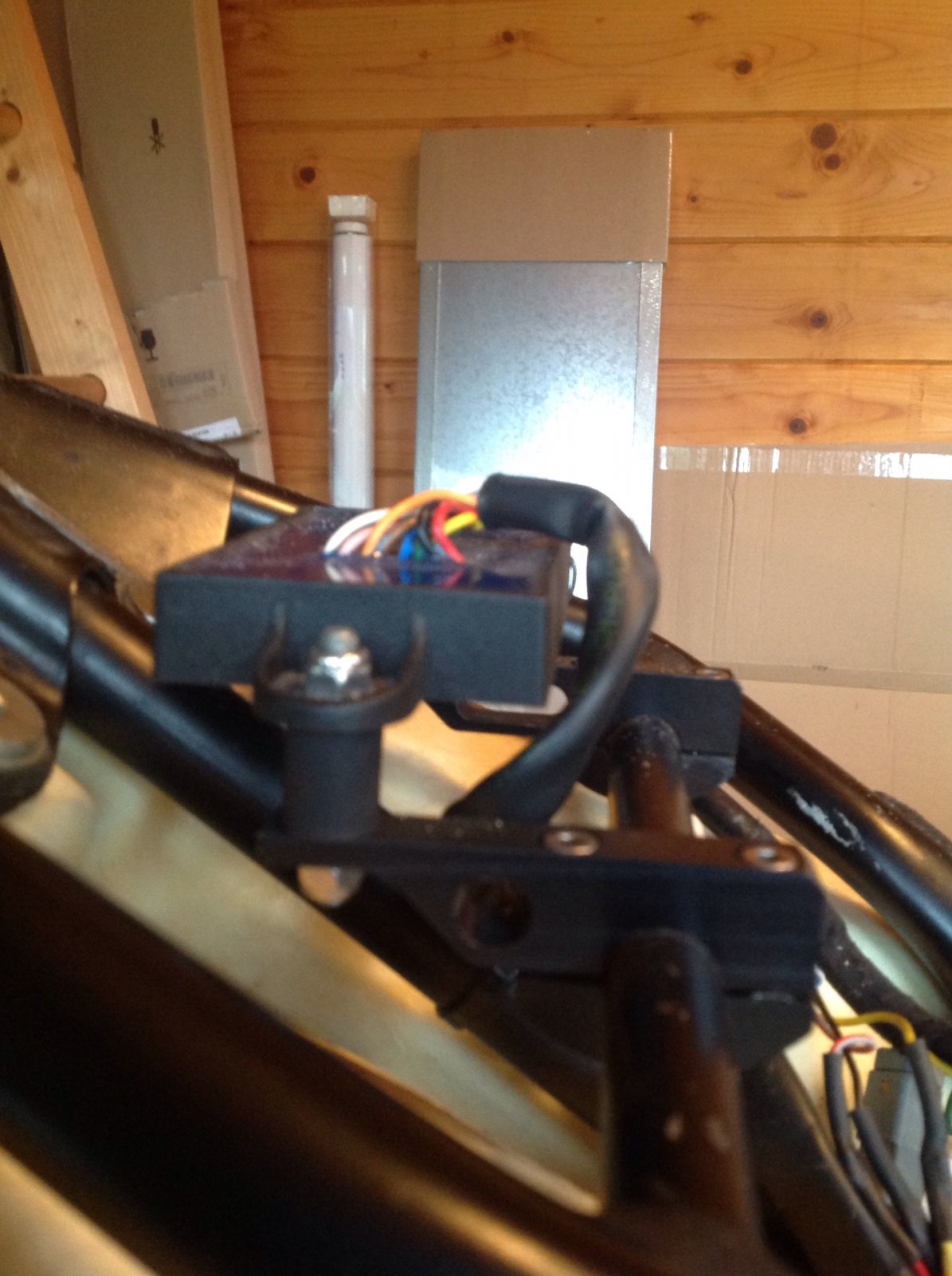

  9. DTC mount
  10. @RickyX
    Many thanks mate - exactly what I was looking for. DTC should work a treat.
