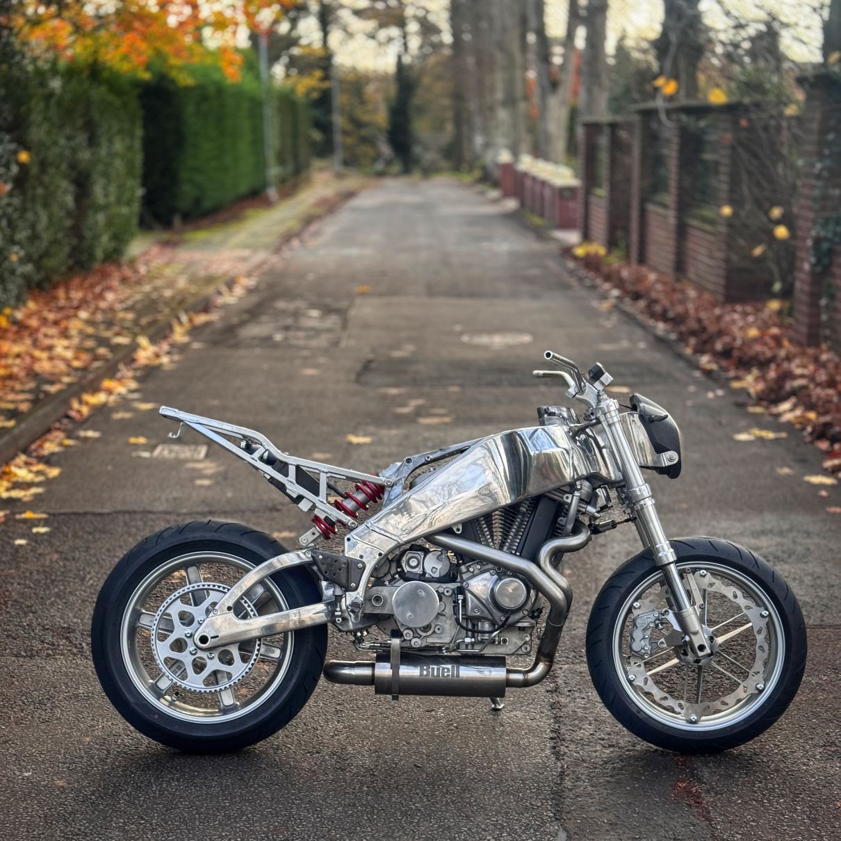

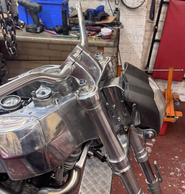

  1. I made some headlight mountings that worked off the stanchions… but despite putting a lot of effort into making them, they just didn’t look right. I have ended up mounting the headlight on the headstock. it needs to be lowered a bit to line up with the frame top, but I can do that later.
    here is is out in the daylight!

  2. Love it! That frame looks great.
  3. That looks brilliant!
  4. Love the mono-chrome look! :upyeah:

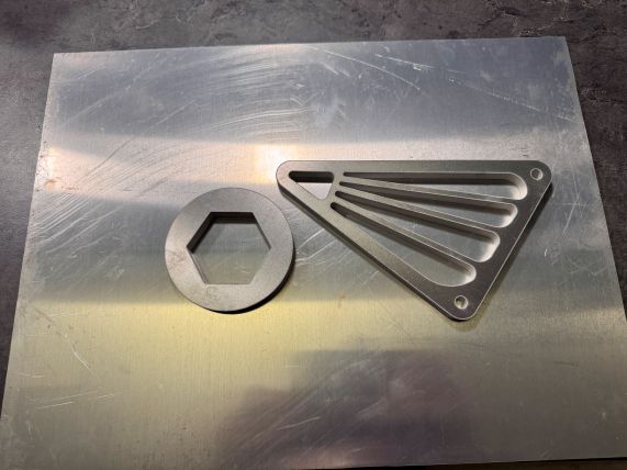

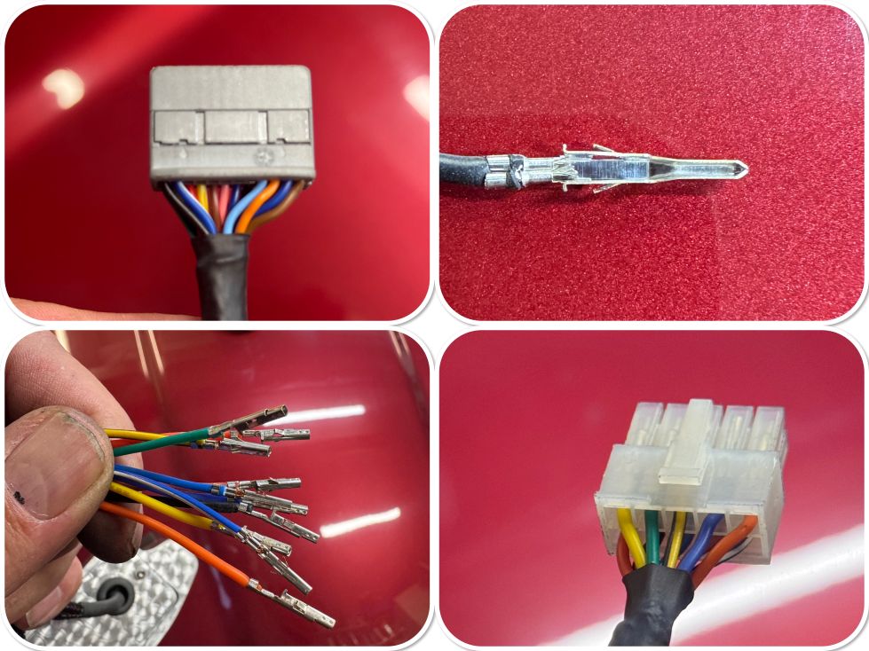

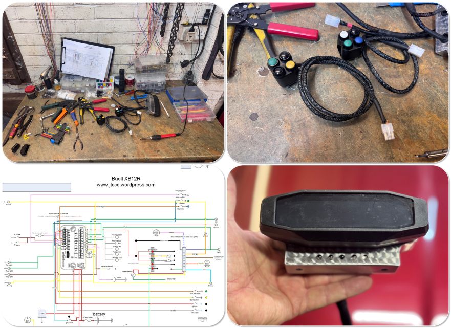

    On to what is probably my favourite part of a build… the wiring! For the first time I am using a Motogadget unit, as there is not a lot of room for the wiring, and I fancy a change! I will be using the tried and trusted Speedo/tacho unit which are now £15 off the internet! This along with some cheap, but very good quality switchgear which were actually very cheap!
    As always, Bike reliability is often linked to the quality of the wiring, its important to have good connections/connectors with properly crimped joints.

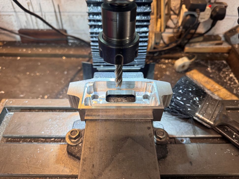

    I machined The speedo plinth out of some aircraft quality alloy. I get a lot of this type of material from a local scrap metal dealer who collects scrap from aerospace companies in the area… If I am lucky its marked with the material specification… In this case I had no idea, but it machined so easy, I wish I knew what it was! I didn’t do a drawing for this… I used as my mate calls it “eyeball engineering” and did it without any dimensions written down!

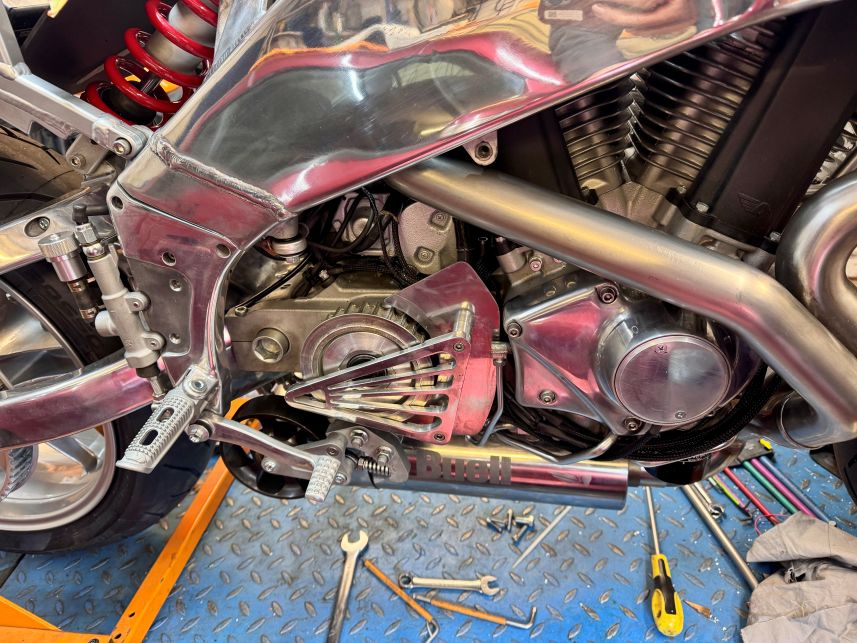

  8. A bit more done on the wiring… I have also made a belt/pulley cover and a retainer for the main shaft nut which i will drill and slot when the nut is tightened

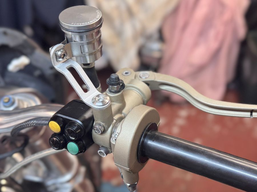

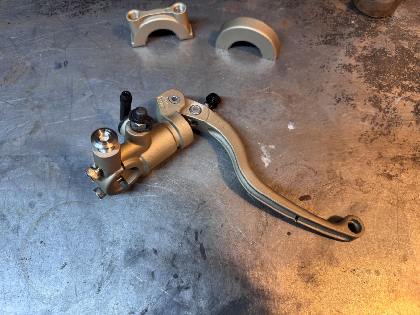

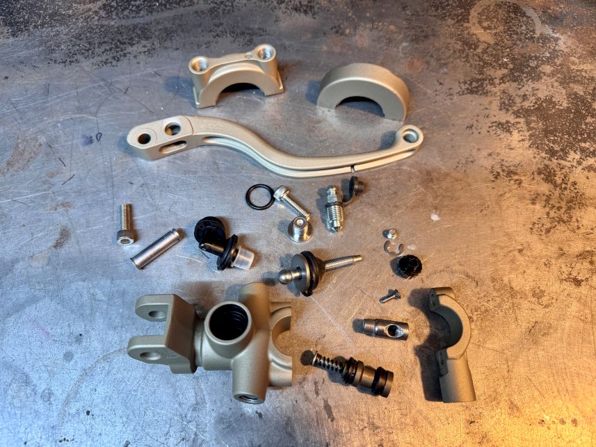

    I didn’t like the look of the original master cylinder so I have swapped it out for a radial one… Its one of the cheap ones off AliExpress, it seems to be good quality though, easily as good as some of the Brembo ones I have refurbished in the past. Its a little more beefy around the pivot points which is not a bad thing as I have seen Brembo ones crack!
    I used cerakote the cylinder and throttle housing to match the rest of the bits on the bike. I really do like Cerakote, it gives a factory look to parts and seems to be very durable. As ever though, its all about the preparation and they are keen to say it can only be sprayed over a media blasted surface. There are some good guys out there that will do it all for you though...

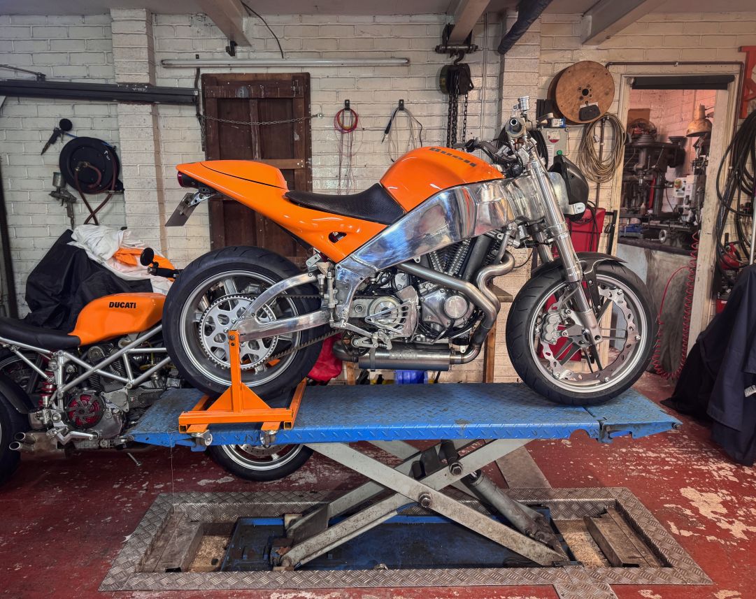

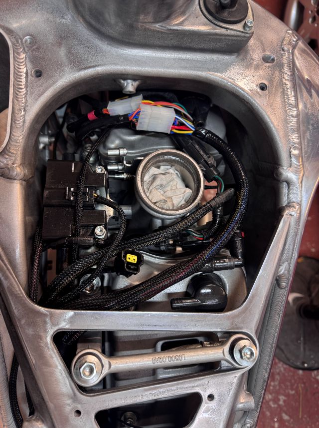

  17. while I have retained the speed sensor for the ECU, the new clocks require a different one. I managed to drill and tap the calliper bracket and fit it in there, along with some magnets on the disc. Still plenty to do but I couldn’t resist popping the bodywork on for a look! I did paint the original mudguard orang so I will be putting that on as it looks better than the carbon one…
