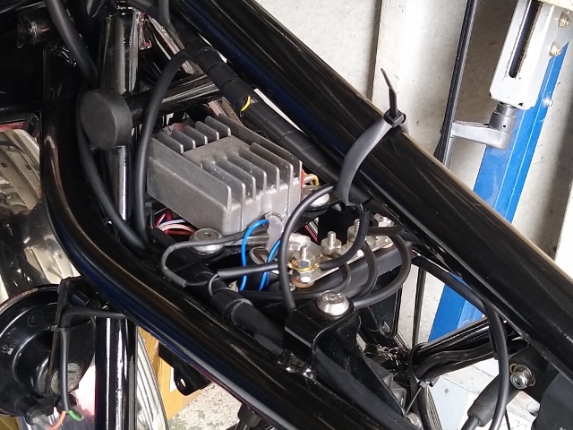

  4. So the flashing led will be active when the ignition switch is off, nice. Sort of a pseudo alarm/breathing light.
    One thing I did when rewiring the Darmah was use an earth busbar to which all lights, indicator etc earths ran back to with then one lead from it to the battery. It saves having to scratch the frame to get a good connection.
    Still need one big fat engine/battery earth mind for the starter.

  7. Yes, I like the idea of the busbar... the fuse box I have used has one for the earth, and one feed in for the live which keeps things tidy. here it is on another build. When I looked at the size of the starter, and battery, I went a size up on my normal diameter cable!!

  9. yes, I like the braided sheathing.. in areas of high likely abrasion I add a double layer... I have also found that those rubber loom clips Ducati use are better than cable ties... they do sone cheap on Temu, different lengths and colours... they are also great for when you build a loom on the bike

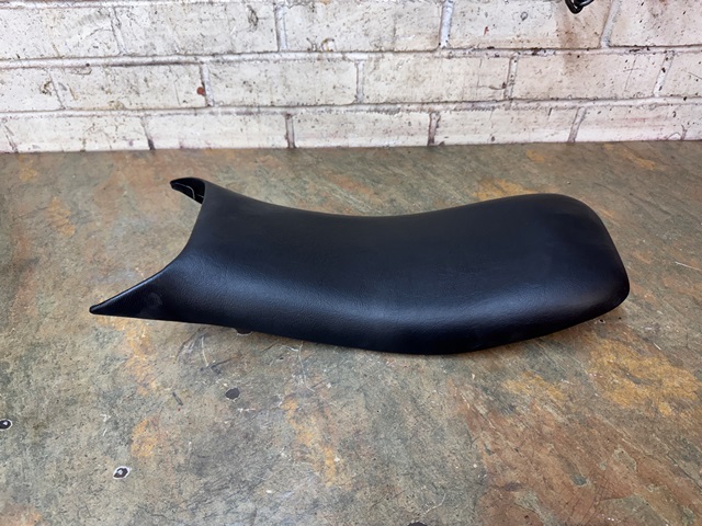

  12. Here’s the finished seat and the tank with its modified filler where I have utilised the original Buell filler. The front will be secured with the Monster over the center catch.
