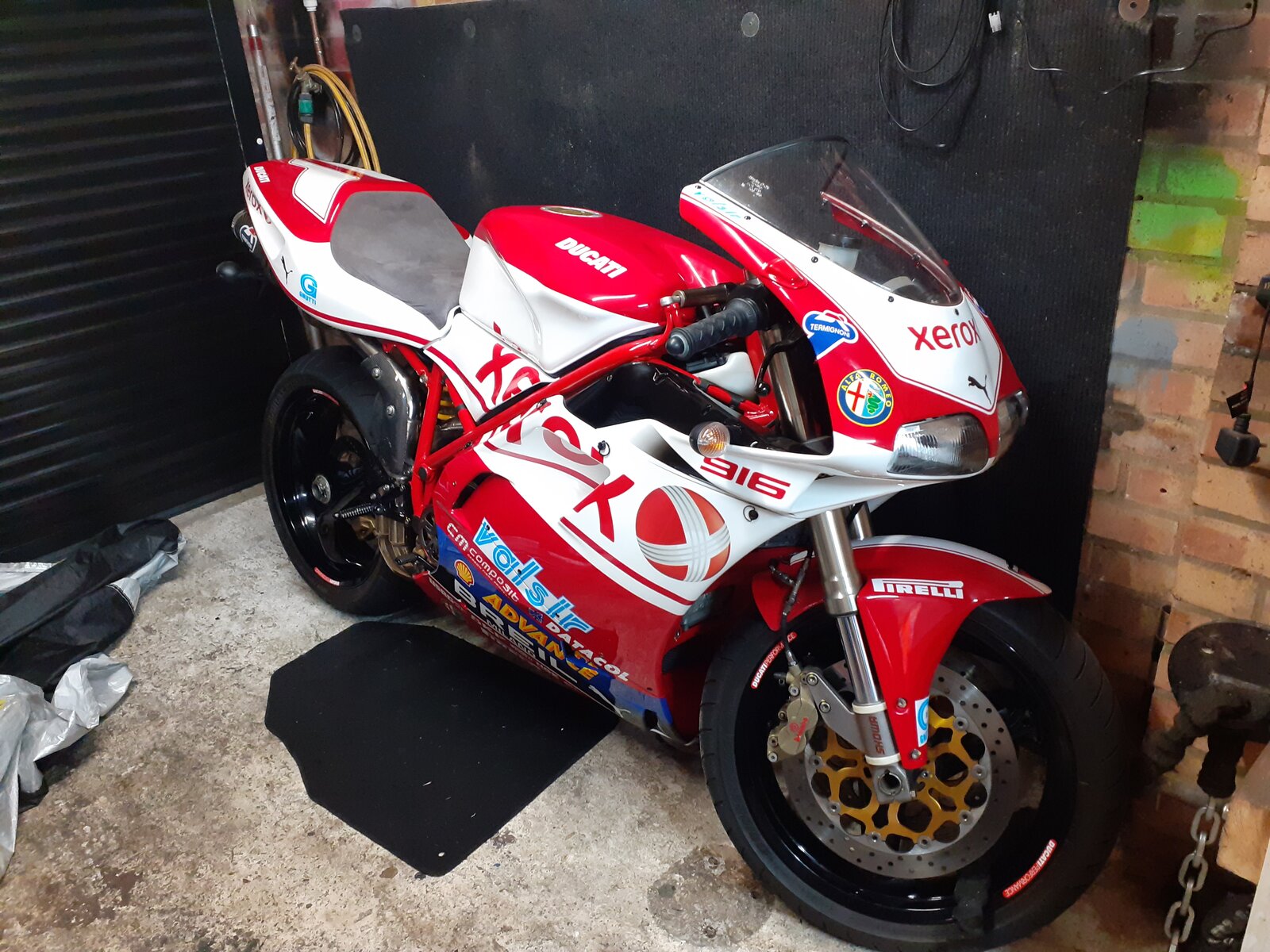

  10. They all do, S stands for Superbike. My biposto is ZDM916S for example.

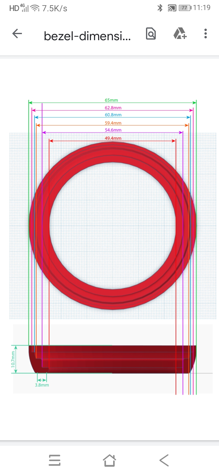

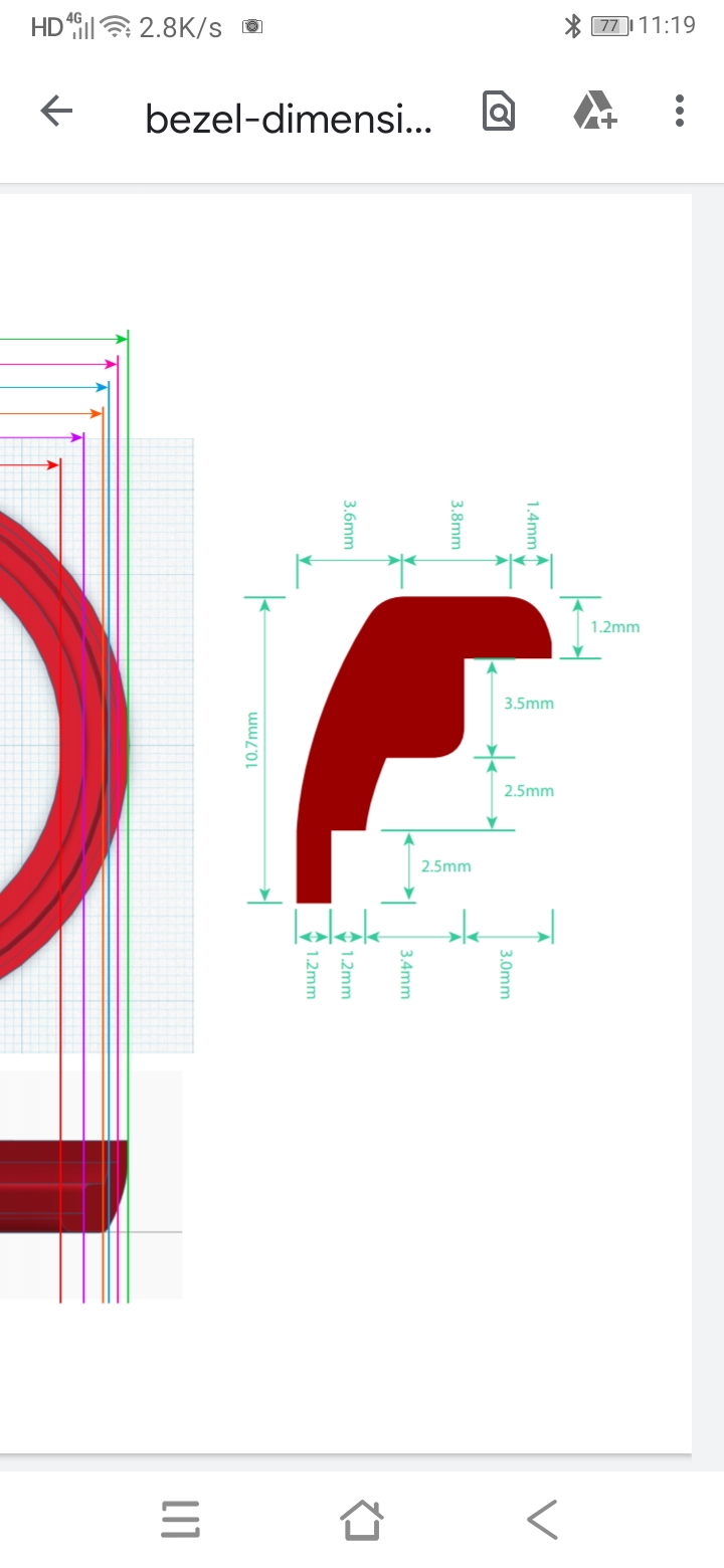

  14. I've done it. It's all glued up so I cut away the white flange underneath which holds the black bezel with a Dremel and a thin carbide grinder. Prise out the glass and replace. Put bezel back in the same place and fill with epoxy glue can't be seen at all afterwards. Someone said you can cut between the bezel and the body with a scalpel but that didn't work for me. It probably depends how well the bezel is glued in the first place.
    Anyway, here are the bezel dimensions if you need them. 2020_12_09_11.19.40.jpg 2020_12_09_11.19.29.jpg

  15. I didn't do the drawing or the 3d printing. Can't take credit for that. The chap who did let me have the drawing though. I managed to save the original bezel on mine.
