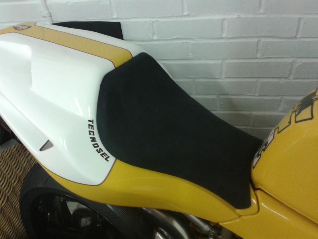

  14. Seat now retrimmed in alcantara . 40 notes all in locally !
