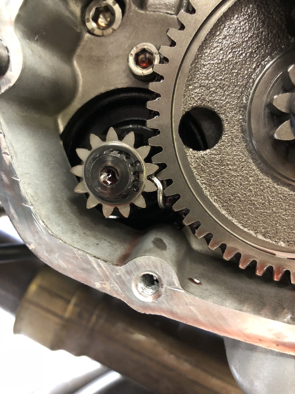

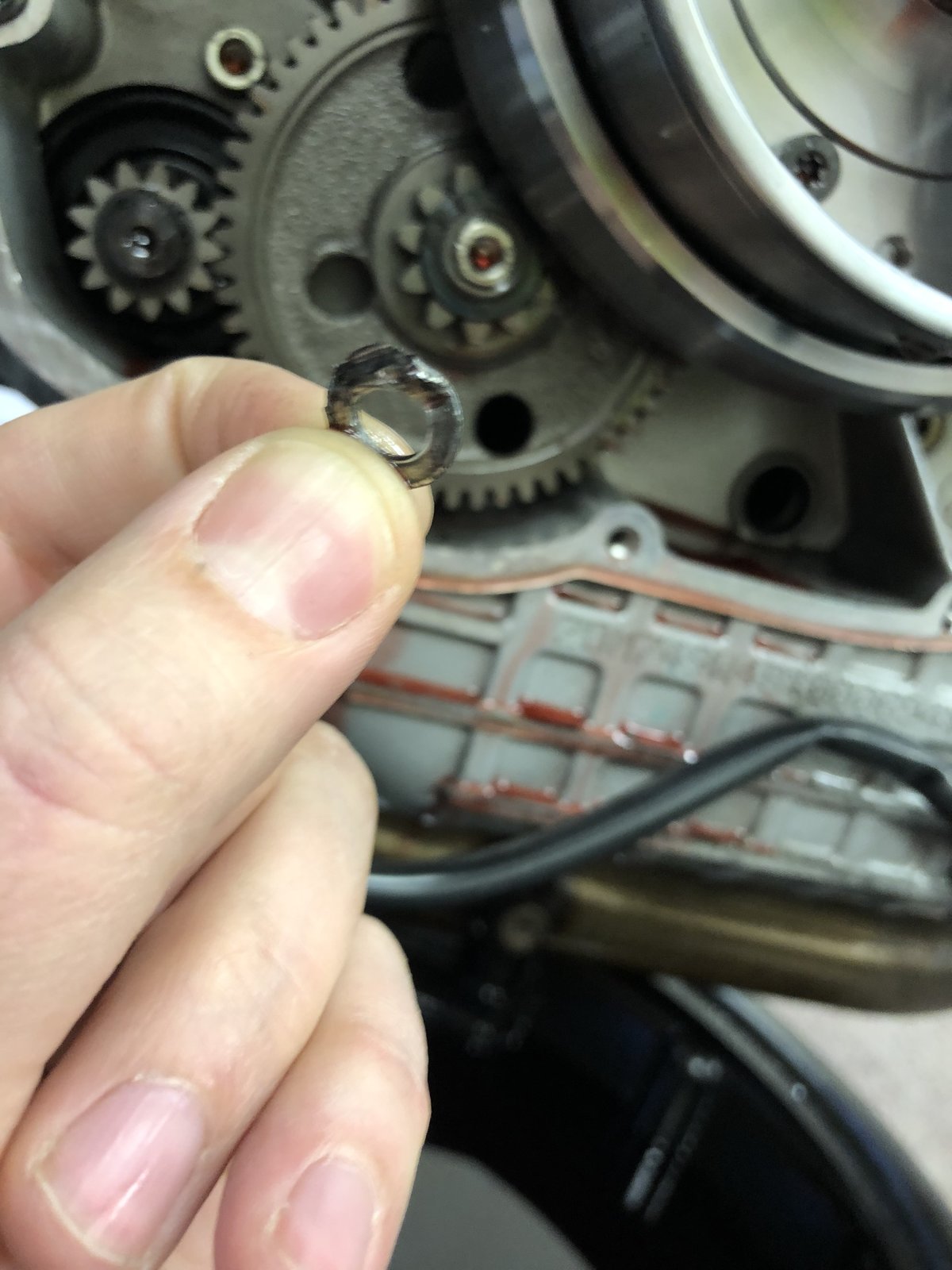

  12. I finally had time today to remove the left side engine cover and the problem was immediately apparent. Problem is, that washer probably has a fellow screw somwhere. I can’t really see how it could come from inside the engine though since the opening from the center of the engine for oil to flow through to the flywheel side, is small and the sump is deeper on the inside which would require the m6 washer to float.

  13. :eek: o_O
  14. that'll do it....
  15. Bloody hell! I came on here looking for some advice as my 749 has today done exactly the same thing (fuel primed then just a click - assumed starter was stuck!). I really hope this hasn't happened to mine too!
  16. In my case, I can’t seem to find any other solution other than that washer being ”forgotten” in there when previous owner was solving other issue. In that case, removing a washer is cheap and I will rather do that than swopping the starter.
  17. I would check that the jammed washer has not bent the starter main shaft
  18. I have. It had’nt.
