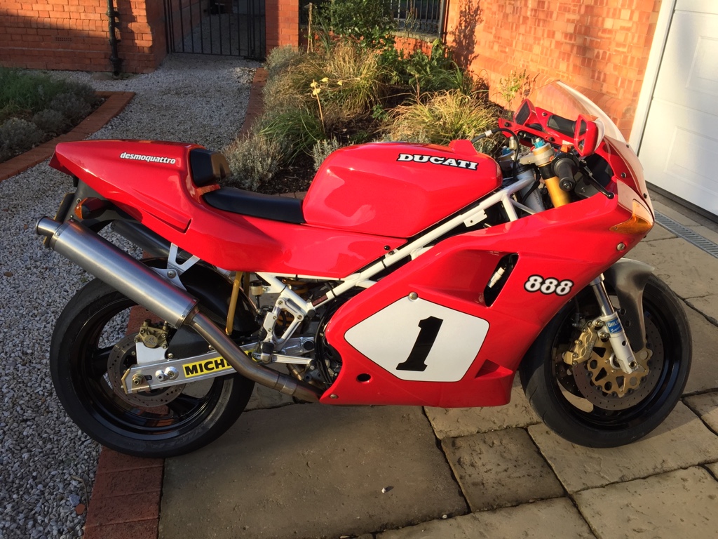

  7. Ducati 888.jpg Just out of interest,
    In lieu of the 851 888 Forum returning, this gives a rough idea of owners on here presently:
