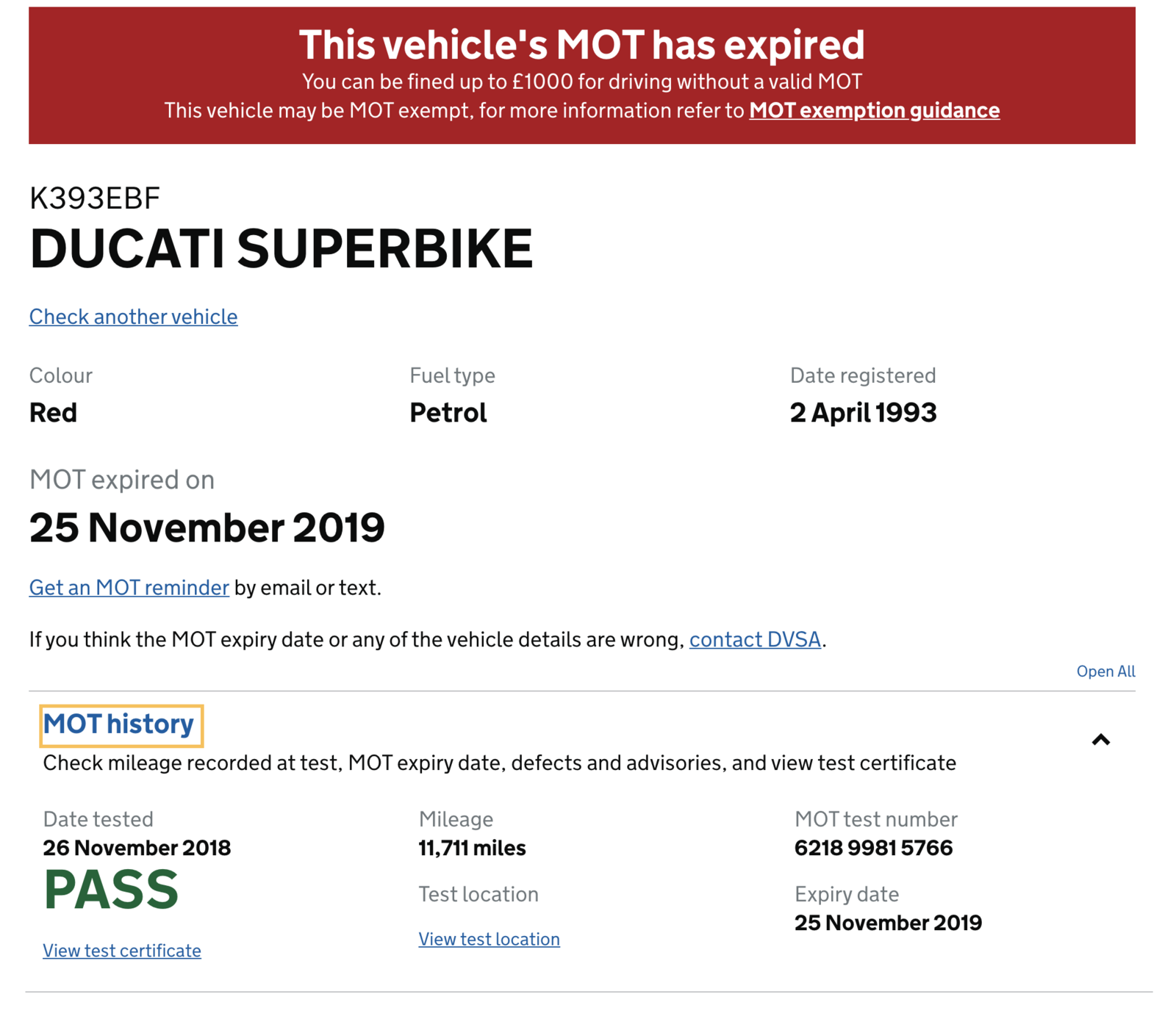

    It's got no current MOT and only one recorded past MOT. Wonder why... laid up for a long time?
  3. Let's hope so for that stupid price tag.
