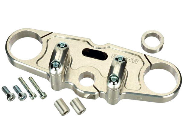

  1. Hello,
    Has anyone fitted handlebar / clip on raisers on an 851 strada? Standard Marzocchi forks. Lovely bikes but the ride is a killer after 20 minutes, my middle aged shoulders aren't happy. On full steering lock the OEM clip ons leave very little space with fairing so I can't see how raised clip ons may fit but maybe I wrong.
    Any advice welcome!
    Cheers.
  2. Thanks Chris. These replace the clip ons with a handlebar?
    Also, a note on their website says 'Cuts need to be made to the fairing and screen with this particular kit'. Not sure if we want that...
    I came across the below but I am unsure how the can be raised given there is no clearance with screen fairing at full lock:
    https://www.probrake.de/Clip-on-handlebars-REVO-Tour-for-Ducati-851-S-88-90-851
    Cheers.
  3. you are right, there isn't really room to increase height much without altering the fairing, I missed that note but I know people who have done it successfully without cutting the fairing but the increase wasn't really worth it!
  4. I think the only solution is doing push ups for a week before we go for a ride on the 851...
  5. Different bike i know ,but Gilles Variobars transformed my 916 from an instrument of torture to a thing of long distance comfort.
