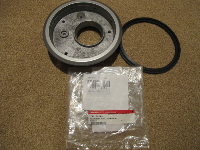

  1. Any Ideas on how to replace the fuel cap surround flange to tank seal???
    I bought a new seal as mine was perished, and had the tank resprayed. The new seal is approximately 20% smaller than the original seal, part no has been confirmed correct.
    Thanks
    K:upyeah:
  2. warm it up in hot water see if it is more pliable and stretches
  3. The part number is correct.........but check to see if there is an earlier filler cap, maybe?
    I know they can be a b*****d to fit, which is why I haven't attempted it.....yet. Perhaps WD40 or a silicone lubricant can be used.
    It appears there is also supposed to be a large O-ring in there somewhere as well.....Part No.886 4011 1A
  4. As AL says there should be a big green O-ring that goes on under the neck ring. They are a complete PIA to fit but as they are supposed to stop water getting in its kind of understandable, oh I've done this twice with a third looming.
    So I warmed up the black ring, then liberally applied red grease to the inside of ring and then eased up the filler neck. Then I applied more red grease to the green o-ring and rolled it up the neck to where it locates.
    Put the whole assembly into the opening in the tank, and push filler neck down firmly. As the edge of the top black ring come in contact with the top of the tank the ring should start to flare out. Keep pushing the neck down flip out any part of the top ring that gets caught. I used my thumb nail, but anything thin that won't scratch the paint will do.

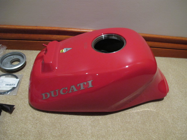

  17. New paint, with OEM decals. Ready for the new bits to be installed:upyeah:
  18. Wrong red............:eek:
    Well, it is in that photo, anyway.......;)
  19. Definitely perfectly matched to the original paint... LED lighting doesn't show it correctly, will post a pic in daylight when im done:upyeah:
