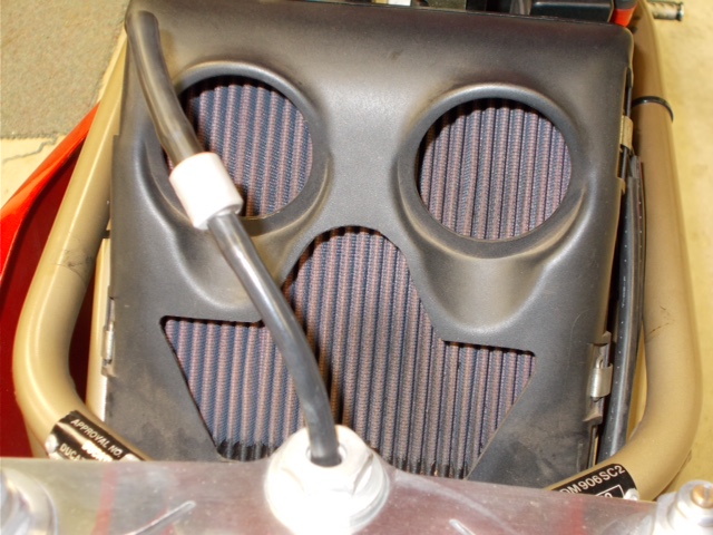

    So, firstly let us see a pic of the exhaust cans fitted to your as they are now so we can see if they are OEM; plus take a pic of the top of your airbox and post that as well.

  6. The bike was set up by Ducati Adelaide with the 41mm fcr's and 944cc kit(I have a book of receipts with the bike) and the Airbox has a triangular section removed where the snorkels were and a K+N air filter fitted. The silencers are marked Ducati with the code ZDM-AO4 on the top face and "Lafranconi" 573.1.004.2c on the inside face(R/hand side). I did drill out the three pop rivets on this can but I couldn't easily pull the rear outlet off so I re-riveted it back in place. Other than this all being loud I'm very happy, it's just that I don't think I'll be able to get this passed for rego. Mind you just about every Harley has straight throughs on so it , so this isn't that bad!!

    I reckon you need to get more pics up on this forum, because I wonder exactly what bike you have there.

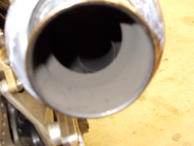

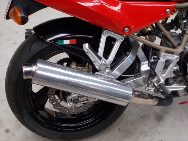

  11. I checked the exhaust can numbers on Stein dinse and they are std cans for that model. I'm sure they have been part gutted though. Some photo's! DSCN1969.JPG DSCN1973.JPG DSCN1971.JPG
  12. They have had the rear return section removed so acting as straight through essentially unbaffled pipes. Combined with the carbs and open airbox I'm not surprised it is loud!
