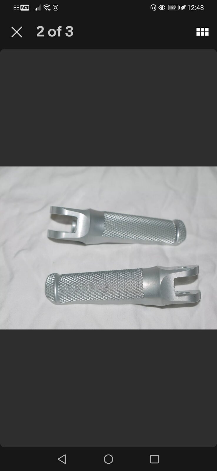

  1. Afternoon, new to the world of ducati and been slowly doing my 899 panigale up over winter.
    Many change the front footpegs for rizoma or other makes as they perform much better especially in the wet.
    My question is i have a guy who is willing to sell me his oem 959 front footpegs as he has gone fully adjustable.
    Will these fit using the standard 899 pin and holes etc - like for like.
    I like the style of them and grip is way better than mine.
    If someone could give me some light on this otherwise i don't want to say yes and then need spacers etc.
    Picture attached
    Many Thanks
    Andy
  2. Yep, the same. :upyeah:
  3. Yep, same
  4. Yep. Good upgrade as well. The stock 899 pegs are slippery
  5. Thanks everyone I'll go that route.
  6. For Info. 899 & 1199 bits are directly inter changeable. 959 & 1299 mechanical bits are also useable except for the body work/ panels. EG Nose Cone/ Side Panel and seat are different between an 899/1199 and an 959/1299.
  7. Thanks matey good to know
