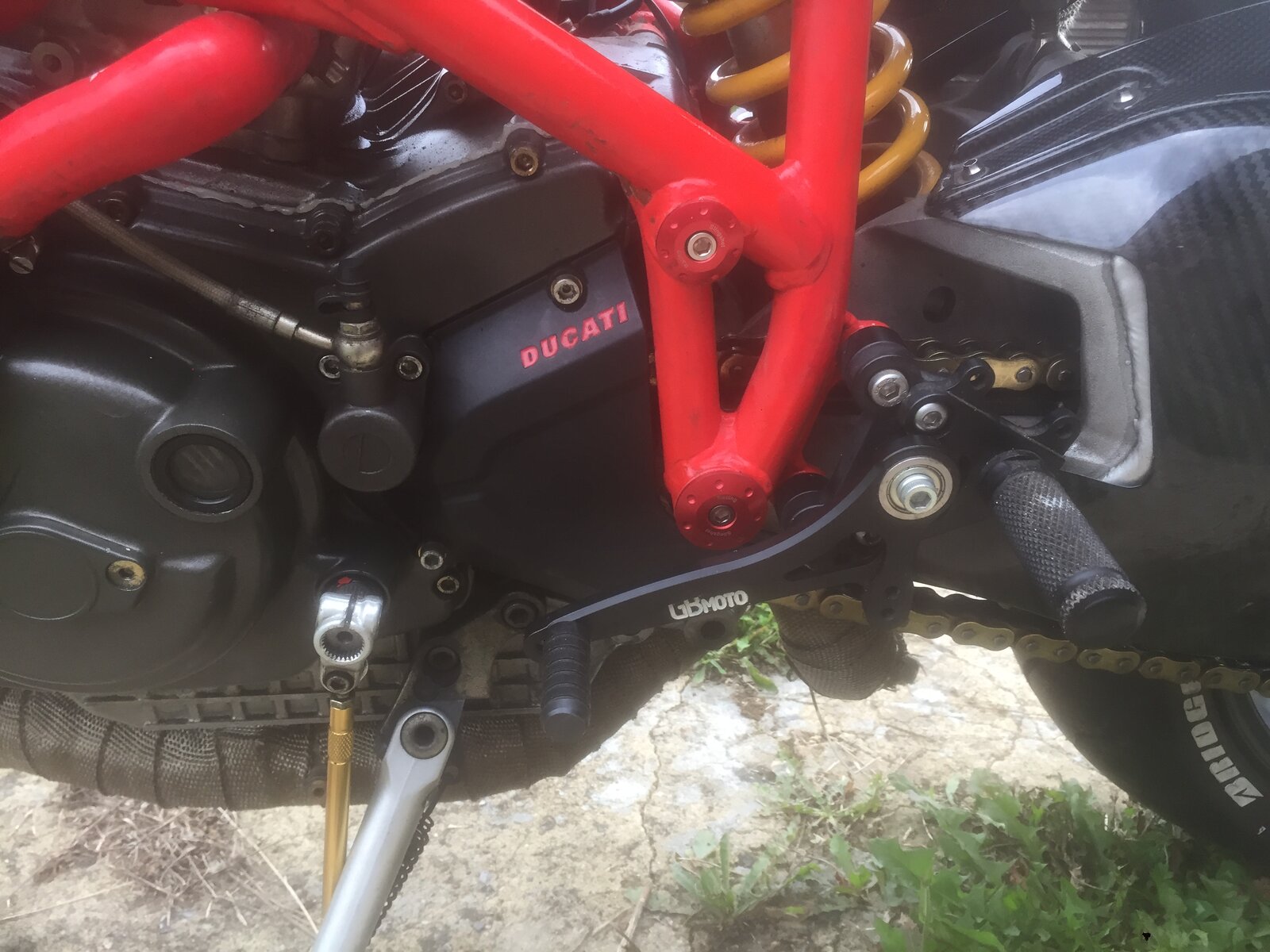

  2. i thought today i would change the race shift back to road shift! i dont trust the mot guy with 1 up and five down.....
    as you see ive put the fairings on, i still need to sort a few small details like getting the sodding thing running but it gives an overveiw of what she looks like assembled!

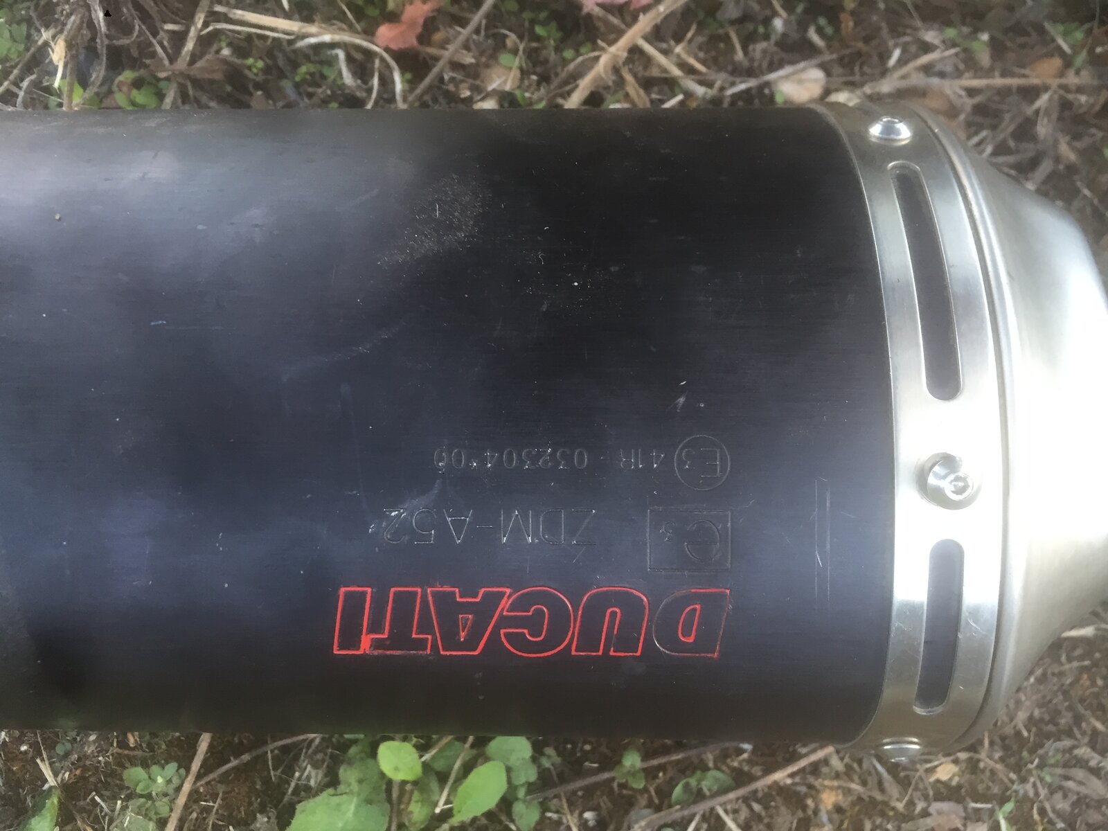

    the exhaust cans have been debaffled and will go on once the mot is out the way!

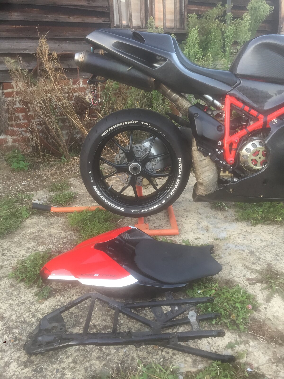

    the carbon 1098s rear end is ready for a small winter project, i think it will look good and update the tail!

  5. the detailing on the 848 sprocket cover. not much i know but i like it! IMG_0768.JPG

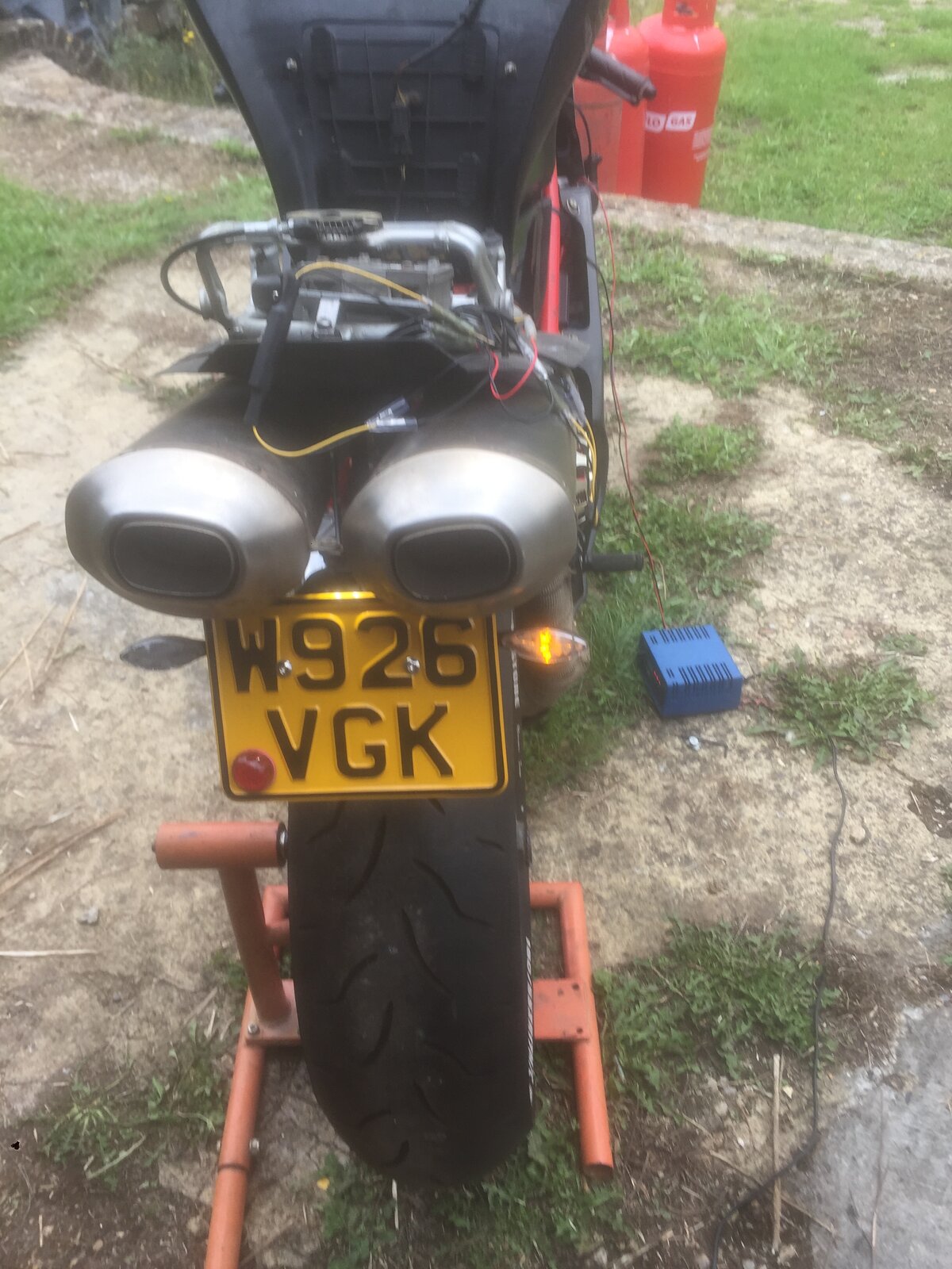

  6. well today has been productive!

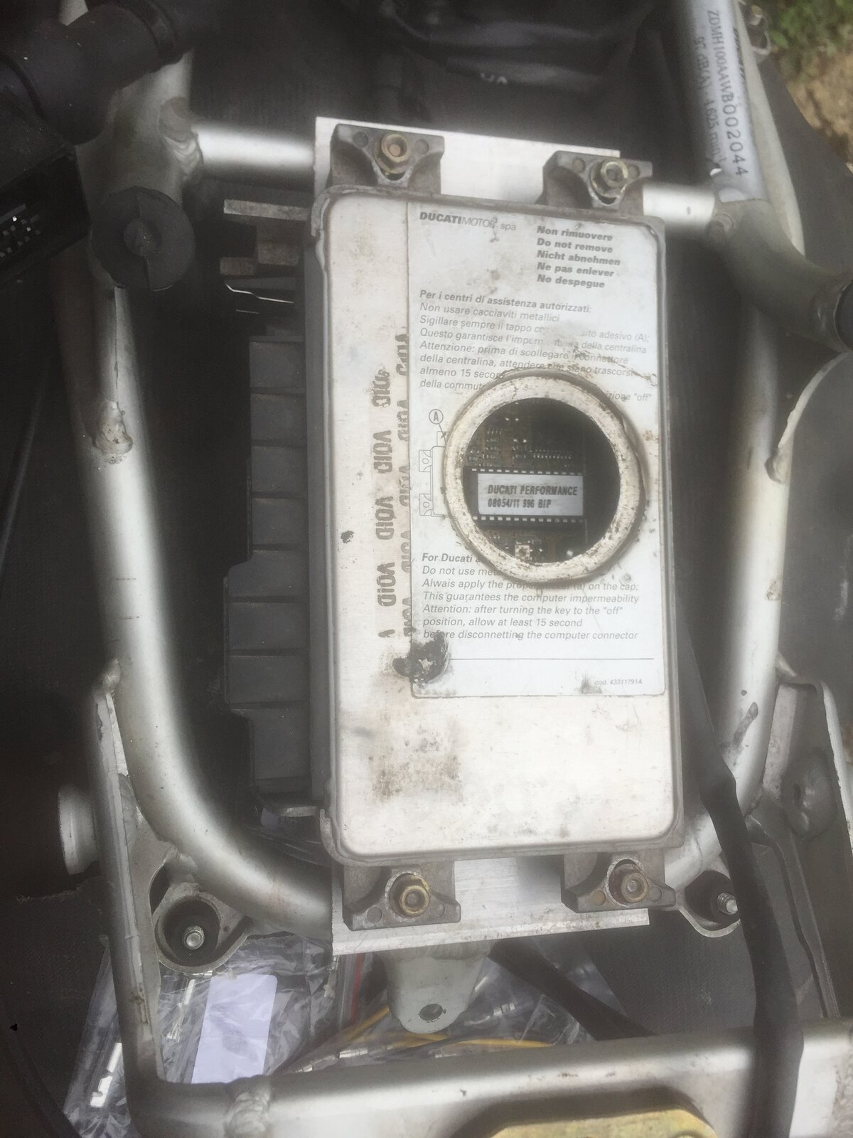

    ive made a custom hanger for the 1.6m ecu to hang on the 996r rear subframe, wired in the lights hung the numberplate
    attached the gear selector lever. and the one i like best......turning a set of oem 1198 cans into de cat strait through race cans! ive got photos but for tonight cant be arced to upload them all.
    the cans have been rubbed back to get rid of that stupid brushed steel paint effect! i think they will look really cool once on the the bike and will most likely turn me deaf! (but i will look and sound good so who cares)

  7. today was spent polishing the spare exhaust cans! (i have pics for tomorrow) instead of the black brush finish i have stainless cans that have a small amount of black in the brush finish, they flip tone in the sun and sometimes they look silver and sometimes black! (100% fluke)

    i need an ecu 1.6m twin injector to set up the fuel system! she starts and runs but i cant adjust the fuel supply from the ecu and the slightest amount of throttle and she pops and stalls!!! hmmmffffffff
