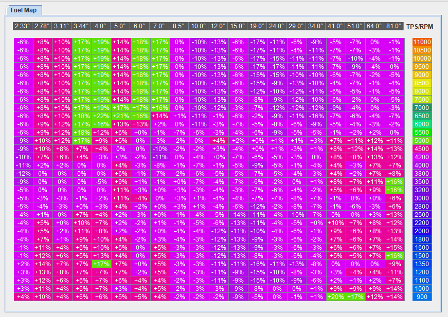

  13. Not one to give up, I used the old ECM tool in order to compare both maps :)

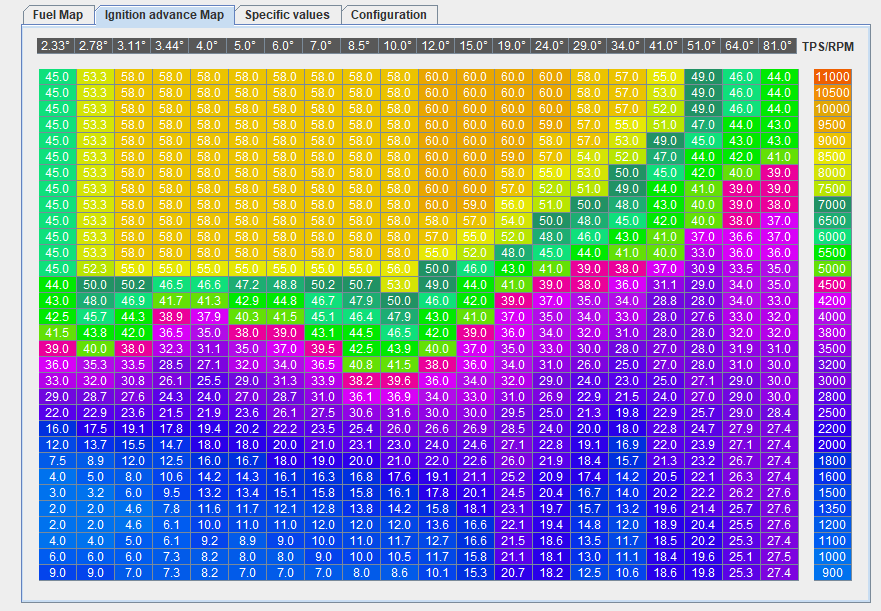

    Here's the percentage change on fueling based on the TPS value vs RPM. These results would suggest OEM 999S map runs a tad rich and the DP 999S map leans it out a bit.
    These are the ignition advance changes on the 999S DP MAP:
