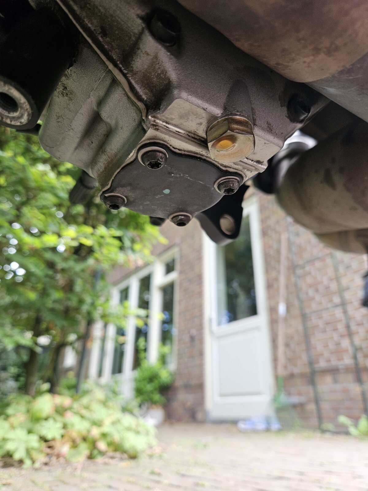

  1. After having multiple problems with Ducati Amsterdam, I have instead changed to Ducati Hippo (Noord-Holland) to get new TPS sensors fitted to my wheels and fix a threaded sump. Both fixed, maybe I've found a decent dealership! Nope...

  9. Well... The sump is still leaking anyway... I'm going down the legal route now. I'm done with these fucking clowns. Does anyone have any contacts for the corporate side of Ducati for me to kick off this inevitable ball ache?
  10. That's an interesting sump plug.
  11. The OEM was threaded (the casing side) and this is the repair they attempted. I assume they did what I was going to do and use a threaded insert with a basic bolt to cap it off. But despite them saying they checked after fixing it, it's clearly not holding oil. Truly, I feel stuck with this bike now, everytime it goes to ducati, it comes back worse and it's no longer rideable.

  12. A normal hex head bolt will never seal well as a sump plug, it needs an integral washer to compress the sealing washer evenly.
    Especially in this sort of application where the different metals are heating up and expanding at different rates.
    If that washer and Bolt are one piece, then it looks like no sealing washer is fitted.
  13. I think it's a separate washer, possibly a Dowty washer would work if the oil isn't coming around the insert repairs.
    Or the sump hasn't been cracked due to overtightening
  14. Standard Ducati dealers - again - why is this not a surprise!! I'd be amazed if they know how to drill & tap anything, never mind the understanding of materials selection to choose a compressible, or other, sealing washer...

  18. Did they cross thread the sump bolt?
  19. I believe I did, I did an oil change post a small tour which was shortly after a desmo service done by Amsterdam (where the camshaft leak came from). It simply didn't torque but kept turning. The reason I believe I did was the same torque wrench snapped a bolt at a much lower value previously and I hadn't calibrated between the uses. Sort of shot my self in the foot there.
    I'm not overly pissed at the job, it's the lie it was checked etc. I'll try a proper crush washer on it tomorrow and go for a ride and hopefully that'll solve it.
