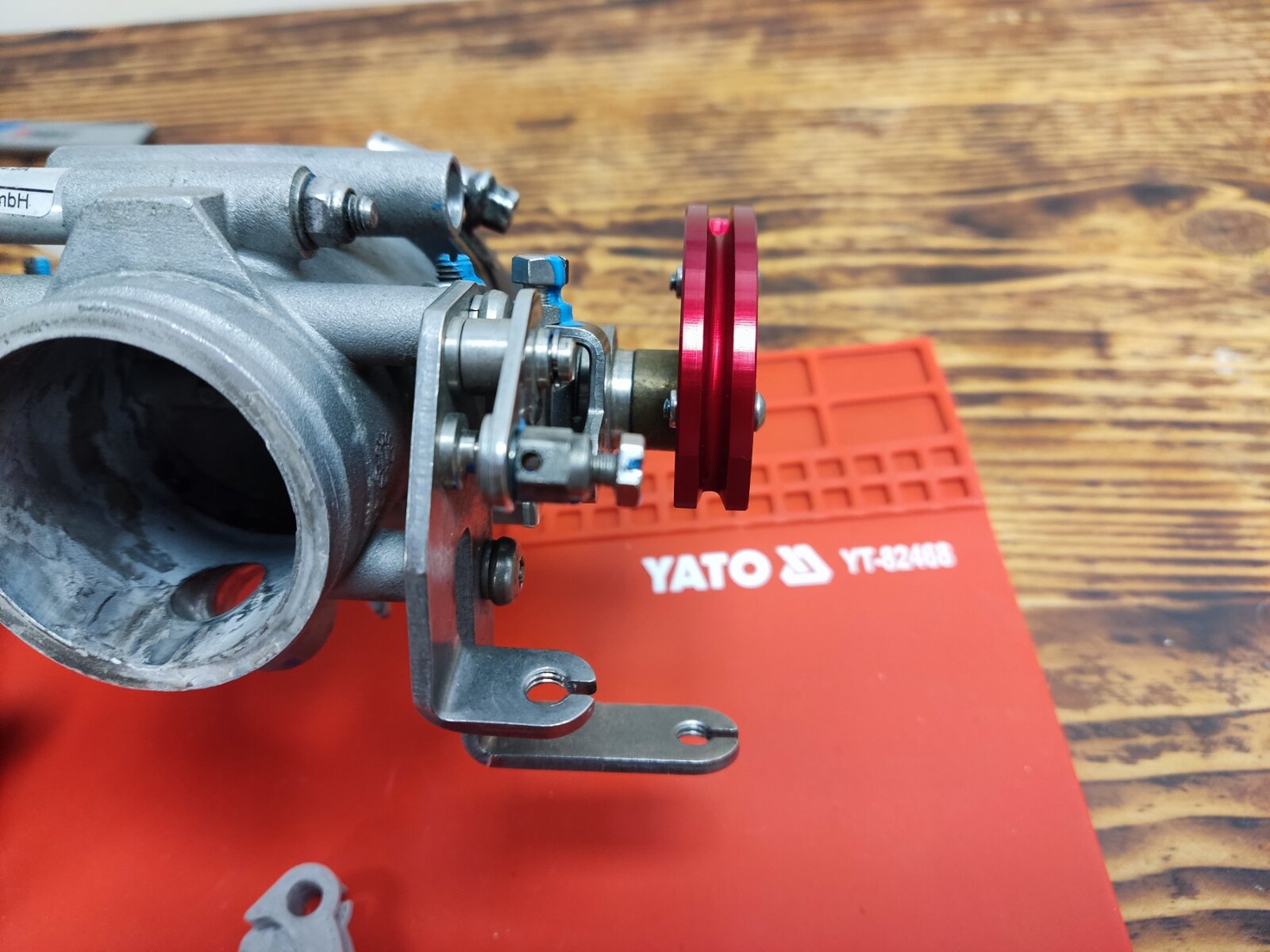

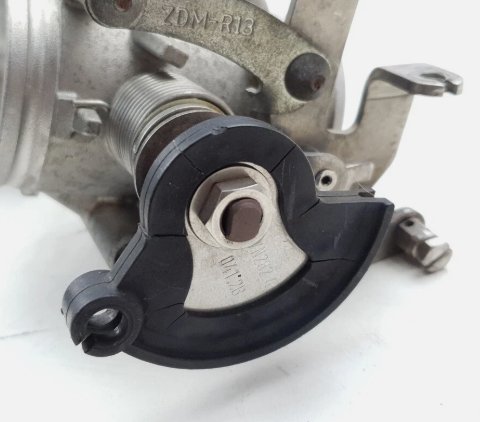

    I know there are already some aftermarket solutions for the plastic throttle pulley issue on Ducati Hypermotard and Monster models.
    Most of them replace the whole part or use printed composites — but my goal was a little different.

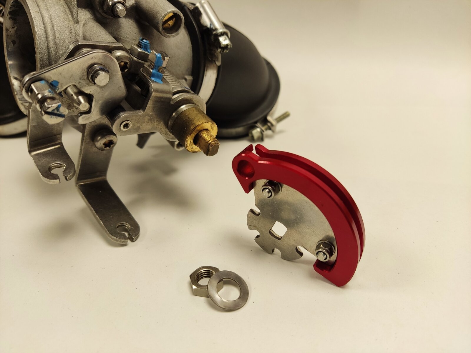

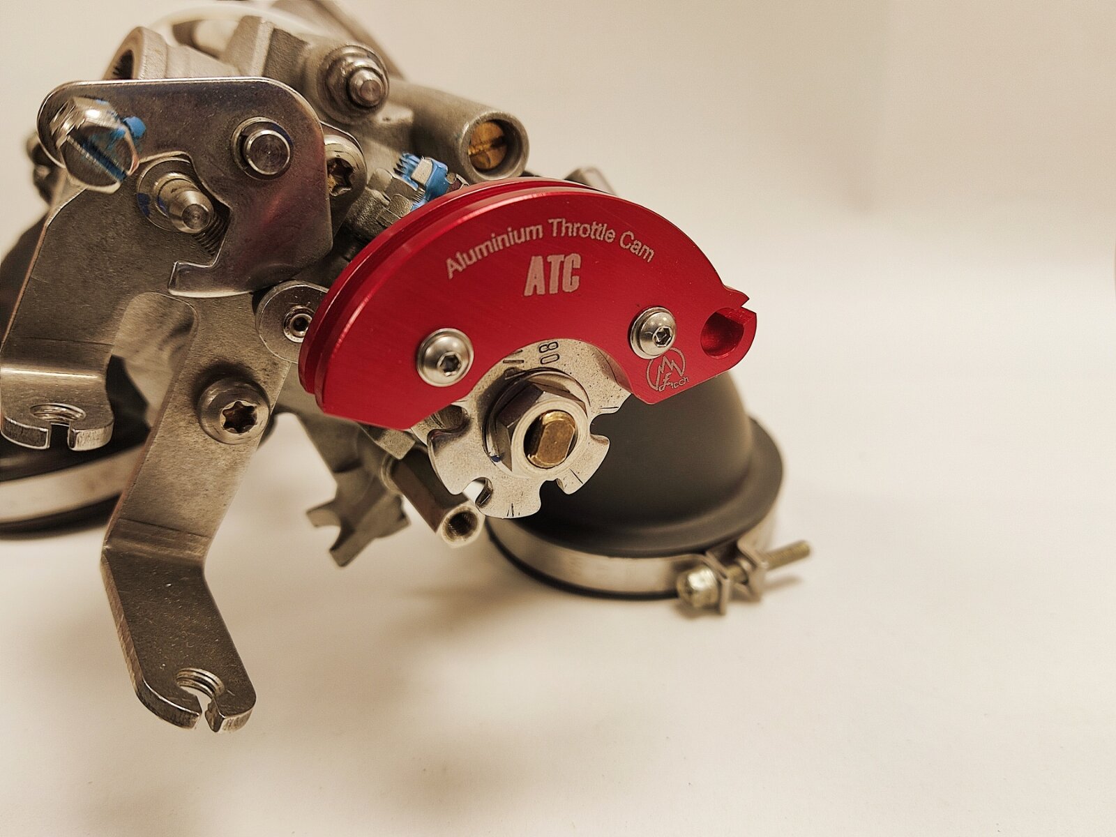

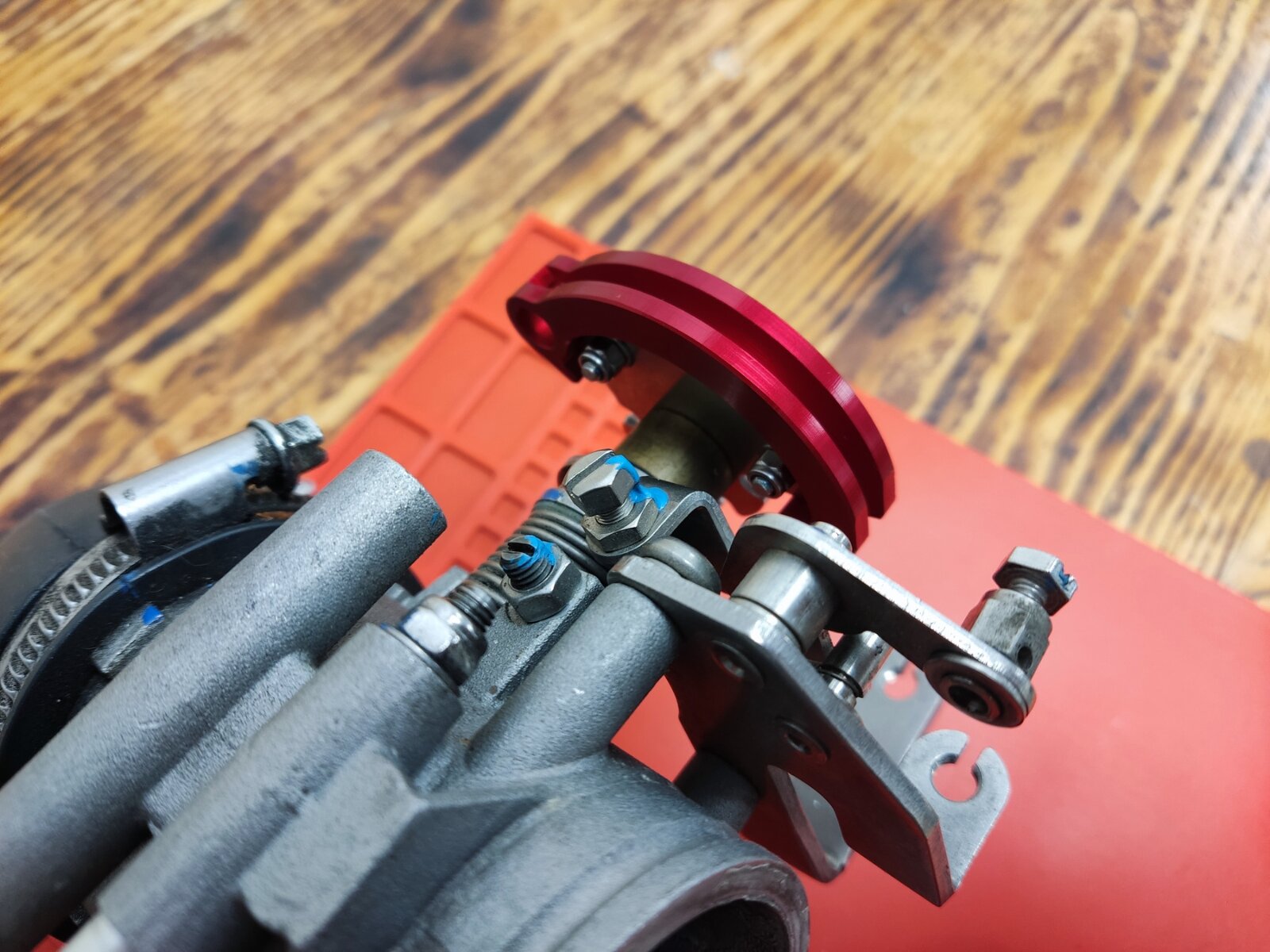

    I wanted to keep the original design and the stainless-steel plate that Ducati used, while replacing only the weak plastic cam with a CNC machined aluminium one with anodic coat and red color for aestetics.
    That way, the throttle body keeps its authentic factory look, but becomes many times stronger and longer-lasting.

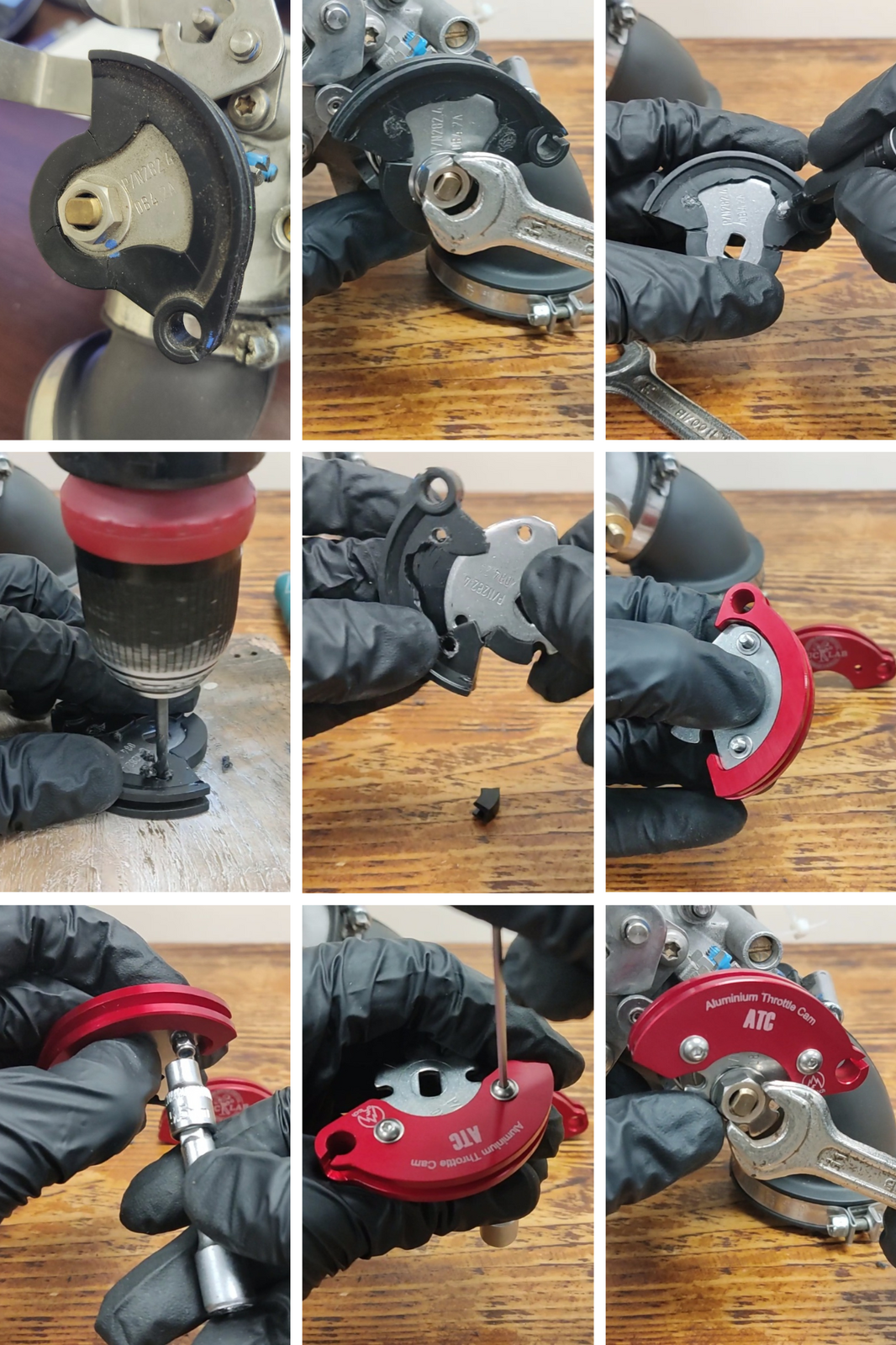

    :upyeah:No drilling or modification needed — just remove the old plastic, clean the original plate, and install the new cam with the supplied hardware.
    It’s a simple, smart, and elegant fix that feels 100% Ducati.
    :idea:A small note about one of the photos:
    You might see a picture where I use a drill press — that’s only to safely remove the remaining plastic that’s stuck in the original moulding holes of the plate.
    The metal plate itself is not drilled — it’s only a method to clear the plastic more easily and without applying force.
    You can do it by hand too, but the drill just makes it quicker and safer.
