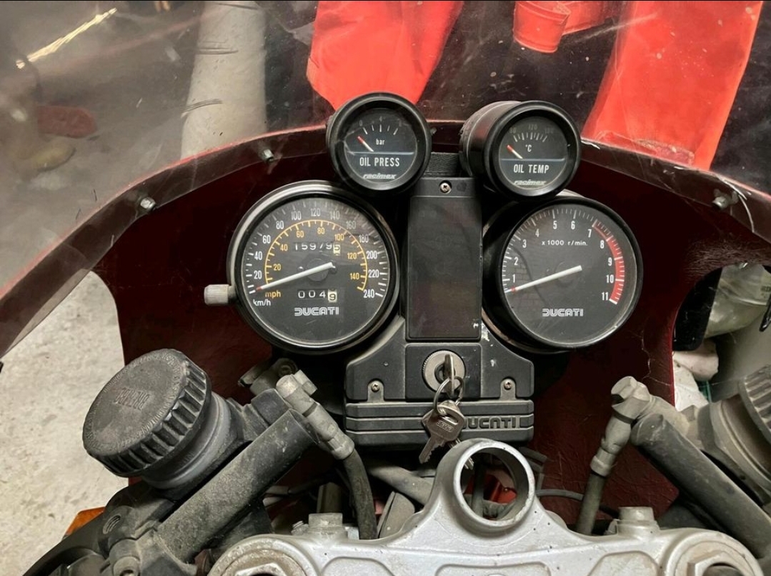

    The engine turns...no visible damage except the lower fairing which is missing and there were some "upgrades" on the front fork and on the back too (see pics).
    How would you rate this bike and the chance / costs to make her fit again? You have any tipps what to check on it before buying it?

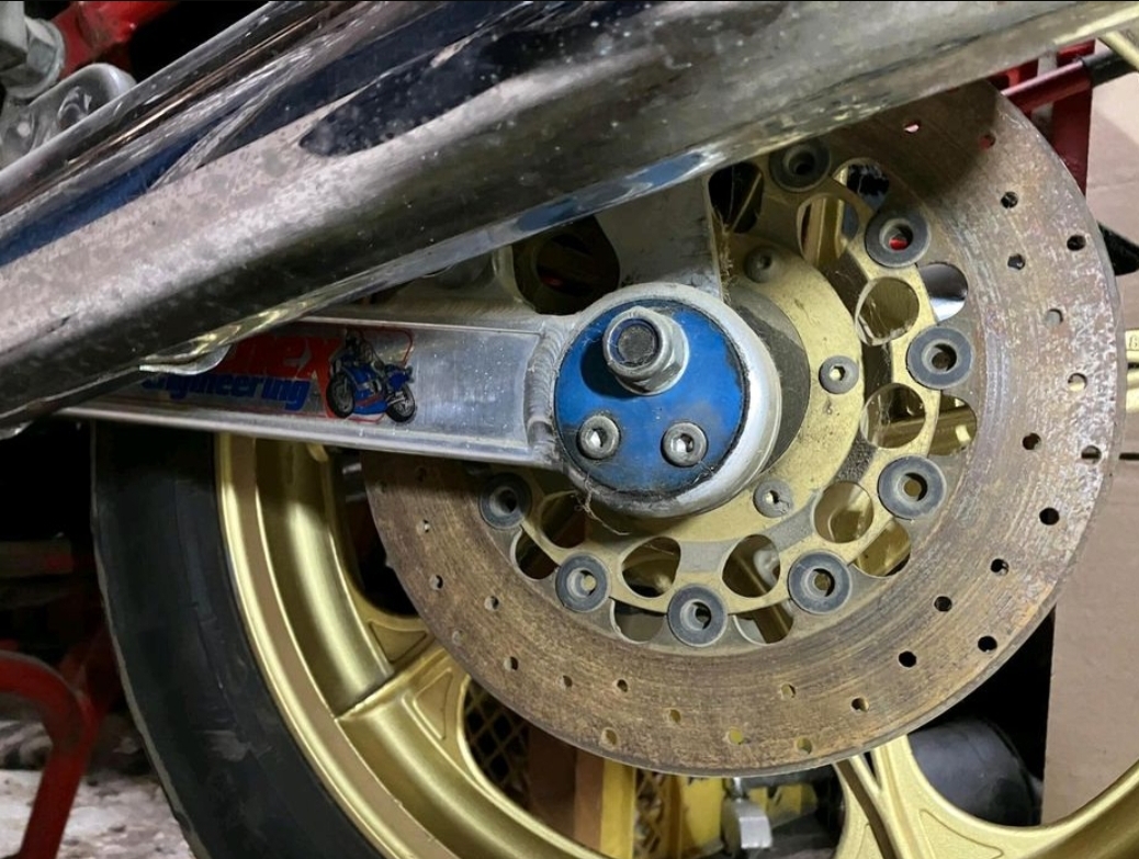

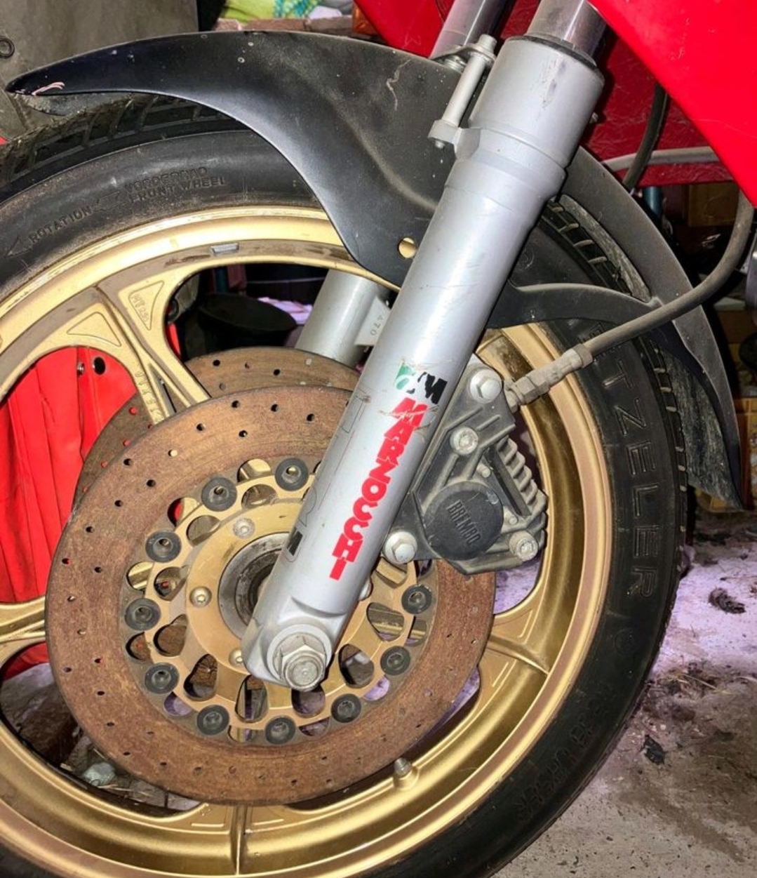

  5. Hmmm... it's had a non standard alloy swingarm fitted at some point and the floating front disks & top yolk don't look standard either.
    In Ian Fallon's Bevel Twin book there are a couple of pictures of a 1984 MHR without the fairing lowers. So perhaps the bike never came with them :thinkingface:

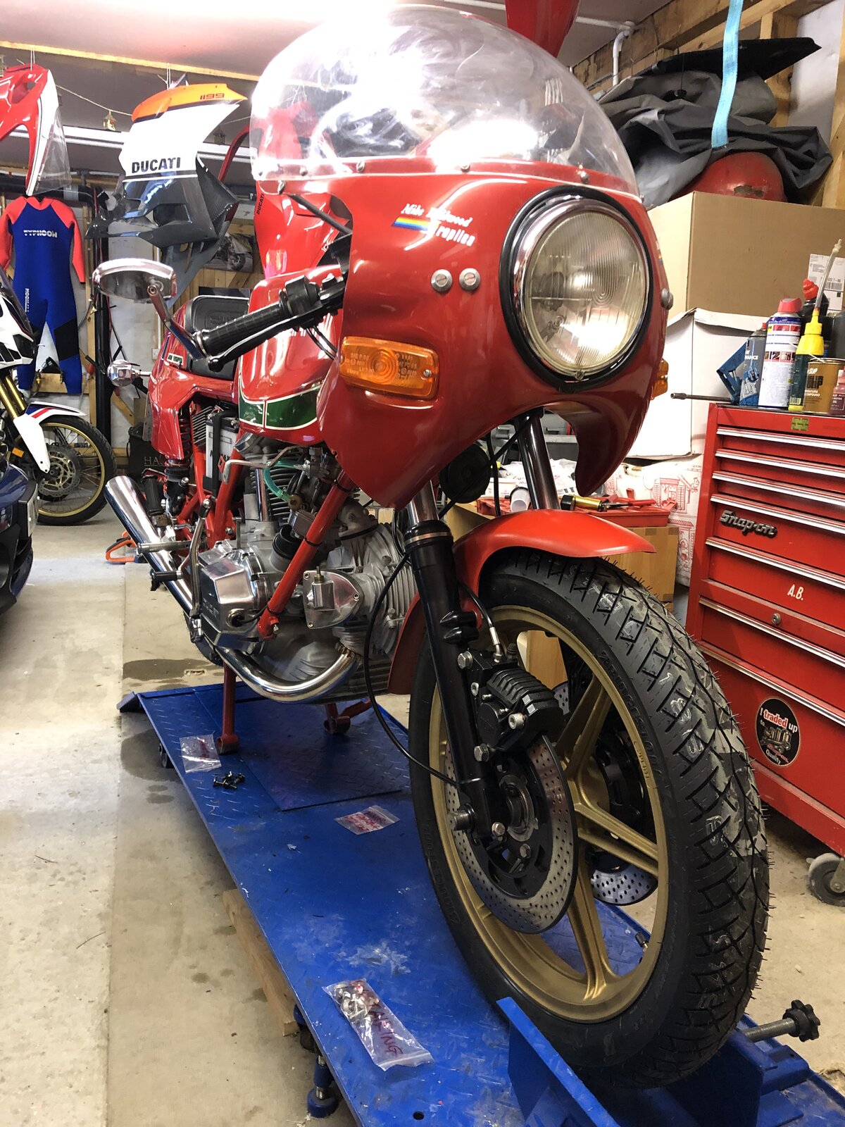

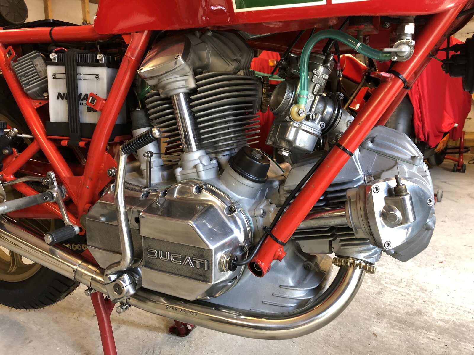

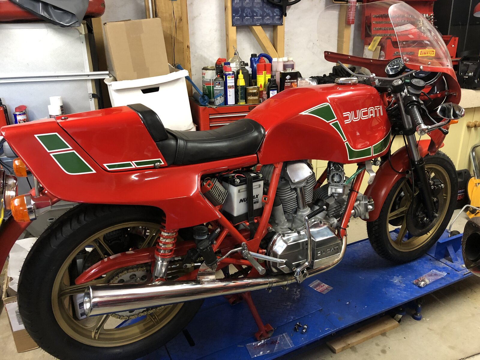

  6. I bought an ’83 a while ago and went to work replacing brake lines, painted the forks and wheels, split the engine for an inspection and clean, replaced all bearings in wheels, painted callipers, new pads, fuel lines and taps and fluids, new battery, exhaust polish, carb clean and service kit, new electronic ignition, rear shock refurb, chain, tyres, and fairing paint job.
    I did not paint the frame, tank or seat to maintain the used, but not concours look.
    Yours is in similar to maybe slightly worse condition with a strange rear axle bolt and swing arm.

    Your advantage is it looks complete, although with a strange rear axle bolt and swing arm. Maybe floating discs that seem a bit modern. Dash looks different and those gauges look like extras.

  7. The dash was standard fitment on 1984 models (the ever useful Ian Fallon) and consisted of eight leds that included an oil light & Ian goes on to say "Designed for the impending Mille the fuel & oil pressure indicators weren't connected on the 900."
    But the oil pressure & temperature gauges themselves do look to be add ons - requiring some engine plumbing I'd think :thinkingface:

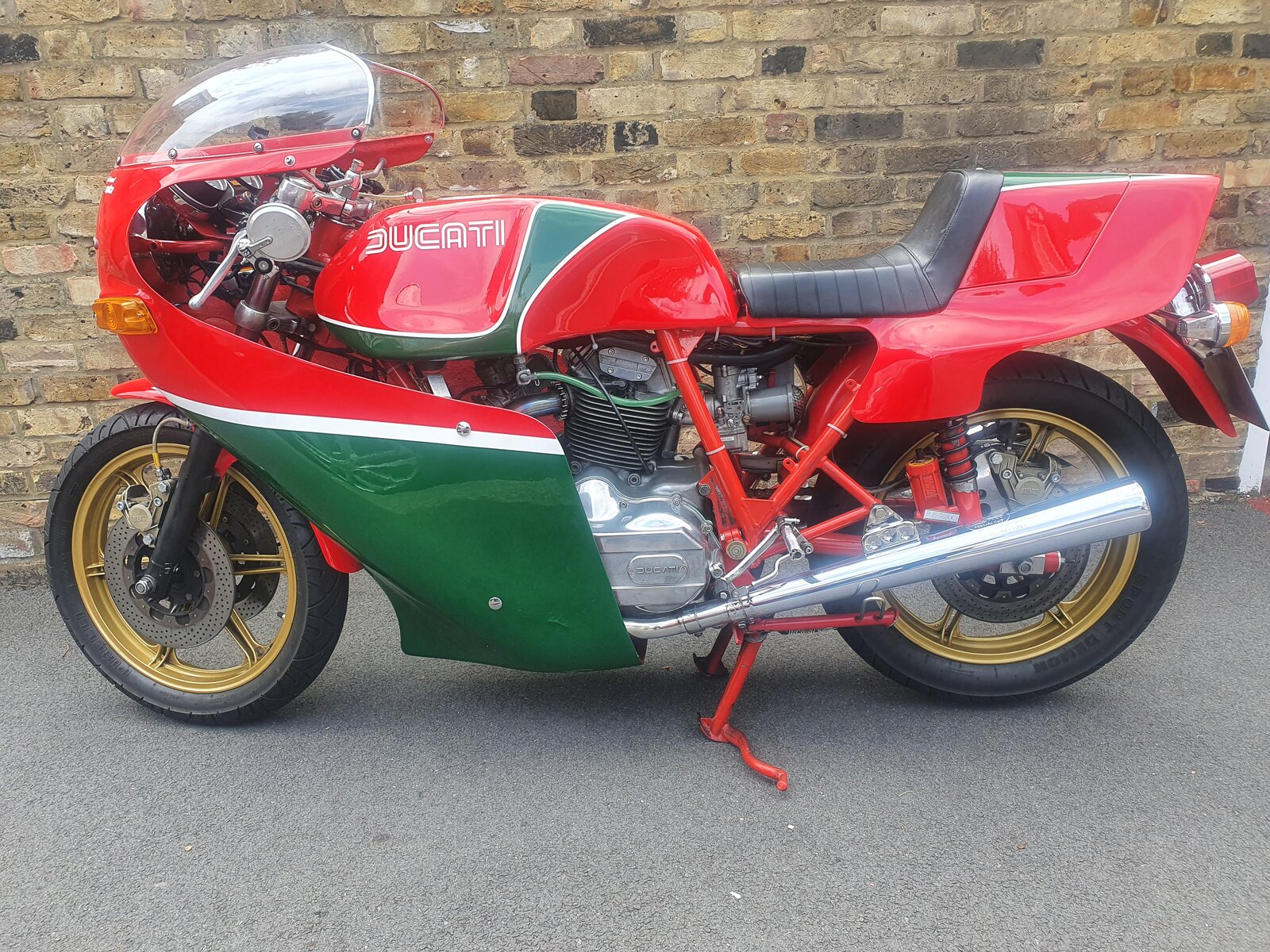

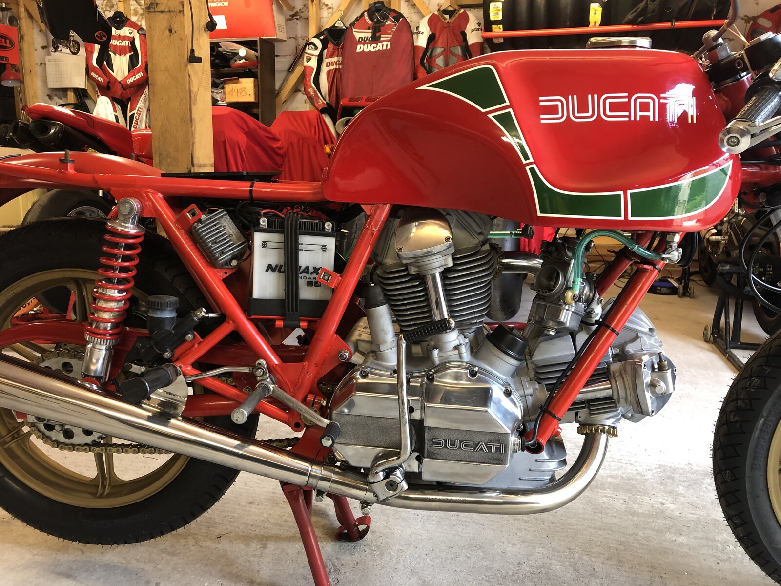

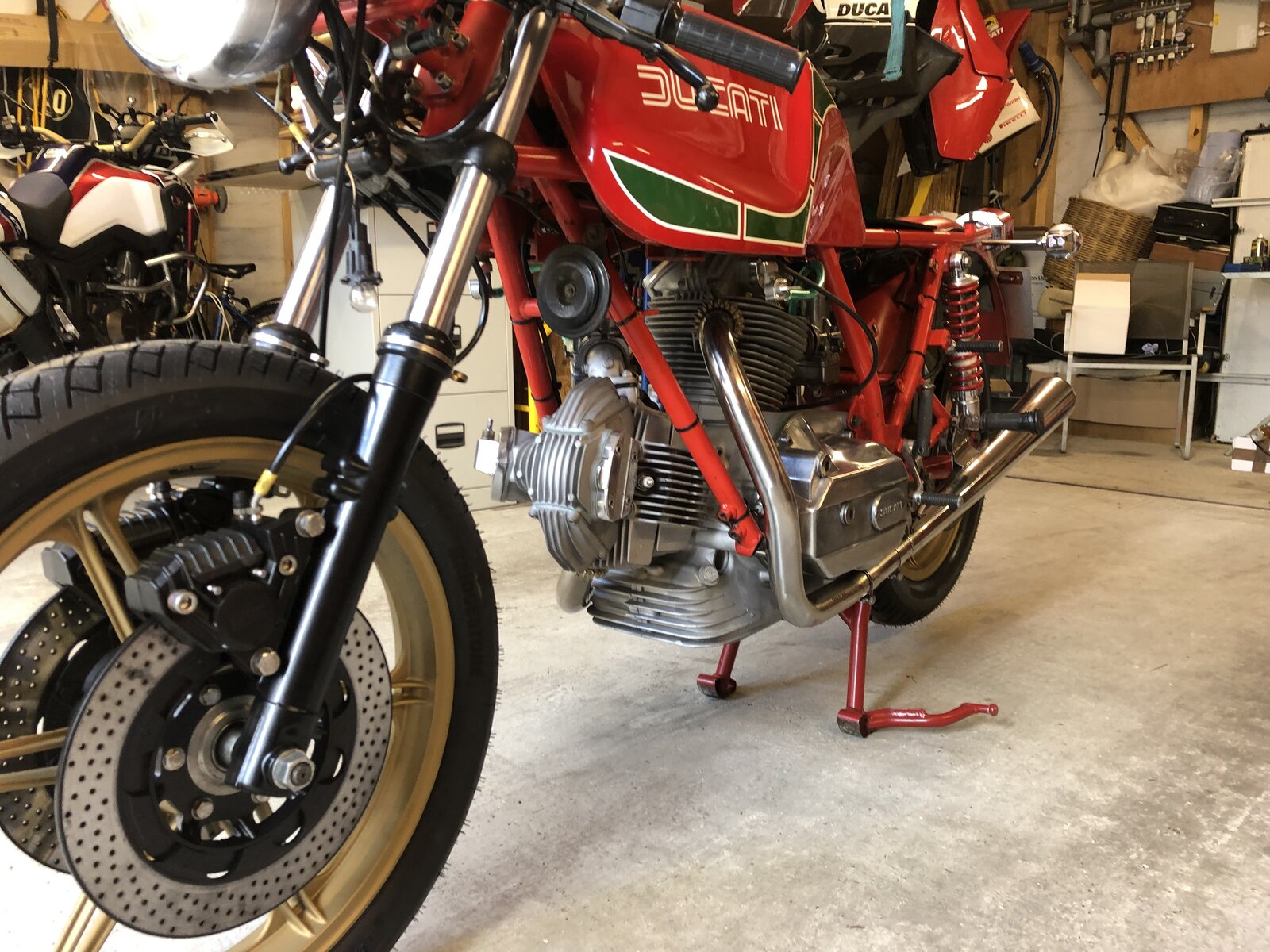

  8. And this is what you get after much toil and £$€…..
    This was my one in July 2021. After repaint and engine rebuild.
  10. Looks like a Metmachex swingarm
