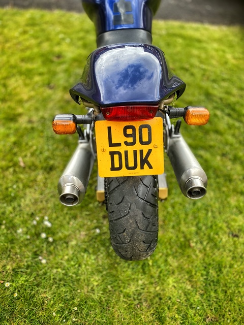

  8. My new project has arrived! It’s a 1999 M900. It has 9,000 miles on it. It was delivered by a courier from the North who I will definitely use again, he was brilliant! https://srcoupland.com/
    I bought the bike sight unseen, save for a few pictures. It’s a none runner at the moment so who knows, but I bought it on that basis. I will attempt to start it over the next few days. When it arrived it was exactly as described, and I was very happy, especially after I sprayed the whole bike with gunk a couple of times and let it soak in for a few hours. Then a good jet wash and it has come up pretty well! It spins over OK, and I have checked the compression and that is all good.
    Not sure what I will do with this one yet… it’s almost too good as it is for a full restoration, so I will get it running and then make a decision from there. It also has an interesting registration number that will appeal I guess to someone with say a new Ducati V4 as that is still an L 90 degree configuration!
    Once I decide what I am doing, I will probably start a new thread…
