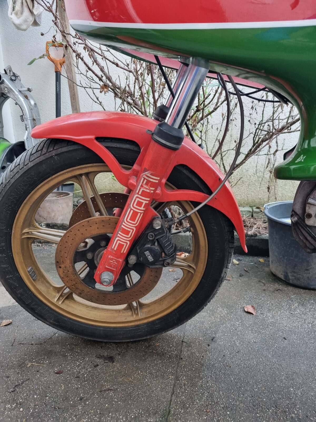

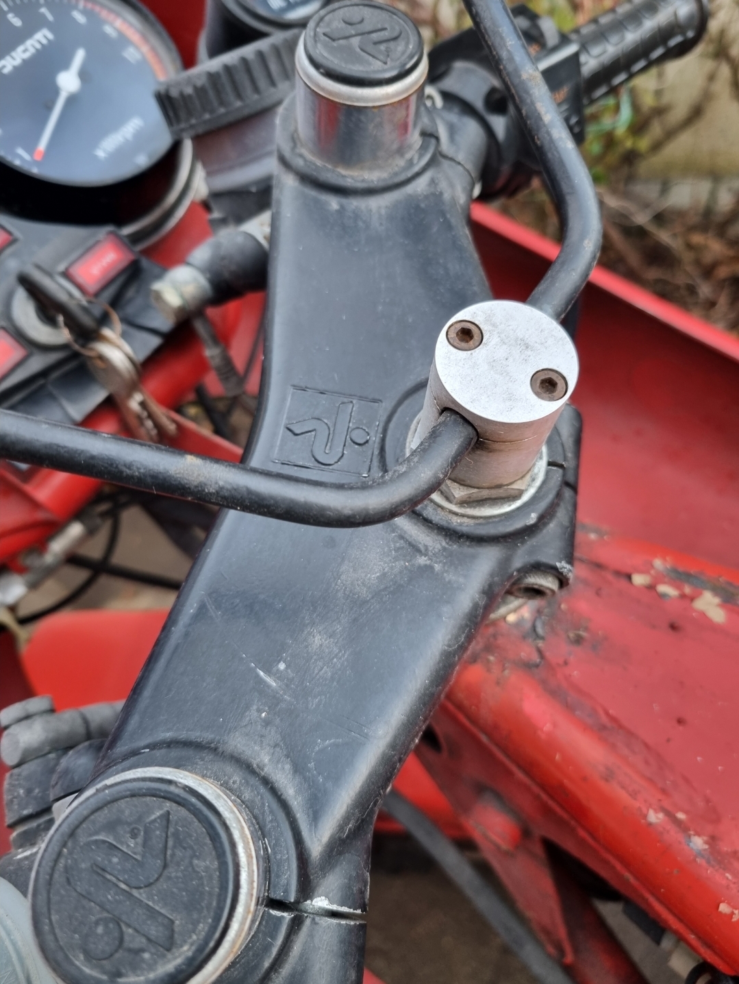

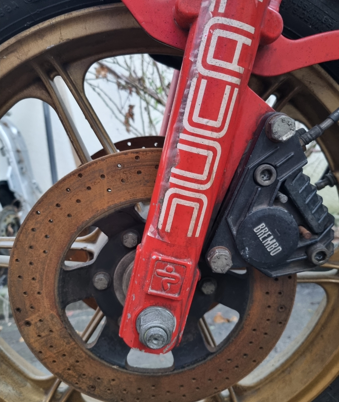

    1.fork: I have red Paioli forks on my Pantah 600 sl and not the usual black ones. I saw in the parts catalogue that there were the normal black forks but also Paioli forks. Someone could confirm it? Which forks were on which year models or what was the Ducati logic there?
    2. Fron fairing: I have a rare (or not original) MHR painted front fairing. I read that the MHR design was for the latest (last) 600 sl pantahs. Is my this original paint / design,...or sy knows more about it?
    Thank you for your ideas and feedbacks, comments!

    Congratulations on your acquisition.
    You do not say what year your 600SL is, but I guess 1983 or 1984. Because 1981 - 1982 models had Marzocchi forks, with Paioli fitted later.
    Why would the factory fit Paiolis? Probably because they were a bit cheaper. Or maybe because Ducati had not paid Marzocchi's bill for the previous batch.
    After 40 years, previous owners may have repainted parts in colours they chose. But most had black fork sliders back in the day.
